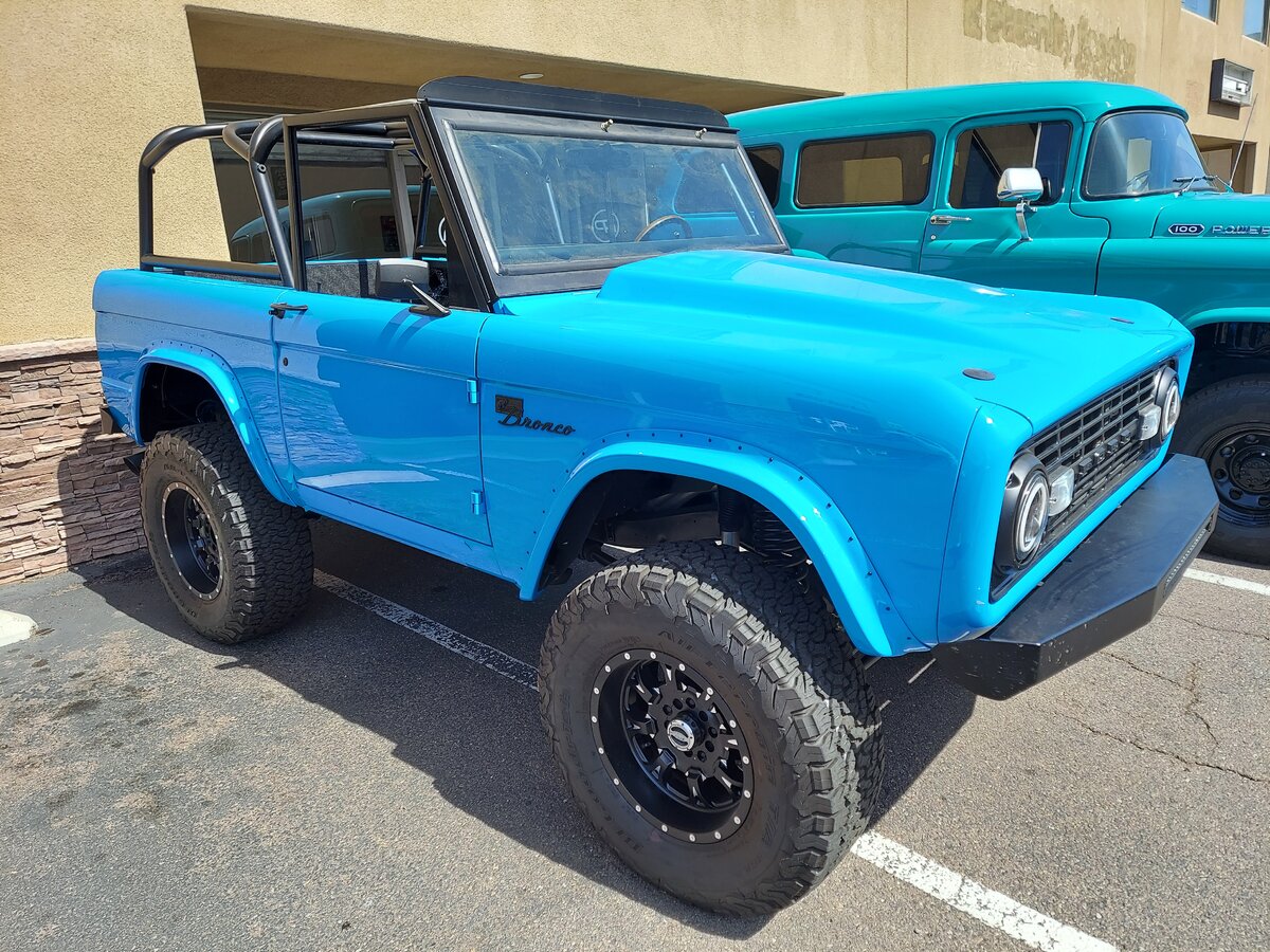

must work well at the mall! :p

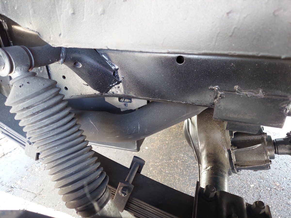

As long as they don't hit the speed bumps too hard. That's just a piece of angle welded on the outside of the frame with no support on the other side they used to lower the bump stop. Welds don't look like there is any penetration. Bronco also has a body lift, original radius arms, steering, etc.
ill rephrase... must look good off the trailer at the show! :p
