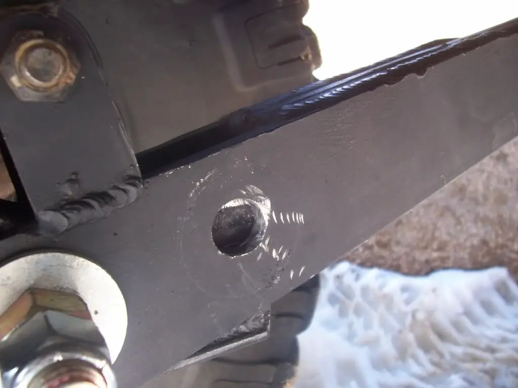

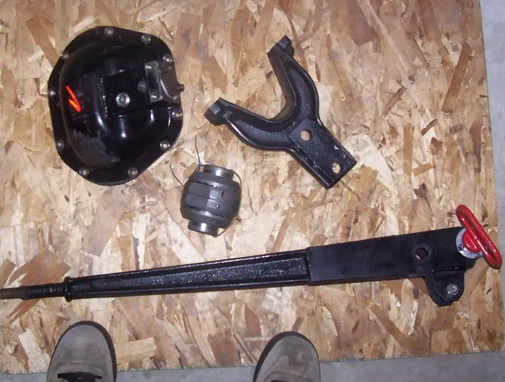

Here is mine:
Here it is in action w/ the pin pulled:

I don't think Sparksaflyin' has ever put a pin in his, and I also think Froader left the pin out all the time he owned the truck. Heck we drove the truck home from California with no pin. I can't say if it is really needed or not.
Please read my build thread in for all my build info. Do a search for threads I started. I am using a Dana 44 narrowed 6" on full height 76 f150 buckets w/ 7" springs. I do not run mine around on the road with out the pin. It is extra stress on the tubes/ center section especially when braking at high speed. That and it handles worse- body roll, slowed braking response, and the clank! Anyway, my thread does a full write up on my setup and details.
