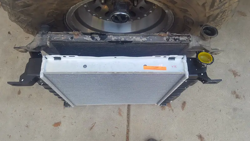

Duel core radiator showed up this weekend.
20160904_165555 by Matthew Dresselhaus, on Flickr
I also had gone to the junkyard and got a duel core fan shroud. Here you can see the difference in the single vs duel core shroud. The single measures roughly 4.5" deep and the duel is 3 inches.

Got it installed but can't bleed it till I finish my saginaw power steering pump swap.
That double core radiator will do you well. It should have been standard equipment, the single row's just don't work well. You could upgrade the fan, but once you are moving at a good pace, it wouldn't do anything. I never had a problem with the standard fans, Mine could idle or crawl all day and stay at the same temp. Maybe its different if temps get over 90. I just don't see the purpose of having a clutch that works 90% of the time. You would be better off with a solid mount IMO. My personal preference is actually for electric fans, but if you end up in deep mud or water, a solid mount metal fan from an f150 would do well.

Dual core radiator and a heavy/severe duty clutch (automatic trans application) should cure your problems. I switched my single core out for a dual after one of my Mojave Road trips and pulling the long grade out of Baker, CA. Did the trip again after that and it stayed much cooler.I have had a "supercool" fan clutch from Ford for years but I think any aftermarket HD clutch should be just about the same.
You will need a shroud from an automatic if you switch to a 2 core, they are different thicknesses.

Ran up the mountain yesterday for a day wheeling trip. I was much lighter then past trips due to no passenger and no camping gear. It was also cooler. 60 vs 75 plus it has been. But the temp guage never moved passed N all the way up. I think the larger radiator solved my problem. It will be next spring before I will be able to fully test it.

Should update this. It has been over a year with the new setup. It works awesome. Same grade as before I no longer over heat on. I put my foot to the floor at the bottom and let off on a few corners and the top and can hold 60 all the way up in 4th. But now I burn more gas going up the grade due to not having to back off the throttle anymore.
If you have a single core radiator do this change. Should have done this years ago.
