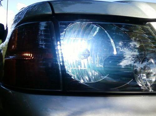

The plug with the yellow rubber grommet goes into the ballasts.
The othe rmentioned plug next to the yellow grommet plug should plug into your stock harness depending on what bulbs you have and if you ordered the correct kit
still nothing. I had it right, the way u told me to hook it up. All the bulbs are right. What am i missing. Do i need to unhook the battery while i do this or what... its starting to piss me off.
And in the picture those are the low beams. the fog lights wiring is a lil different but from what BrianDye told me i had it all hooked up right. PLEASE HELP... i hope its not the product. it took 2-wks to get here.
Do u think maybe it could be Reverse Polarity???
im just throwing options out there
fix the problem. ill post pictures once i get a chance.
