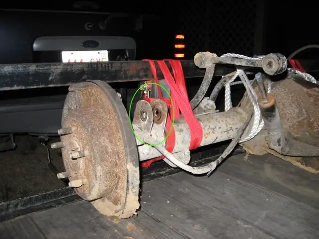

just picked up this explorer axle for my bronco 2. i have been trying to figure out what these brackets are for. they aren't on my 01 sport's rear axle, i'm stumped. they aren't in the way of anything, so i'm just going to leave them. just curious.

thats makes sense. (even though i didn't know v8's had that). i knew ford didn't put outboard shock on these, plus the rub marks look too big to be shocks. i know a guy with a v8 ex, i'll take a look at his monday. i may use the bracket for a new mount for the metal/rubber brake line transition thing (don't know the real name), i'm not fond of how the brake lines are routed. i think i'll try to get another metal/rubber piece like the passenger side, for the drivers side, and bend new metal lines to meet in the middle.
