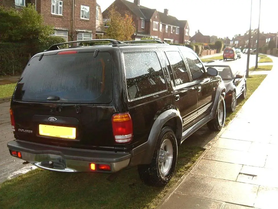

I have spacers on the rear only of mine. If you're going to get them, definately get billet spacers that incorporate their own studs. Those cheap ones you buy at stores just slip over the existing studs, and in turn shorten them so you have less to put a lug on...
(lost photos)
Personally I wouldn't run spacers on the front...you can play with offset on the wheels as well, what offset are you getting? I believe stock is 12mm...my current wheels are -6mm, which also brings them out some....even in the front.

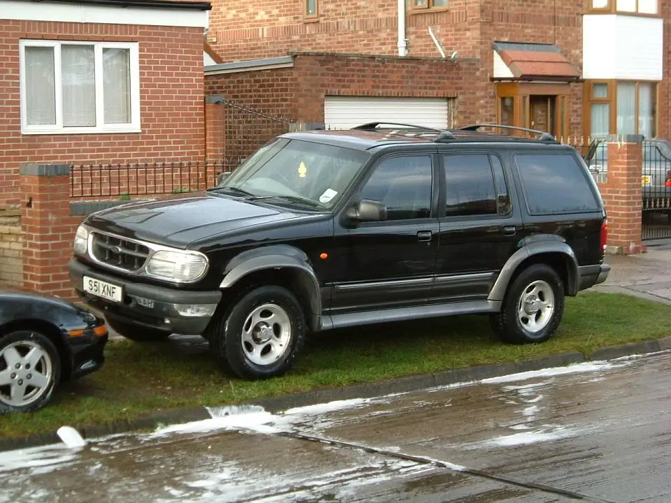

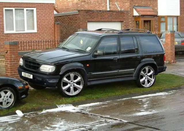

Here's what I'm after ultimately, excuse the dodgy image, windows paint has it's limitations
before :- stock
After with the wheels and a little colour coding.
Opinions ?
They are the ones, they are called Vemiri Arnages, obviously they are superimposed in the pic from a BMW X5 so they might not be true to scale as a 22" will eventually look, but it ain't a million miles away
