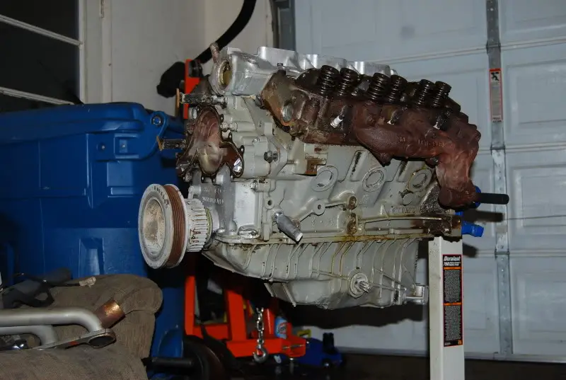

The only dependable fix is to remove the bad freeze plug and install a new one. There are a few threads on it. If it looks like it failed from corrosion, you should be looking at the other ones, they may be near failure as well, and it would be better, though more costly up front to fix them all at once.
Hi:
As others have said you probably have a frost plug leaking. According to your picture I would expect the frost plug located in the the front of the head. In the picture posted by Xeek you can see the frost plug. Same height as the spark plugs but on the front of the head. To get to it you will need to remove the AC unit and the power steering pump. If your AC works then you will need to evacuate the coolant first.
