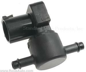

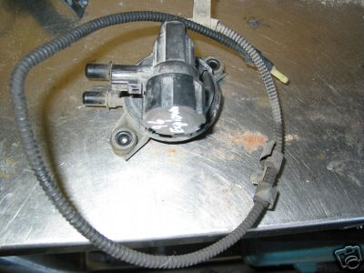

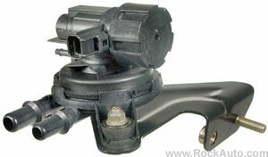

OK, Nate. Please don't get me wrong but... Are you sure about this new part? I mean - Is it the right one?
Motocraft calls it Purge Valve while Artex prefers Purge Solenoid but they looks like equal: An electrical solenoid with a vacuum source which opens an EVAP line.
But in this other one (AC Delco? Standard Product?) - I can't see the vacuum plug - Is there one, right? I'm curious about this.
Marcio

the part i got is the on the far right and it says on the box canister purge valve. it has a plug for the harness on it and a T
Sorry for the misunderstood, Nate. I can figure out which there's a Canister Purge Valve for 98's Ex (F67E-9C915BA) and a different one for 97's Ex (F57Z-14A606BA). And they might be in different places too.
