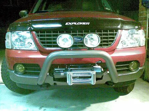

Wow!! And you spared the tow hooks through the bar... That is a 12,000lb winch??? You are my idol
Have you tried it out yet??
Wow yourself - that was quick. Just out of interest, what time is it where you are? It's just gone midnight here.
Anyway, yep, the tow hooks, nudge bar and rear bracket of the winch all bolt up to the standard tow hook mounting bolts (though they've been upgraded to 65mm long grade 8 high tensile units). Yes, it is a 12,000lb unit - physically the same size as the ideal (IMO) 9,500Lb unit, but was only $50 more, so I thought I may as well get something with more rating than i'd need. I also have a small 3500lb unit, but that was too far under the weight of the Ex - I may use it on a mate's boat trailer.
I haven't tested it yet - I still have to mount the control box somewhere, and wire it all up. Like your front bar, that job is still to come! I also have to make up a new license plate (a slim line one) and mount it somewhere - I'm thinking on the nudge bar might be OK. Also, no idea if this winch is even legal, but I guess I'll find out one way or another! LOL.
Oh, and I am no-one's idol - it was seeing you doing what you've done to yours that gave me the courage/inspiration to have a crack (go) at mine. I reckon the end result of this is that my front bar will be ripped off, but that's OK - it will be an excuase to get a full bull bar with integrated winch cradle.
