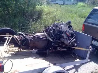

welp here is tha pic!
only one i have for now.
will get some more tonight when i yank the trans an put the engine on the stand.
Take it by a pressure washer first if you can, use engine degreaser. Good start,
acually thought of that right after I posted the pic and realized how dirty the trans was.

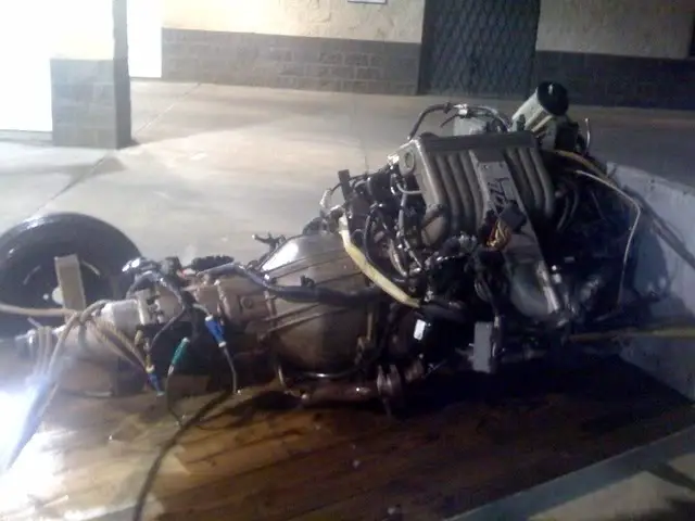

Since it's still on the trailer I'm gonna wheel the whole thing over to a car wash and brighten er up a bit.
Excellent, spray the engine degreaser on the area under the engine also, that makes it blow off better.
question: the car wash doesn't have a degreaser setting but It does have a tire cleaner setting, which it warns against getting on paint.
Is this the same thing or should I stick with simple green or something.?
well i went by the wash last night
after the wash, still not too clean but oh well.

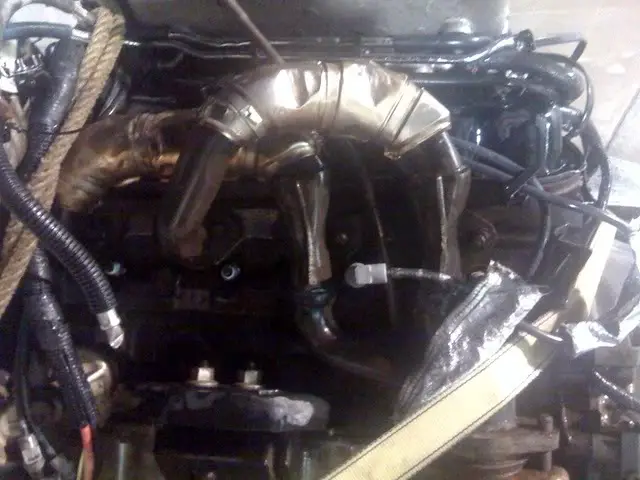

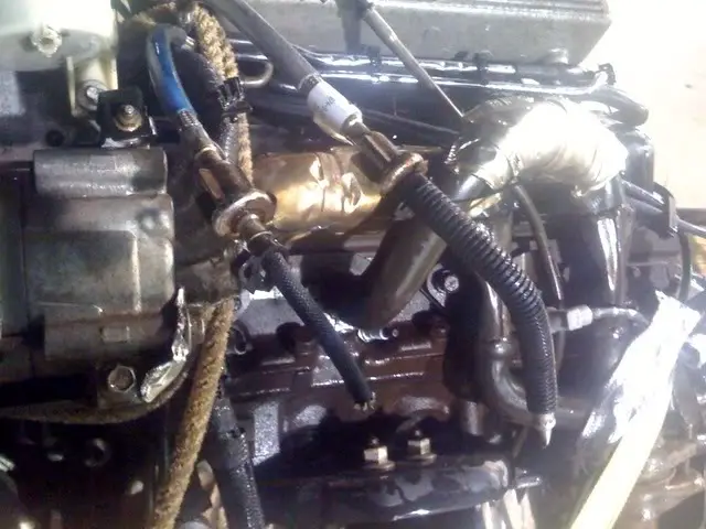

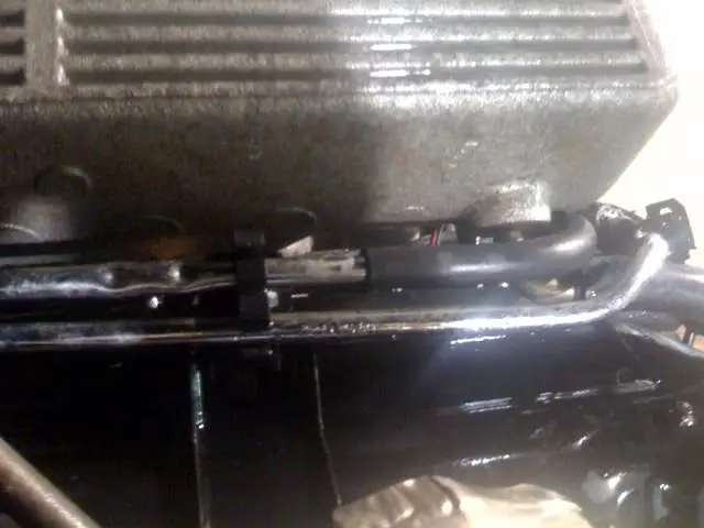

this manifold has to be one of the most disgusting pieces of automotive engineering i have ever seen
Why does it have two fuel lines? i thought it was supposed to be a returnless system...

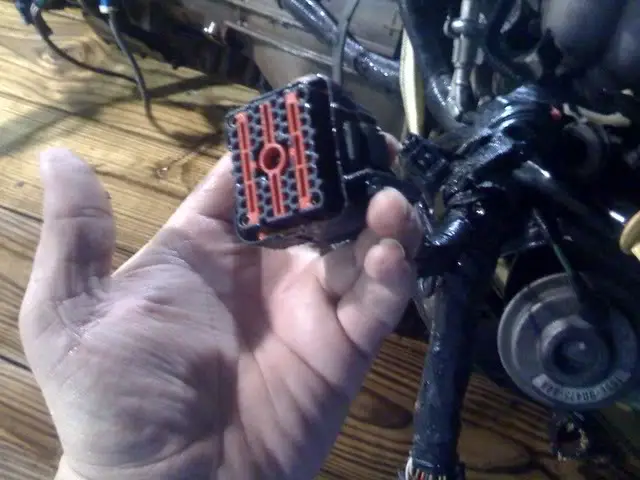

Am i correct in assuming this is the OBDII connector?
Whats up with the 6 inch long harness to the computer? the only way i could see this workin is if the v8 exs had the comp on the firewall

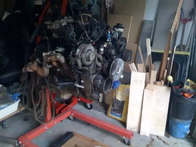

And here it is with the trans yanked off and hooked to the stand.
im done for the weekend on this thing. have plans with my mom so no work to be done till next week.
good sign though: i didnt have to use pb blaster once during the whole dismantle. = good
and please forgive my wierd lookin hand, it was soakin wet and wrinkley
Very good, a little clean up help a lot. That must be a 98 model then? The OBDII connector port is under the dash, part of the dash wiring. You have the engine harness, and it connects to the under hood harness. That has three big connectors which go through the firewall into the dash harness.
The PCM is located in the firewall, I don't know if you can do it that way. Look at your firewall hard, because placing the PCM there would save you a ton of time of relocating it. I don't know what your wiring plans are, you did say that you were going to use the OBDII. If so then you need at least the other wiring harnesses for donor parts. If you could do some research and merge your 92 under hood harness with the 98 harness, that would make things easier in the long run.

Ok so that square connector is from comp to chassis/dash I see.
Guess I'll have to tear into a junkyard dash.
The engine/trans harness you have has that one square connector, only the alternator/starter has other wiring going to it. That square connector plugs into the under hood harness, which covers everything forward of the firewall. That's where Ford made many improvements and that harness would be easier to connect to the engine and dash. I'd see about getting that and replacing your 92 under hood harness with it. Meaning use your end component connectors, but run the 98 harness out to those. That will let you use the 98 wiring diagrams to diagnose everything forward of the firewall.
BTW, the 99-01 under hood harness changed, and you need a 98 or older PCM, so try to use a 98 under hood harness. The 99-01 will work also, but then you would be mixing a couple of things about the 99+ returnless fuel system. If the 98 harness is trouble to get, the 99-01 is fine.
