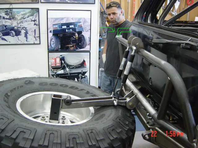

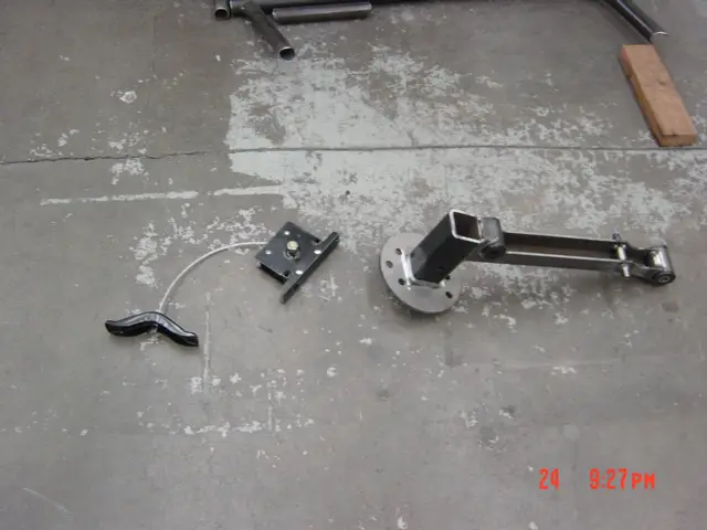

Yeah I like the idea, what do you do now? I remember you said you were going to rig up the old spare winch? Will that thing hold 120lbs?
I guess the lugs would been from the back? then you could loosen once folded down (or have a cover hub plate that it would bolt to) then lower the tire down?
Seems like a lot, however, it's beter then lifiting the tire up. I know from lifting mine in and out of the truck. :(

But don't you have to have the mount in the upright position in order to put the spare back?
Oh, I get it, the winch will pull it back into place and drop it down.....okay....me stupid. You are going to have to give a serious demonstration, maybe with a powerpoint video, for all the goodies on this rig.

A few more picture's ------

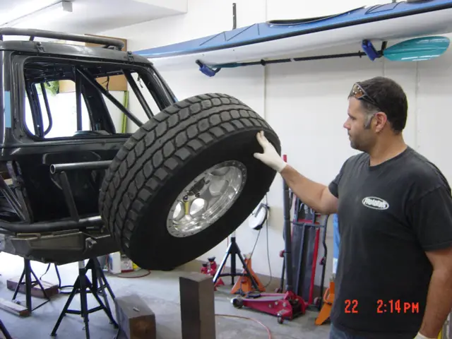

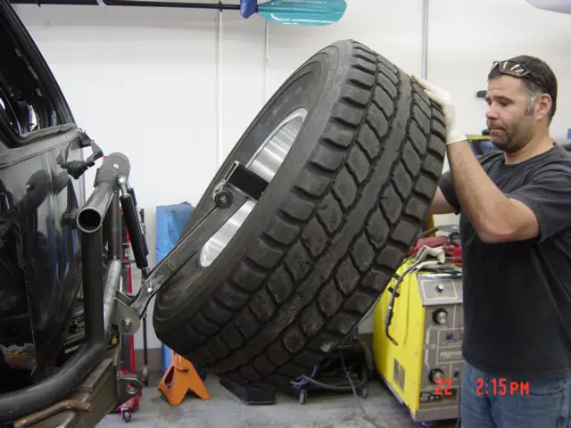

With the help of the shock's, it's finger tip only to raise a 120 lb. tire back up to the up right position. Yes we are going to use a winch like procedure to lower and raise the tire to the ground when it's in the down position. Just like you would do when the spare tire is under your vehicle. The whole design concept was to keep the whole back tire carrier as clean looking as possible, but yet be able to hold the weight of a 40" tire and that a single person could lift and remove the tire themselves. Will post more picture's when we get the winch lift in ( still waiting for it to be shipped). One more new major item is coming this week also, can't wait for it to come!! will post picture's of it also.
sorry for spilling the beans... just didn't understand how it was going to work from the pics...honestly, still not sure once the winch is on.
Maybe it's just me, but are we sure we're not just over thinking this? Just more things to break? over complicating?:(

Danny the top tube is not yet complete it will rap around. Progress pics. are hard, I think because it is hard to figure out the details when you are not looking at a finished product. Also Danny you are totally right when you say reliability. The main reason I chose this design was for the strength and durability. I know my Ideas are crazy some times however, I am a believer in simple and to make simple sometimes requires lots of detail. I can only say I can't lift a 40" tire by my self and if I need to change a flat on the side of the freeway or on the trail I may be alone.

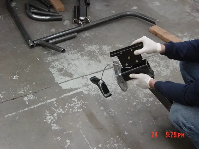

Here you go Stic-o, the winch system came in today. The second picture is just one possible way of mounting it, that could change though. And yes it will hold 120 lbs.

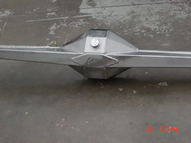

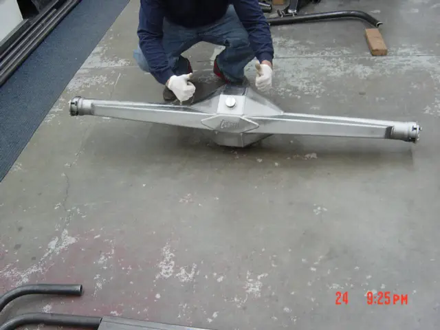

This also came in today.:D:D:D Currie's new F9 Fab housing!!!!!!!!!!
Very nice, that lift idea reminds me of a ride-a-round lift I installed in my mom's van about 6 years ago. It was rated for up to 400 lbs and was electric with a swing out winch arm. The only shortfall was it used a nylon strap like a tow cable. But it was solid and strong as heck! She accidently bent the rear steel bumper up on her E-350 van when one of wheelie bars on her ride-a-round caught it while being lifted by it. I never thought about using it for a tire lift, but I certainly entertained the thoughts of making a toolbox lift out of it!! It was a Bruno model.
