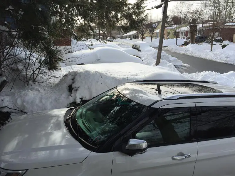

I have installed the in channel air deflectors from WeatherTech in my 2016 Ford Explorer Platinum. They fit just fine and they only took 15 minutes to installed them. Never had a problem with the sensors in the front windows. When installing them I just pulled on the deflectors while bringing up the window and didn't touch the window for 72 hours and they work just fine. I have used WeatherTech air deflectors in my 2012 Explorer Limited , 2013 Explorer Sport and now in my 2016 Platinum Edition and I can honestly say that they are the best air deflectors in the market.
Here are some photos of the window deflectors already installed in the 2016 Explorer Platinum,

Thanks for the pictures. My deflectors are on order. I did speak with a weather tech rep and they told me thatFord has very senistive windows and that the memory will pick up the window vent and they should work fine after about a week. Then I saw your post and really like what I see. So, let me get this right. You pulled out the window vent and had someone close the window from the inside? Or did you do it by yourself? Have you checked out the headlight protector they have on their website? Thanks again for the pictures. Beautiful vehicle.

I did it myself . I am 6'1' so I was standing behind the door from the inside and I brought my arm over the door and slightly pulled on the air deflector while bringing the window up until is was up all the way and left it alone for 3 days and after that period of time the window works fine with no problems at all.
