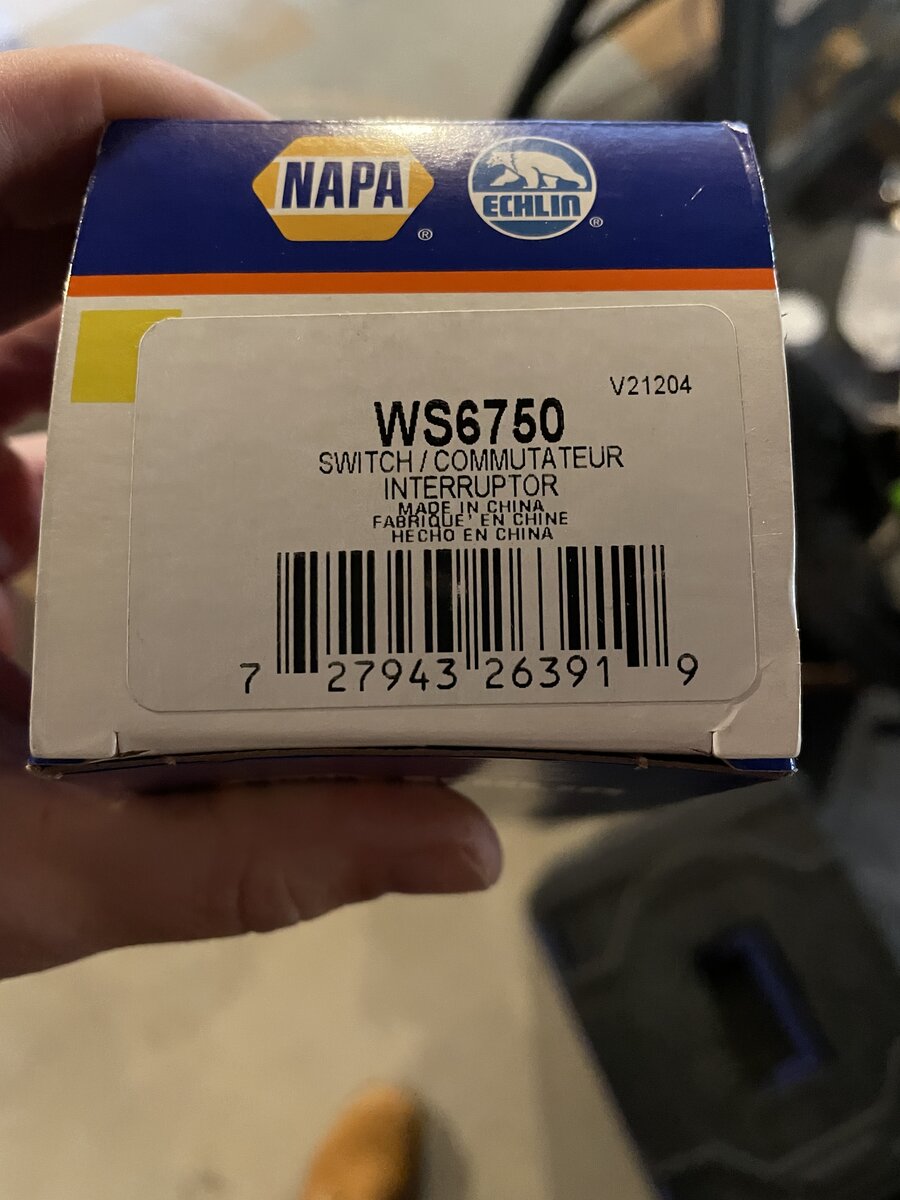

WS6750 is the part # I got from my local auto parts store.
This is what they gave me. The ford one was out of stock and it’s been snowing so I needed my wipers lol. I am guessing this switch is wrong for my application
That appears to be an ECHLIN part number.
Dids some more digging and found this site; WP495 by STANDARD IGNITION - Windshield Wiper Switch
The 4th and 3rd numbers from the bottom are the ones that AutoNation Ford showed and they don't seem to equate to the ECHLIN number if you click on them. I also see that the site mentions "Standard Ignition". I'm guessing that is a keyed ignition.
I really don't know what to say other than it has filled in some of my Saturday afternoon time. :) Good luck.
I do indeed have a key ignition! So I am lost with all this lol. I might just bring it to the dealership
