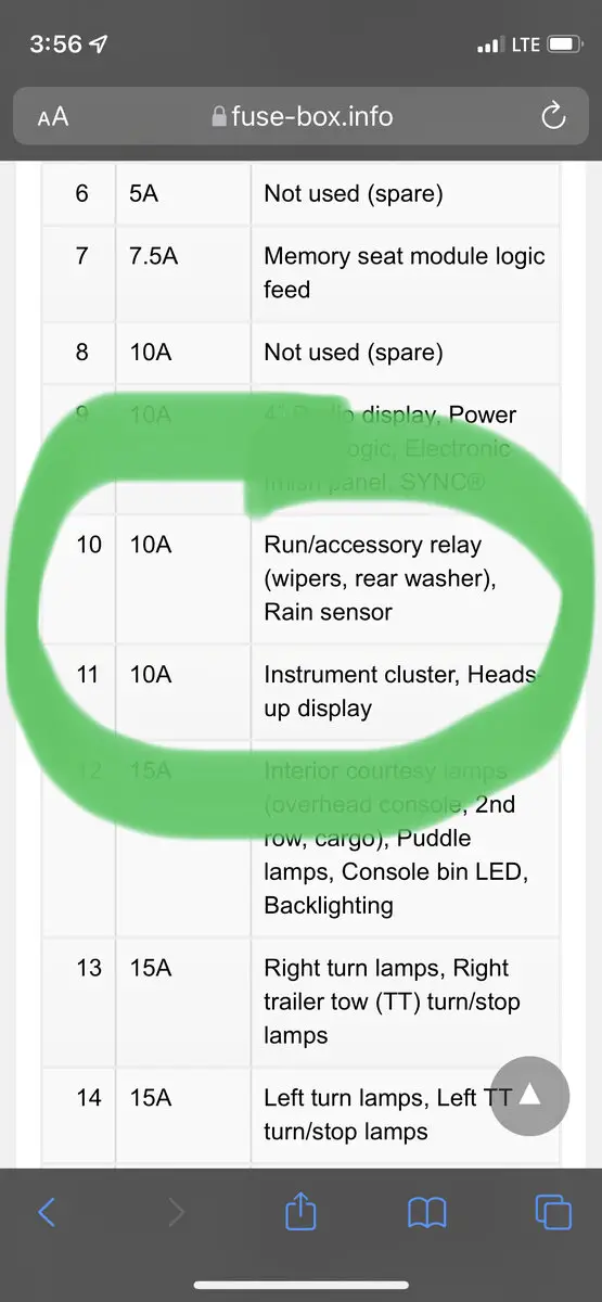

Not saying that this is your exact fix, but it happened to me when I replaced the pump and it was because I played with the fuses before swapping out the pump. There are empty fuse slots where these fuses reside, so I accidentally put one of the fuses into a nonfunctioning empty slot that resulted in only the back washer working after replacing the pump. I then pinpointed the fuse that I moved to an empty slot and put it back in the correct slot to get the front washer working as well.
Not saying that this is your exact fix, but that happened to me when I replaced the pump and it was because I played with the fuses before swapping out the pump. There are empty fuse slots where these fuses reside, so I accidentally put one of the fuses into a nonfunctioning empty slot. I then found the correct fuse slot and all worked well.
I only pulled the #4 fuse on mine and tested it with a volt meter and it tested fine. I did the continuity test on the ohm meter and it beep like it was a working circuit the only other thing maybe the relay is bad?
It looks like there is another wiper fuse in side on the drivers side under dash?
Easy enough to check. Take out the relay and replace it with another relay with the same specs from another slot. Although I'm sure you did, double-check where you put back the #4 fuse.
