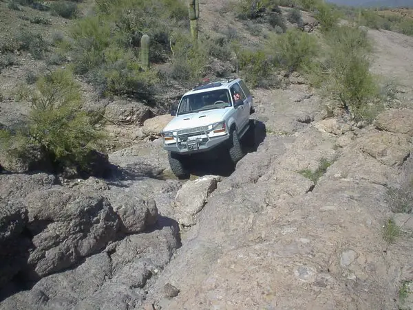

Wow, lots of questions, I will try to answer a few.
1. Yes, six inch skyjacker, rear is a hybrid of 4 inch superlift springs, and warrior shackles.
2. already have the drop pittman arm, need to align, my camber bushings are off, causing too much caster, that is cause of pull.
3. Yes bumper brackets suck, will have to work a little more to get them 100% right. The only thing I don't care for on the body lift is the steering extention, puts a bind in steering, that is minor, not a big problem.
4. Did not put extended arms in, that is on my wish list though... 500 bucks for arms and brackets
5. Only vibration I have is at 75 miles an hour, bad ballance on rear tires, the guy that balanced them did a crappy job, will wait till new wheels go on, that will be soon.
Just a recap, as far as hieght it sits 7 feet 2 inches from ground to top of roof rack, this is with 33's on it, I think it looks not as tall due to the tires looking too small now, 35's are in the future, which I think will be a big improvement, with the skyjacker parts, and new rear springs she rides extremely smooth, much better than my silverado did when I lifted it, gotta go nerf bars too, my wife has to struggle to get into, now that it is all in place, I will be tightening up some aspects of it, such as bumpers, and additional paint to the frame, oh I also do have the extended brake lines in front, had to use the rear on the driverside front though, still need to order it, it is hanging loose right now, the kit they originally sent me was for non-abs, which will not work on the driver side. With minoe trimming I can easily go 37's, but that would probably be too much for bearings. I will try to post more as I think of it.

Hmmm, another big white one. A word of advise for ya'll. I never had problems with 32's but with 35s on TTB I've broken and bent everything. EVERYTHING I MEAN. I've gone through every shaft, blew bearings, 2 drivers side spindles, even blew my entire 3rd member case to pieces when I snapped u-joint on that middle shaft. Don't get me wrong, I wheel the hell out of my truck when it leaves the pavement, so this has to be expected. Just remember 35's are terrible on a TTB.
Other than that, big white Explorers draw lots of attention.

Dan had all skyjacker components now, I believe, and I'm pretty sure he is running stock steering and possibly a steering stabalizer. Stock RA's too.

Same set up that I have.

Yes I have stock steering, stock radius arms and my steering stabilizer got sheered off on a rock (go figure)
