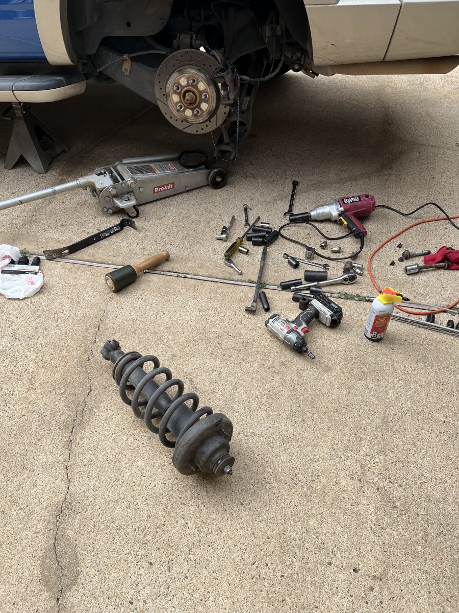

I find myself here because this is where my problem will have been seen.

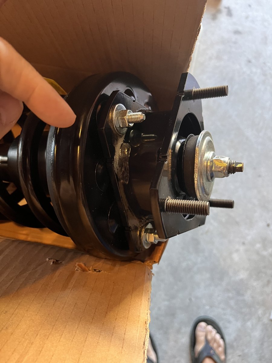

I purchased a lift kit off eBay, I wanted the back to be 2” higher when I load it down with cases of hotsauce.
after looking around at all the options the lift/level kit seemed the besT option as it will be 2” higher mo matter what happens.

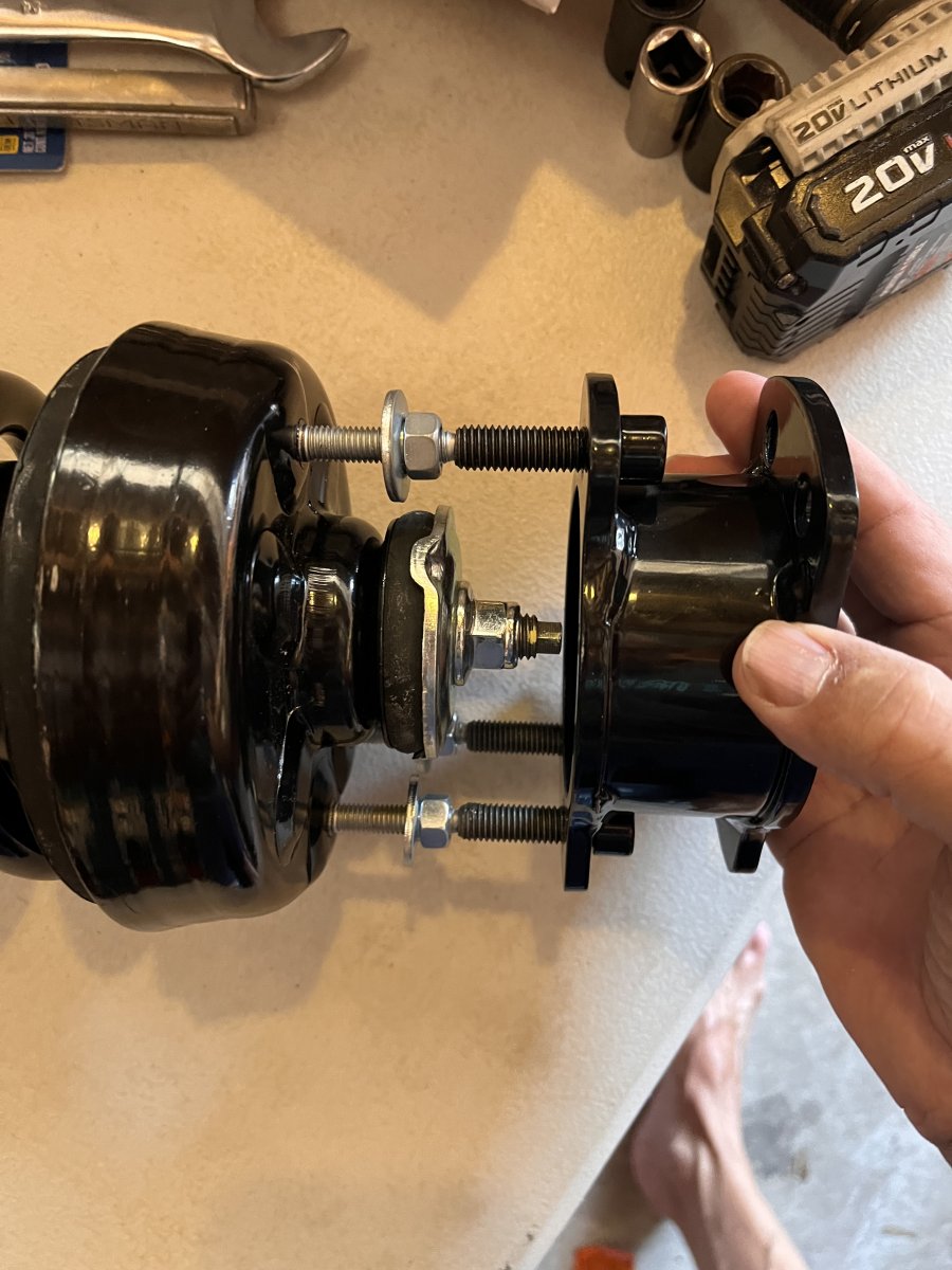

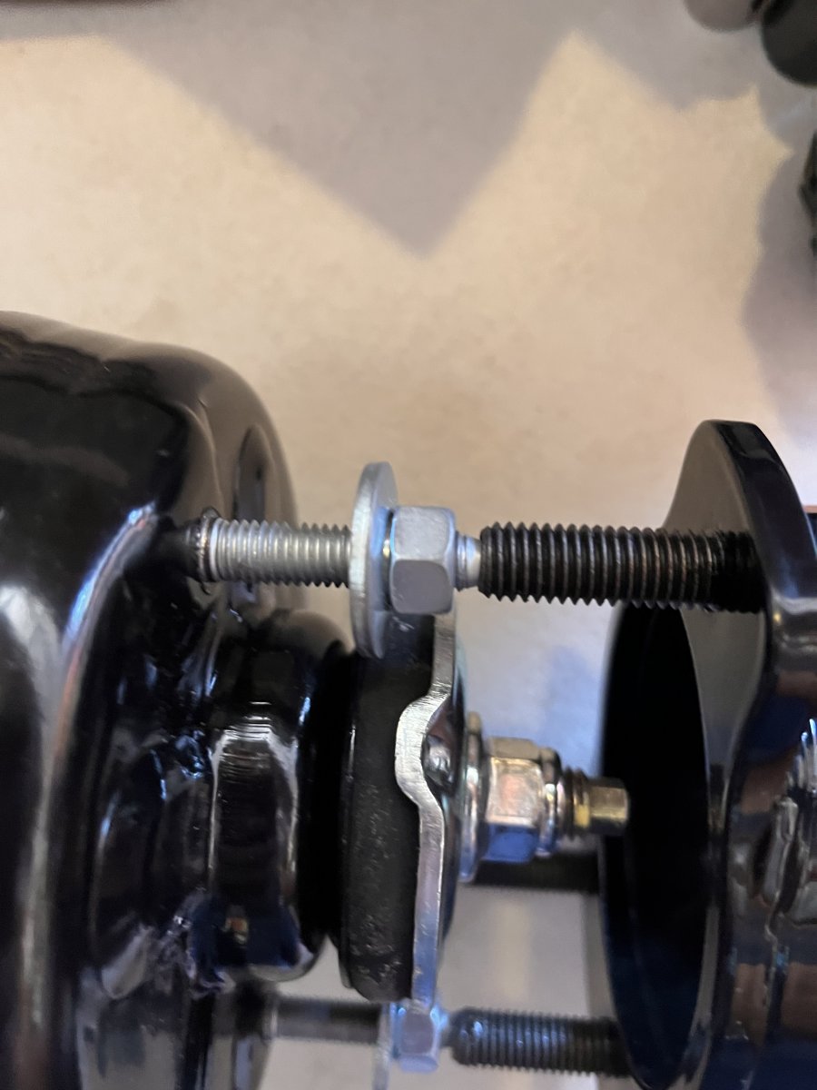

as I was gathering everything necessary I noticed the stud bolts in the package were larger than what was on the actual Monroe shock.
on the Monroe shocks the nuts and bolts are M 8 1.25,
while the lift kits nuts and bolts are M 10 1.25.
this would not be an issue if the truck will take the M 10 1.25 studs to mount onto the car.
the old me would have taken everything apart before seeing this potential problem.

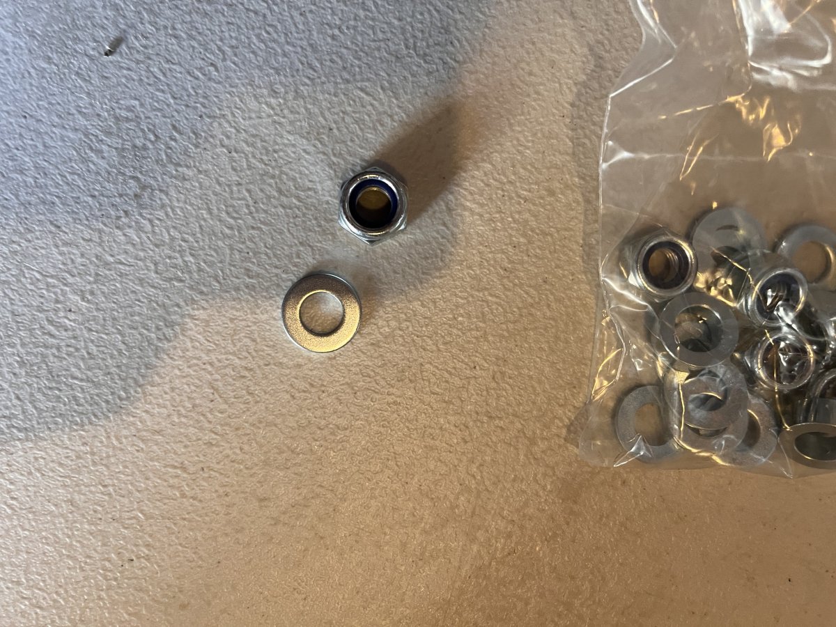

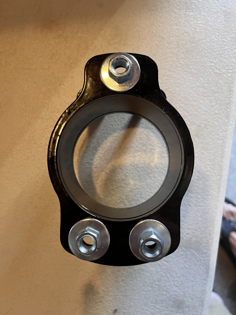

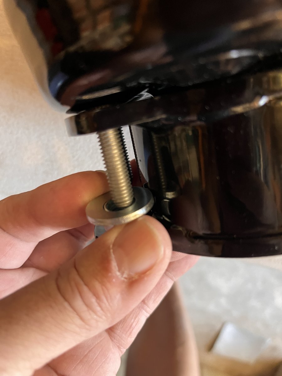

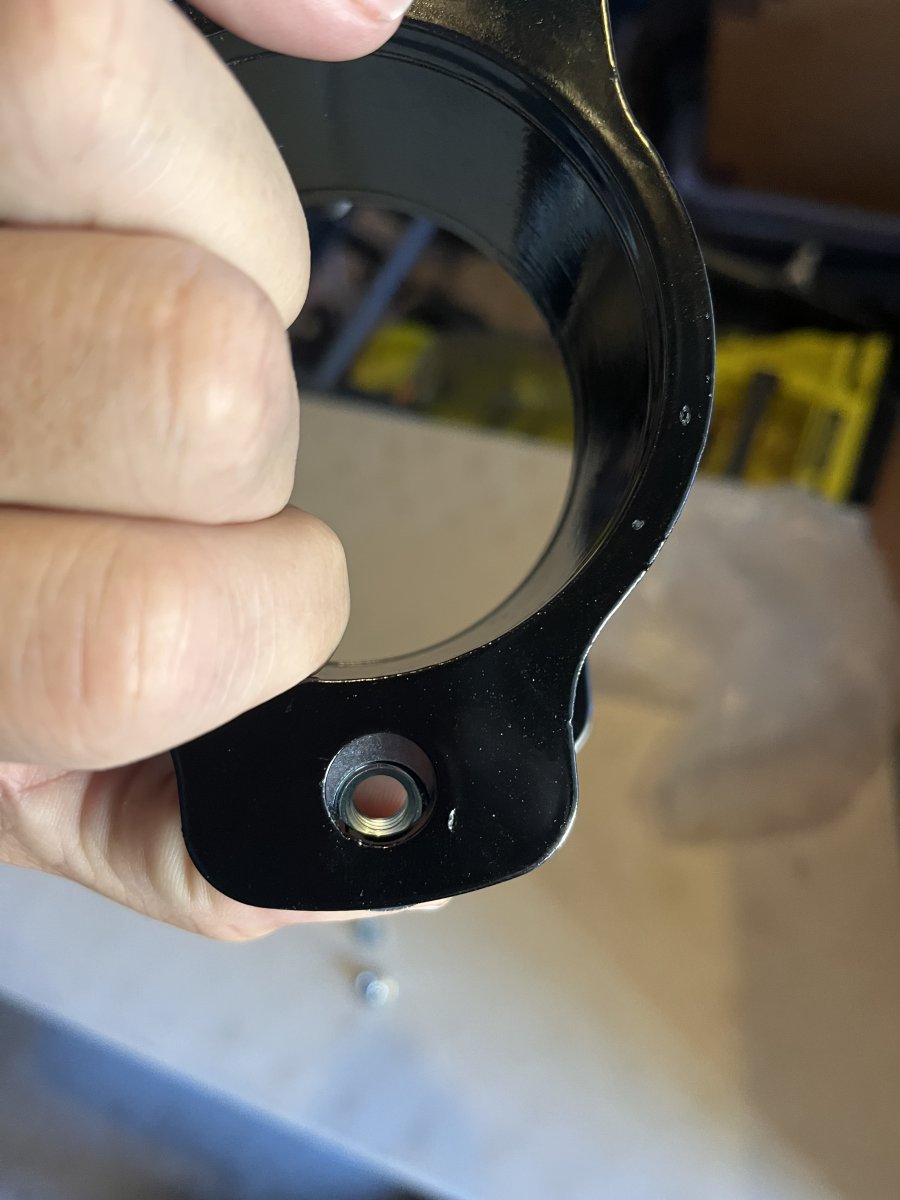

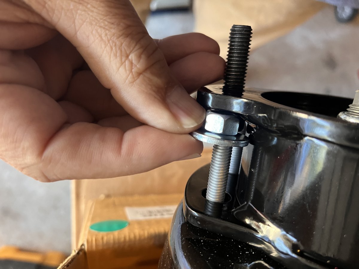

im wondering if the lift kit will actually fit with larger bolts m10 vs m8, because when test fitting i noticed on the front spacer that the nut/ washer provided by Monroe (8 mm) would not affix to the nut because the washer is too large and prevents the nut from attaching..
at this point I am stuck, I have all these new parts that are supposed to attach like OEM stuff.
I am sure I can McGiver it, but if I was gonna do that I wouldn’t have bought a bolt on part.
I need some input from the family here.
