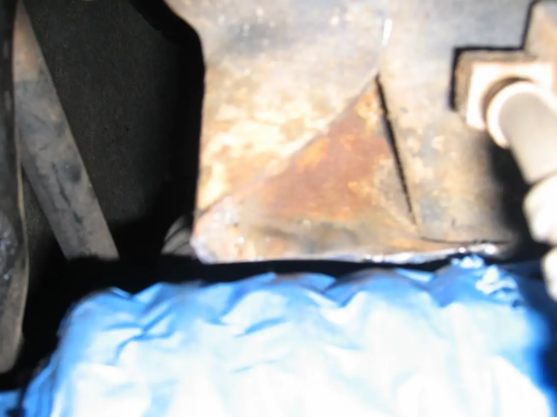

KICKER BARS SCRAPPED!!
for now im going to use these to mount the shocks for mock up, and depending on how thick they are they may remain permanant.
