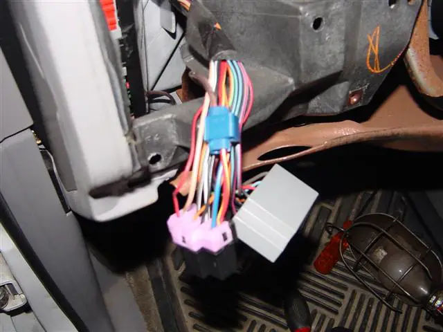

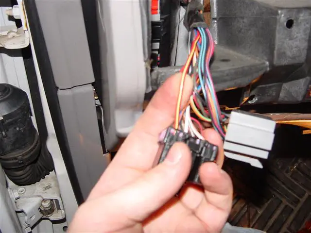

After that is removed, find the Red/Yellow wire that is located on the headlight switch connector. This is the kick on wire for the Headlights that goes to the headlight relay.

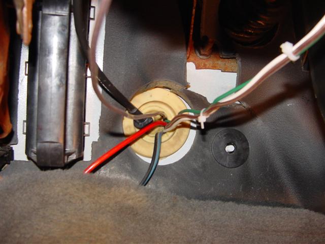

Using some speaker wire I had laying around (heavy duty wire is not needed at all for this part) I spliced into this wire using a quick connect.
I then ran the wire through the firewall through an existing gromet into the engine compartment.

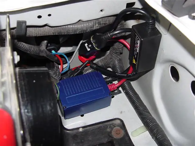

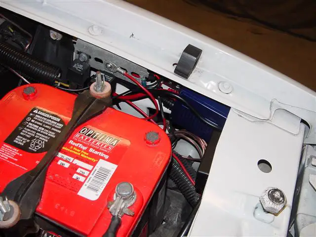

Next I began working on the lights themselves. The bulbs mount in the housing as a normal 9007 bulb would. I then mounted the ignitors and ballasts near the headlight region, making sure that the wiring would reach. The mounting of these items is dependant on your application.
Passanger side:
Driver side:
Next in line is the wiring. I mounted the relay(can be seen on the drivers side picture behind the battery hold down)

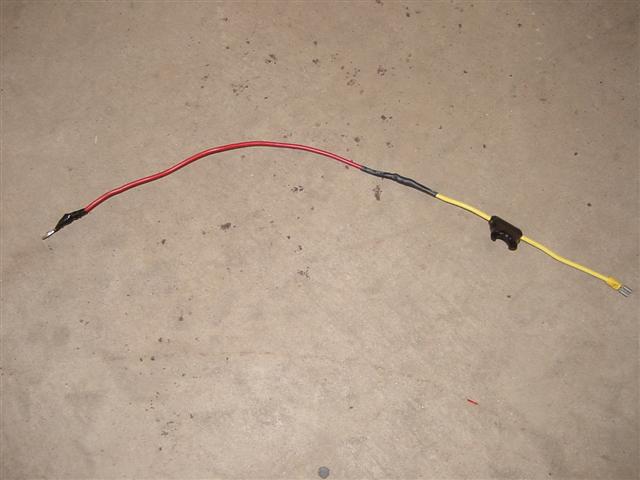

A power cable was made to proper size with an inline fuse.
and connected to tab 30 on the relay.
The kick on wire from behind the dash was connected to tab 86, and a ground was ran to the chassis from tab 85.

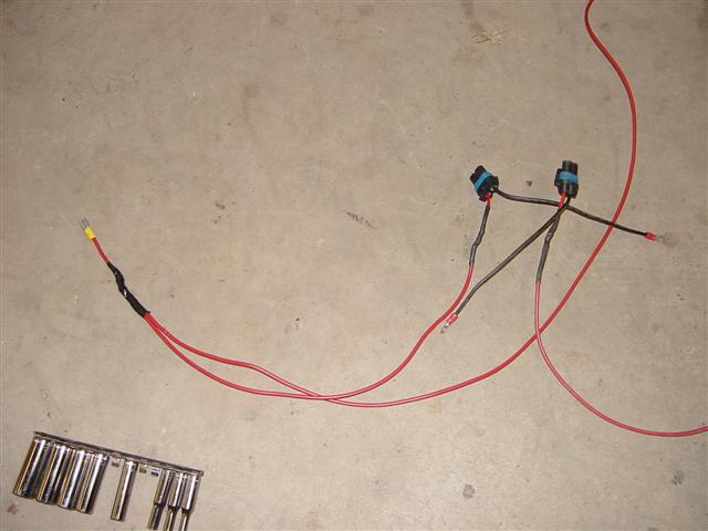

The kit included 9007 sockets to plug directly into the stock wiring and had another connector to plug into the ballast. I cut this harness in half. I was only interested in the section that plugs into the ballasts.
I then made another section of wire to connect the relay to the ballasts. A ground was also screwed into the chassis from the ballast connector.
The newly made harness is then connected to tab 87 on the relay and properly ground on the ballast end.

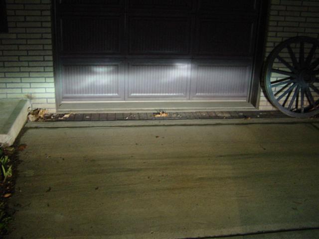

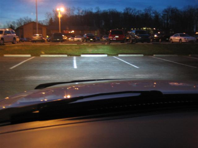

Extra pictures:
5000k HIDs in Diamond Clear housings with SilverStar Fogs vs. SilverStar heads in Diamond Clear housings
