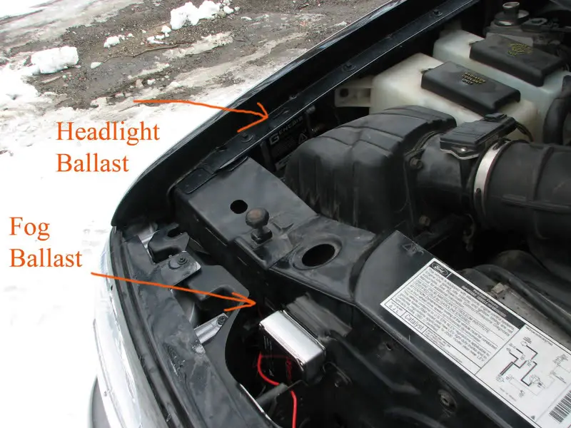

I mounted mine here.
http://www.explorerforum.com/forums//showthread.php?t=209015

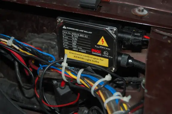

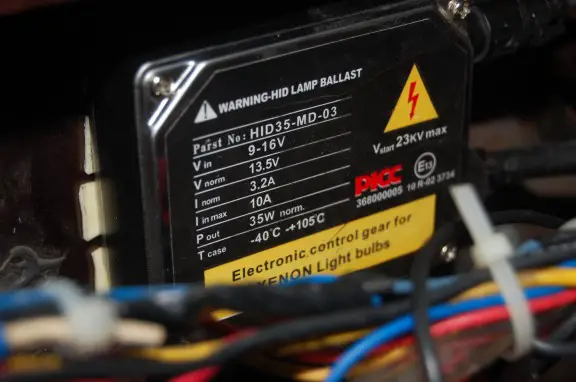

Pics of the driver's side ballast that I neglected to post initally.
