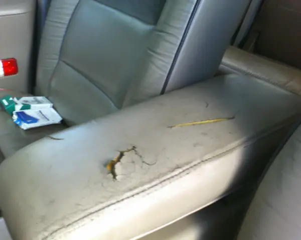

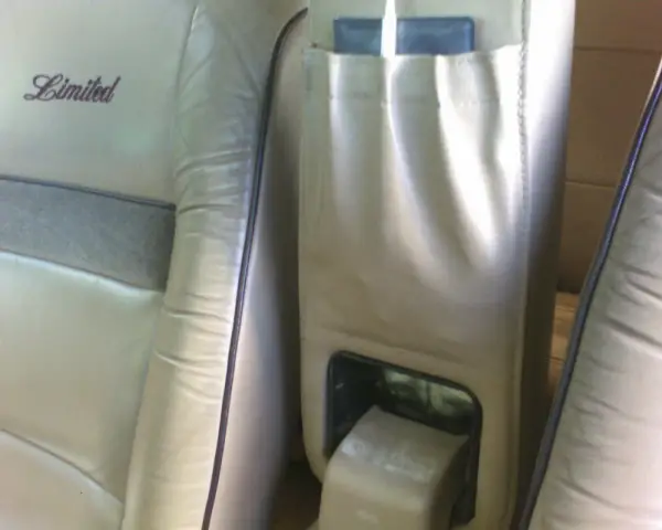

what about 1st gens? How do we recover ours? mine is in BAD shape
