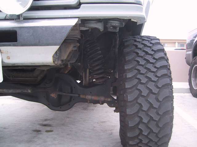

Do 44 beams get cut and turned or do they stay stock? Also what kind of coil setup is needed? My only experience is seeing FROADER's poor rig with some weak looking setup after he sold it (or wait, did he set it up like that???)
Also, if Dana 44 Knuckles bolt up to a 35, can 35 Knuckles bolt up to a 44? This way you can run your current rims, lockouts etc for a few months while you score some cash and get some rims. I know it sounds really lame, but fab work isn't cheap. As autofab states "buy the best and cry once."
yeah, I just like to bust balls. What a shame, That truck was clean looking. So why take out 4wd but keep 4wd beams? And those angles of the coils make me sick to my stomach.
the d44 beams still need to be cut and turned. and from what it looks like, autofab moves the coilseat in closer to the center (look at the radius arms and how they mount to the beam)
