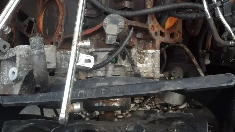

Tried rotating the cam sensor stator a bunch of places, nothing ever changes as to how it ran. Again, never removed the sensor from the top, now or before... Just turned the orientation of the entire unit to teh lower intake.

We did notice fuel on the ground though, tonight. towards the back, so the intake is coming off again, I think that's where we need to check. I'll bet something is loose and blowing fuel/losing pressure at wot. I did notice driving today that even when you go 3/4 and hit 3,000 rpm, it stops pulling.

I'd like to shoot myself in the face.
Pulled the intake. Again.
Fuel filter is leaking now.
What the hell is this rusty ring thing fused to the filter throat, should this be in the fuel line connector, and do we need to get one of those repair kit now?
