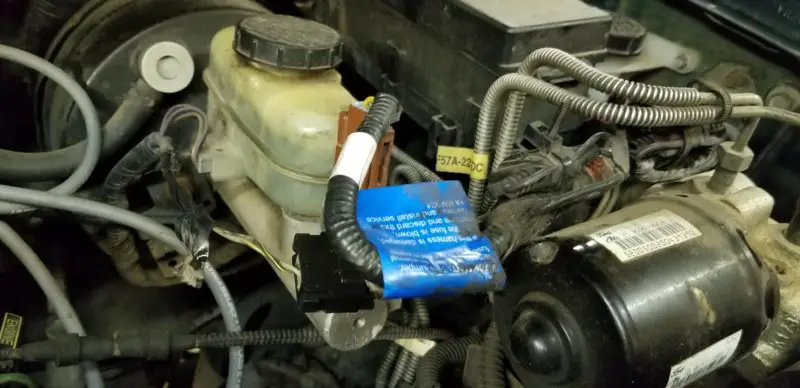

look at your brake master cylinder there should be a red switch mounted to the end of it
Ford installed a wiring harness on this switch with some fuses in it, if the harness is there, the recall has been performed.
Check the fuses and all cruise control related fuses

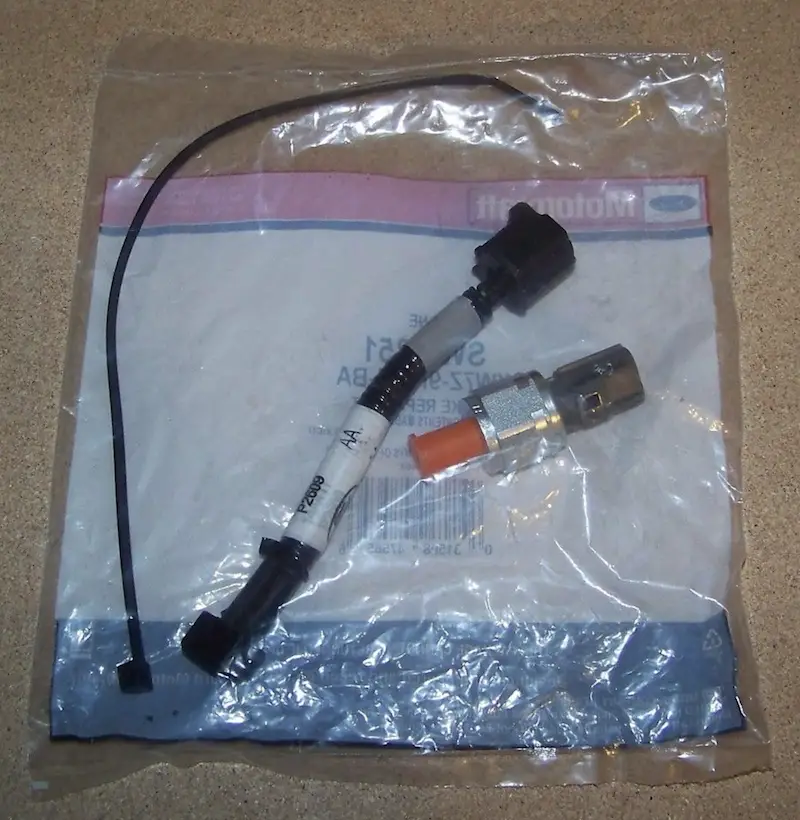

Replacement harness will have a blue label on it, like this one…

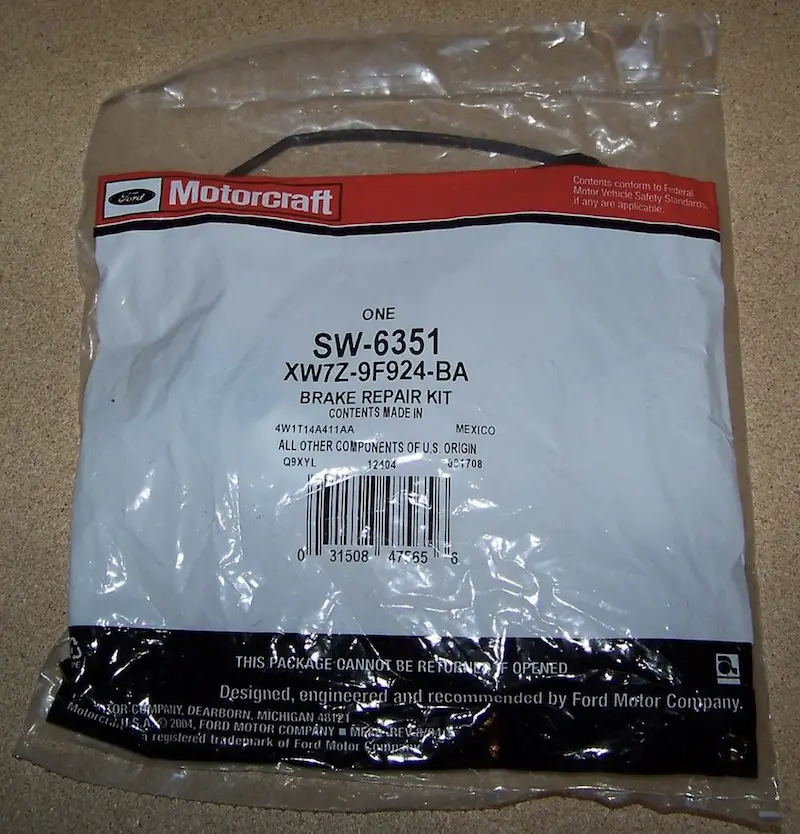

This is the number of the repair kit
