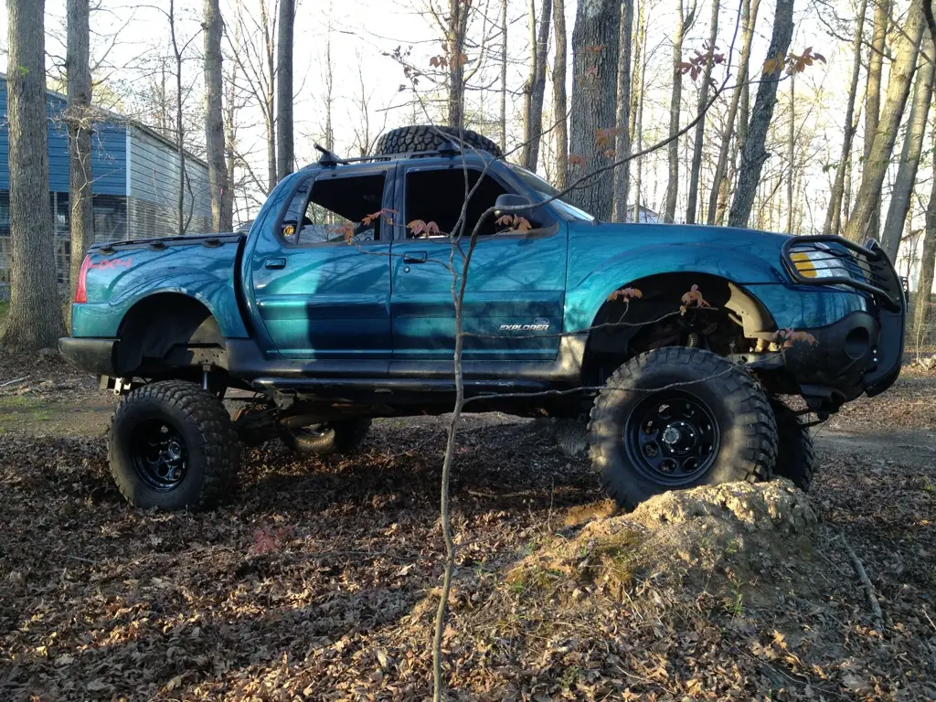

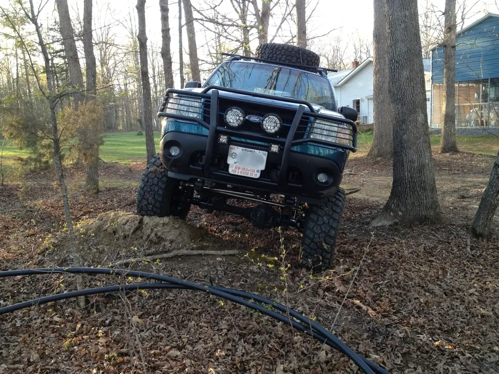

Well it's official, I'm now a member of the SAS Trac club! I got the truck back down to SC this past weekend. It drives great and can do a steady 75 mph but is much more comfortable at 65mph. The gearing helped to adjust my speedo closer to correct. Its now showing 4mph faster but I will adjust that using the ScanGauge. I still have to climb under and check out the transmission crossmember and get dimensions for a front driveshaft. That's probably going to be the last thing for a while as work and crew is getting crazy, taking all of my time. If you have questions about any of the setup ask away. Enough talk, here's some pics.
I'd say the trackbar and sway bar work well at what they are supposed to do. The truck is solid at speed, in crosswinds and around semis. Quick disconnects and a track bar removal will be in store soon.
Looks great man! I'm so jealous!
I also need to get some urethane bushings for the leaf springs. I had 17" of travel at the wheels before they were torqued down and now I'm down to about 12" which is still a ton more than it used to have but I want the maximum amount of flex out of it. The shocks are great too. They're Bilstein 5100's made for a JK with 6" lift. I think they're 10" travel, I can't remember now as it's been a while.
$40 extra got me hi-steer over getting separate parts (pretty much same parts from the same company) so I decided to go with that. Much cleaner looking and much better steering angle. The steering box is from a Super Duty hooked up to the stock pump. The box is 4 turns lock to lock vs. the stock rack & pinion that is 2.5. The wheels turn so much easier and there is a lot less strain on the pump now to turn the 35s. Only thing is I'm turning the wheel like crazy while parking and tight places but that is a small price to pay in my eyes.
Also, the 4.88s were a perfect match. The effective gearing is just a little lower than my stock 4.10s but I love how it drives compared to the 4.10s and 35s, it actually has a little get-up-and-go.

Man we're gonna need some better flex pics, you were flexing better than that with IFS and sway bars :D

Thanks guys! I will definitely get some picture once I get my transmission cross member modified. I need to talk to chad and see what he did to get his driveshaft to work.
Colin, you might be right but I don't think it flexed that much. I can't wait to ditch the track bar. I kept it on there for safety sake on the 500 mile drive to school. Then some quick disconnects for the sway bar and urethane bushings for the springs.
