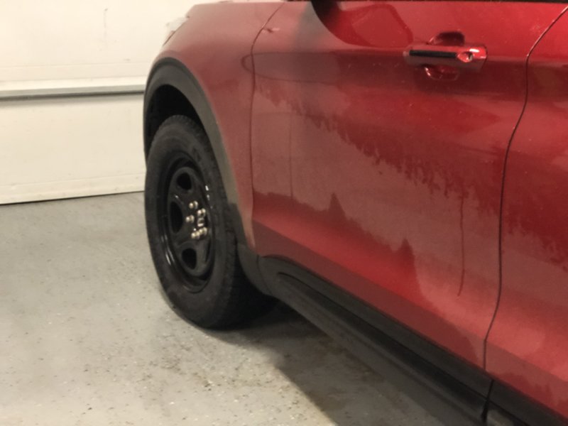

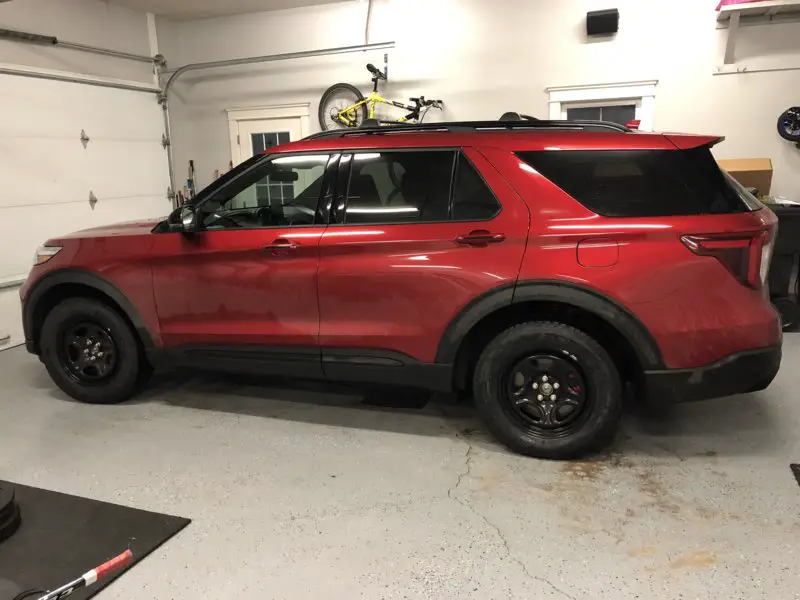

As you can see in the pictures, they do fit OK, look funny but fit.
There is about 1/4" clearance from the caliper to the inside of the rim.
Matt, I have bridgestone blizzak, they are the tires I had on my 2018 Sport, they are one size to small, but I have to use them
for this year recommended difference in size is 3% my old ones are 3.4%.
Did you manage to get good pricing on the rims and TMPS.

Hey Brian, thanks for the picks! Yeah I agree looks a bit small... but think about how nice it will look this spring when the 21s go back on!! :)

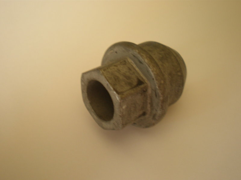

This is what I had to hold the center caps on mine. I got a bit of a deal on them ($2.56) from the parts department as they were the last ones they had. Otherwise, they would have been quite expensive.
Wheel Nut - Ford (DG1Z-1012-A) | Eastgate Ford Parts CA
Peter
That is the exact wheel nut as I have, but like everything else to do with the wheels they do not fit.
I am looking for the same design of nut with a 14 x 1.5 thread, any help would be appreciated.

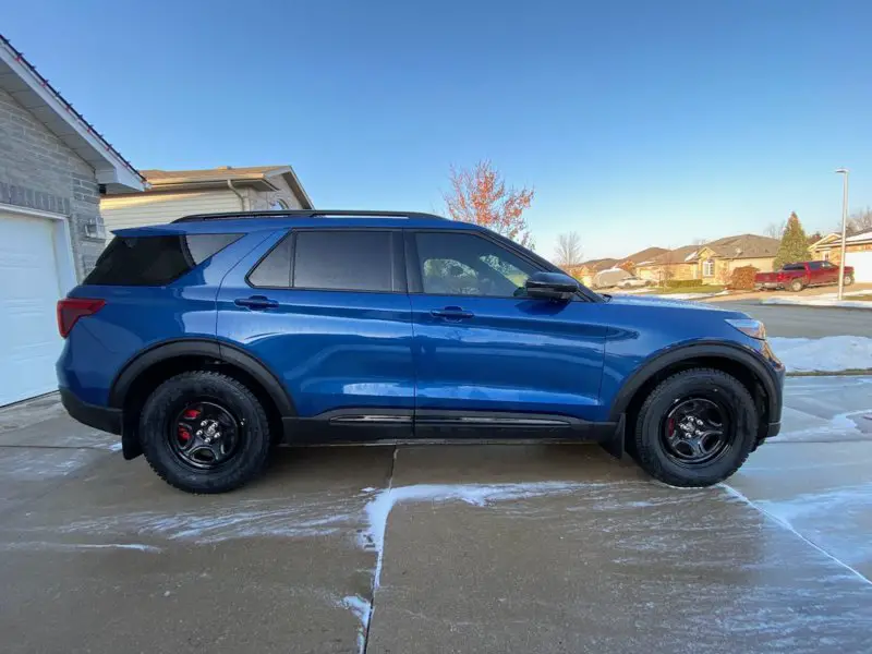

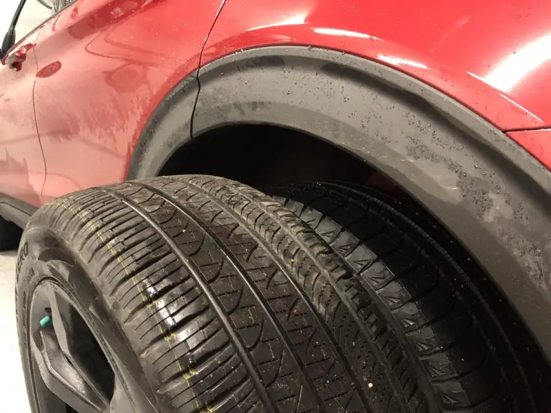

Winter rims are on! They are 265/60R18 Xice X2. I am more then pleased with the look. Lots of rubber and fills the wheel wells just fine. As you can see when I roll up the stock 21s there is a noticeable difference. About a inch and a half smaller, which is almost exactly what the online tire size calculator says. Thanks to this forum for pointing me towards the PUI rims... my dealership sure didn’t help!!

Is it wrong that I wouldn't mind rims like that all year round?

The ride quality certainly is nicer than the 21's I just took off. LOL
