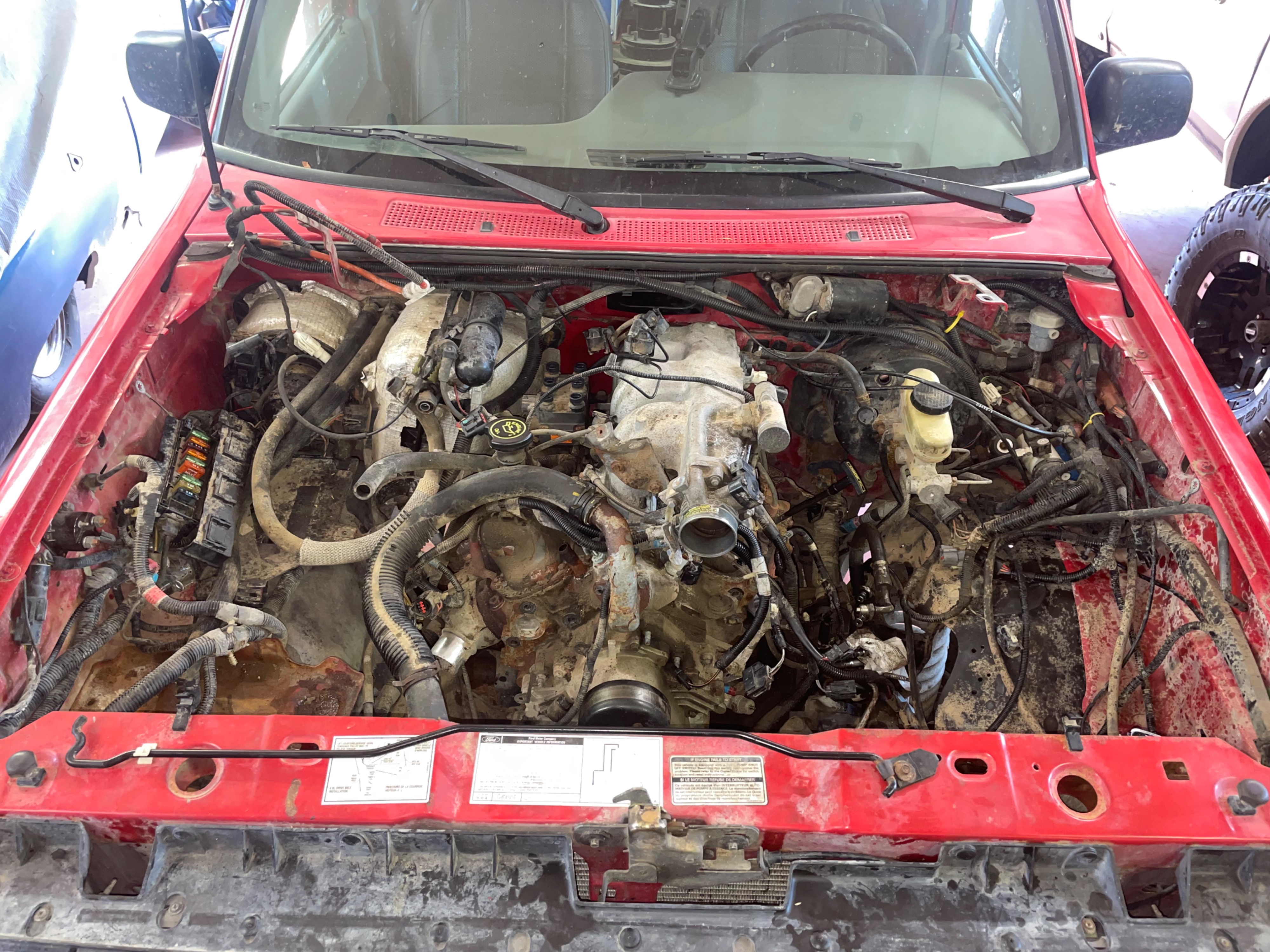

While this has been going on I have taken a head dive into the wiring
And my buddy Greg is burning us a chip for our pcm
The pieces are coming together
This is a 1992 explorer under hood wiring harness… complete
Stripped all the conduit and factory tape off
Save the good stuff to be re used
Now step one is to remove a few things from this wiring harness
The 92 v6 eec-iv pcm is for sure not needed
Except I will want to put the v8 pcm in this same spot. So looking forward I know I can keep a few of the wires that come from the truck side of things, like ignition power, ground, fuel pump control, tach signal, etc
So being my crafty self I left those wires in place. I will be extending thr v8 PCM wires to reach this location. So the remaining wires are labeled left to live right where they were put in 92.
PCM plug cut off, remaining wires labeled
The ignition module, under hood obd1 diagnostics port, pcm pigtail and all wiring that went from truck and pcm to engine is cut out
Now I have a stripped down wiring harness that plugs into the 92, But is lacking all drivetrain connections
Now to grapht the 5.0 wiring in place
