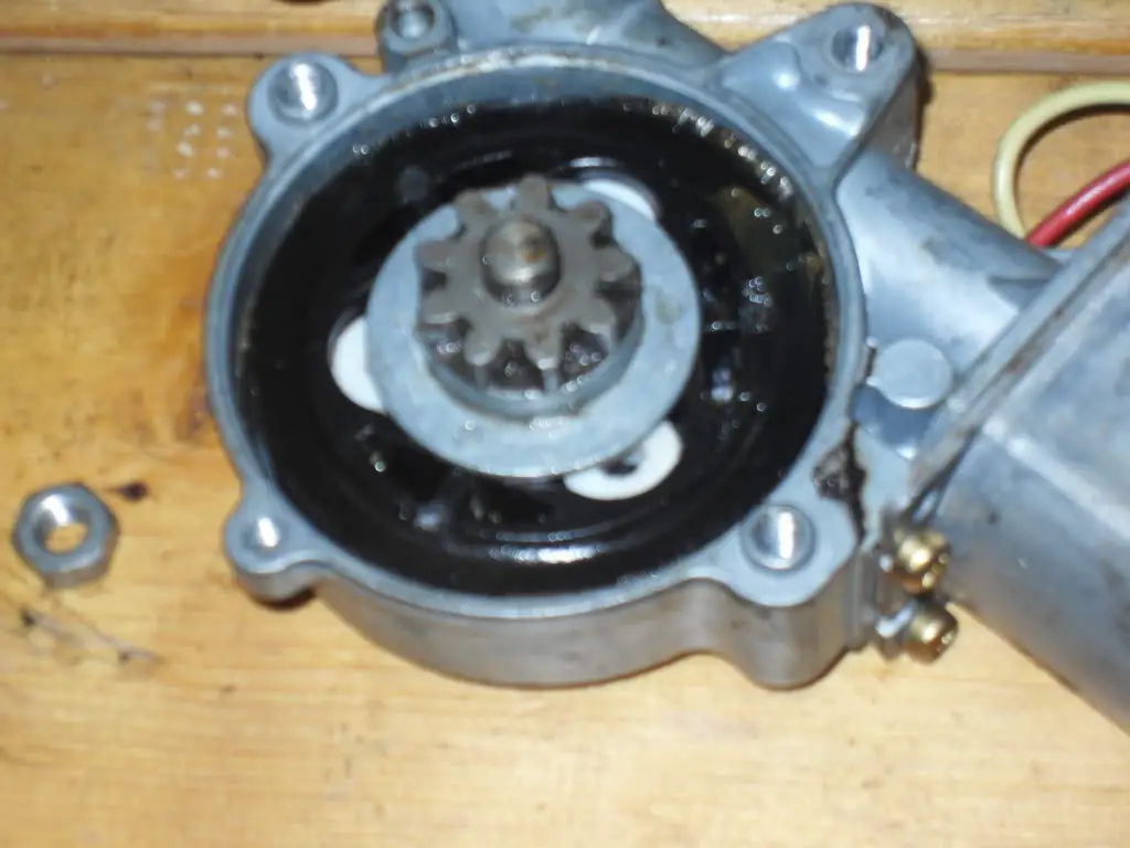

My second bushing replacement and could not have done it without 85 Dave's help. I found that the "C" clip holding the metal gear in place was difficult to see unless the shaft was wiped completely clean of grease.
In replacing the bushings and fitting them back into the plastic gear, place a spot of grease on the metal gear and the bushings will hang on long enough to get them started. Also, the new bushings seemed to have a very slight taper so placing the rounded end down allowed the installation to go easily.

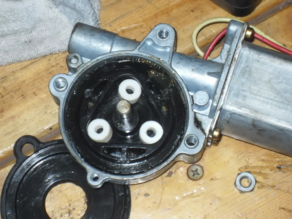

I completed the job with only a few hiccups. I would however like to add a few things to this to try to make this repair even more painless.

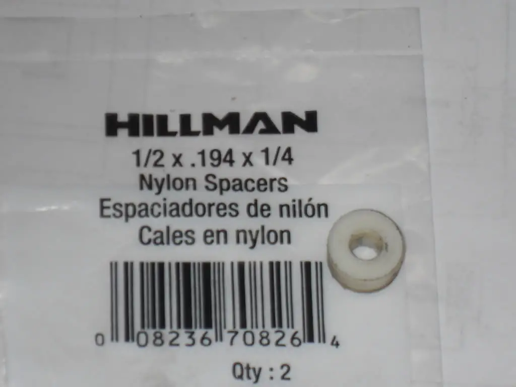

The bushing were difficult to figure out but I did after a little trial and error. I wasn't able to find them at home depot, but at Lowes they had some. The picture that was posted didn't show a hole but the ones that I found have one. I struggled to figure out what the bushing was for, thinking that the bushing had to turn. Actually the whole thing stays one piece. The bushing must act as a shear of sorts which is why the motor turns but the window won't move.
this is the bushing that I ended up with

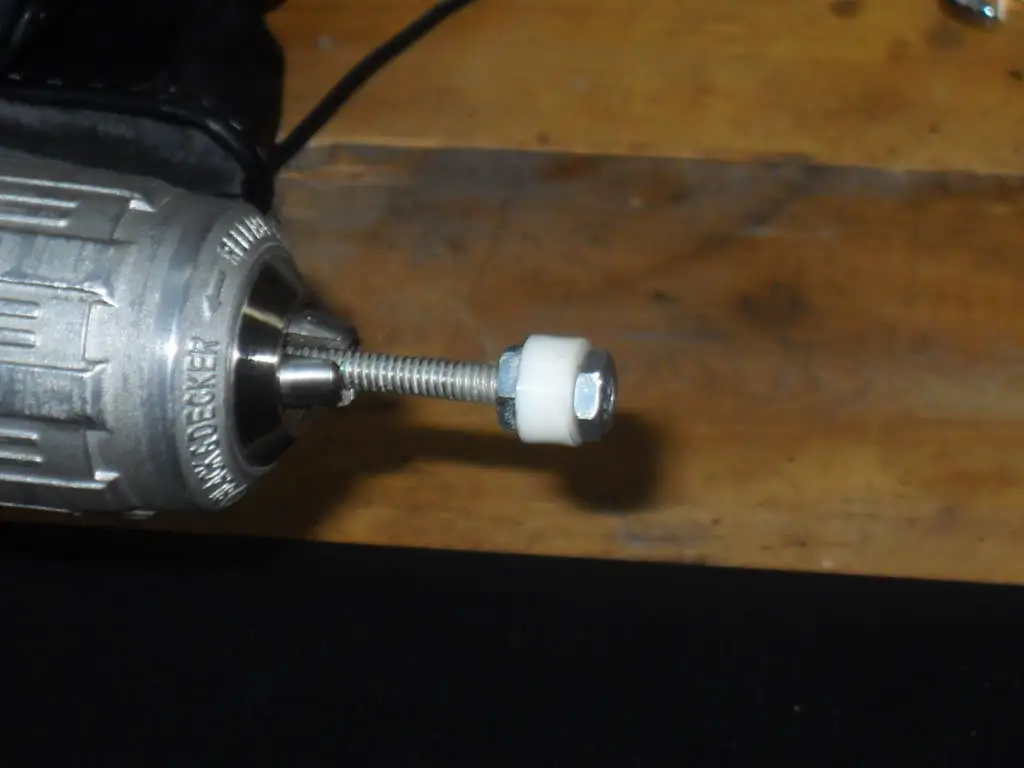

The bushings are a little to large and need to be turned down. I put the bushing on a small machine screw and spun it with a drill against a strip of emery cloth. They ended up measuring .480" after I finished.
I made sure that the fit was very tight as any slop wold have the gears wear more rapidly
One of the other things that I want to suggest is that when you try to install the repaired window motor the shaft coming from the end of the gear has to fit into a hole in the inner door. I had a difficult time getting the motor to line up. So I put the three screws in just enough to hold the motor on and held it as close as I could where it needed to be and then I bumped the up button until I felt the shaft fit into the hole and then tighten the bolts. I have to say do not use the down button or you'll risk some injury(Don't ask me how I know).
