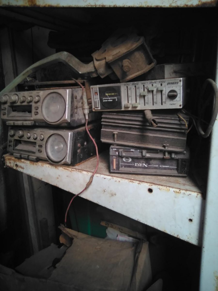

I'm going off topic a bit. I spotted my old Super Tuner that quit working and another one that I picked up for parts. That might be my old late 1970's 8 track tape player too. I wore out a RUSH 2112 8 track with that thing. I may add other pics to this post through the day instead of it bumping to the top constantly.
Seeing those 8 track units, first thing to pop into my head is the old K-Tel records commercials.

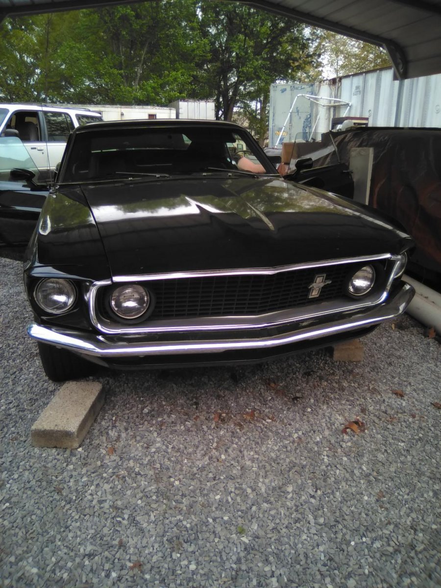

The month of May was spent on the 1969 Mustang 351 Windsor 4 speed car. It actually VINs out as a Red Mach 1 but the owner wanted it plain black and had a body shop do it as such. We installed the interior and mostly all new wiring. Located rare AC ductwork pieces. Sourced good used individual instruments to restore his instrument cluster. The car is badazz with the 10.5 to 1 compression 351 Windsor and a 4 speed. I got to drive it back to the owners house. I was baking in the black on black interior car and brought back memories from 45 years ago when I had a '65 Mustang coupe, 302 with a 4 speed. Neither car has/had working AC. click on this link and scroll down to Album 1969 Ford Mustang. This Facebook page is our work Facebook page. Me and my brother do this as our day job. We bought our first Mustang in 1973. I was 14 and he was 12. It's been a few years. Ala-Tenn Mustang on Facebook Picture taken in front of RaceTrac gas that has 111 octane fuel. The Dragstrip is 5 miles up the highway. The owner has 107 octane in it now.

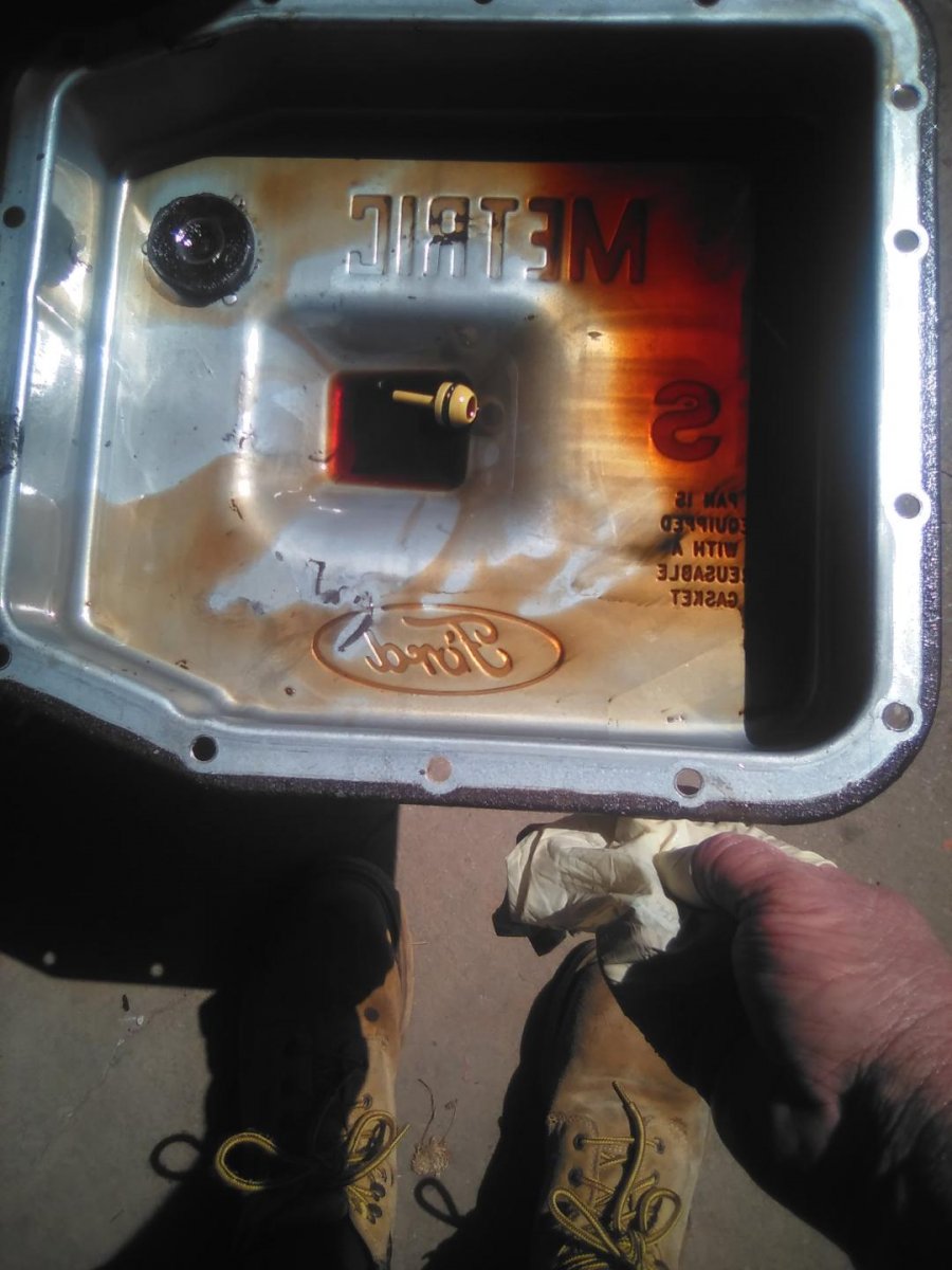

3rd. Transmission pan before cleaning. 250k miles. Very little metal on the magnet. The fluid is more to the red side than burnt brown.
I'm going to reuse the old fluid and top off with about 12 to 16 oz to make up for loss. I didn't want to spend $40 to $50 on new fluid
possibly causing the fluid to "wash" the transmission leading to earlier than later failure. The tell, tell piece is in the pan. It may not have
been removed before.

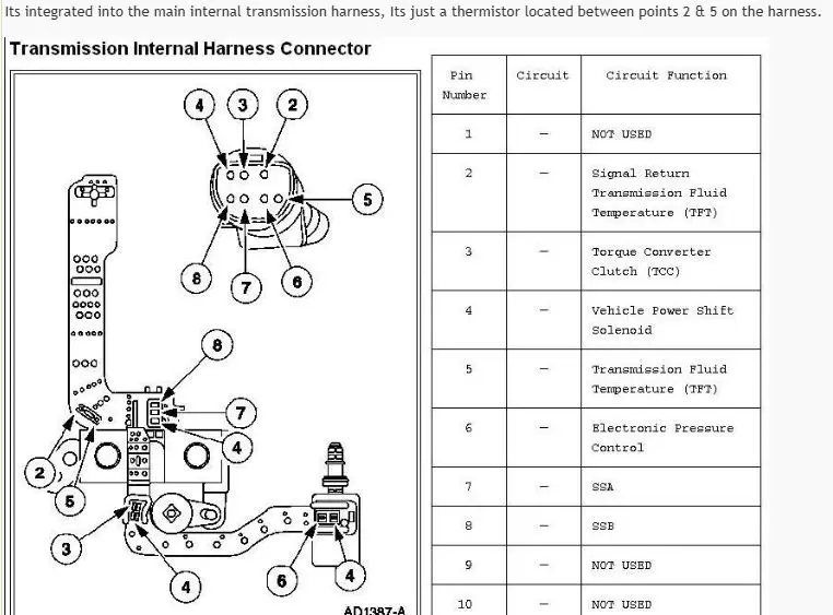

So far I have determined where the 4R70W transmission temperature sensor is on a 1999 Crown Vic 4R70W.
