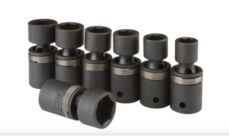

Saturday, I picked up a 7-piece set of Metric 1/2" drive impact swivel sockets.
& piece metric swivel set damdest thing, no 16mm in the set.

No 16 because they want you to buy the standard kit that comes with 5/8”
I hate that crap

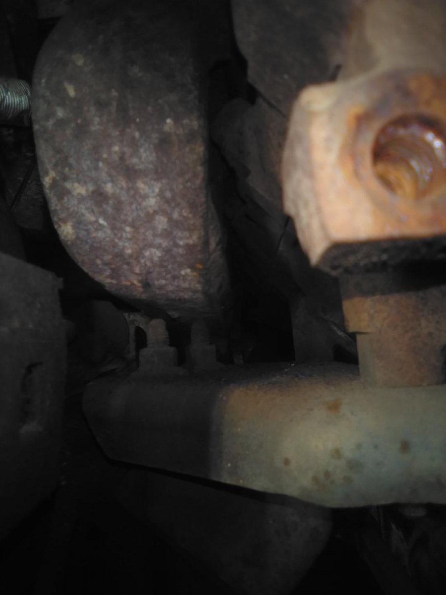

Bottom of manifold touching excess engine mount stud/s.

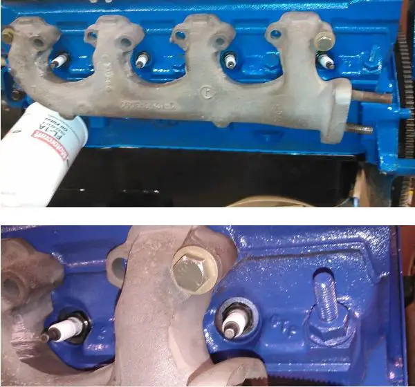

Below there are two pictures of the left hand 1996 F-150 manifold. It came with a big threaded plug to fill that hole. I assume it is for the EGR.
I'm considering drilling and tapping the plug to a 18mm hole in it to install a wideband O2 sensor to use with an AFR gauge and tap into the signal for Real Time tuning. I was wondering if this location is too close to the head (exhaust ports) and would have a tendency to get too hot and lead to premature failure of the wideband oxygen sensor. I will add an extra bung that could be plugged for now and used later if the manifold location doesn't work out. On the side, you can see the gum drop shaped piece which the steering shaft bumps.
Close up view.

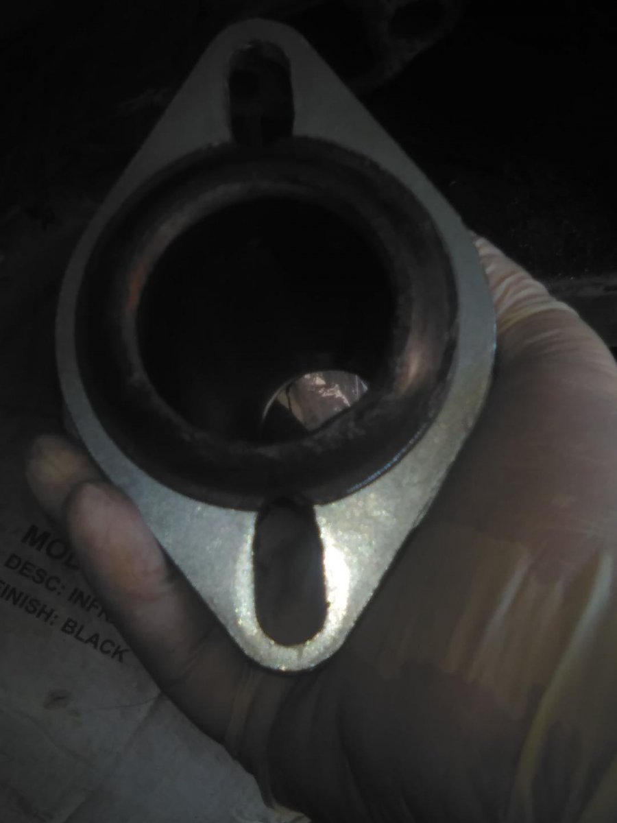

bride plate slotted holes more inboard to fit the M II manifold. Coincidentally while this project has been going on, I stumbled upon this
steel doughnut gasket that is two different sizes. One size fits the manifold and the other fits the 2.25" pipe. I didn't even know that I
possessed this part and found it while moving some other stuff.

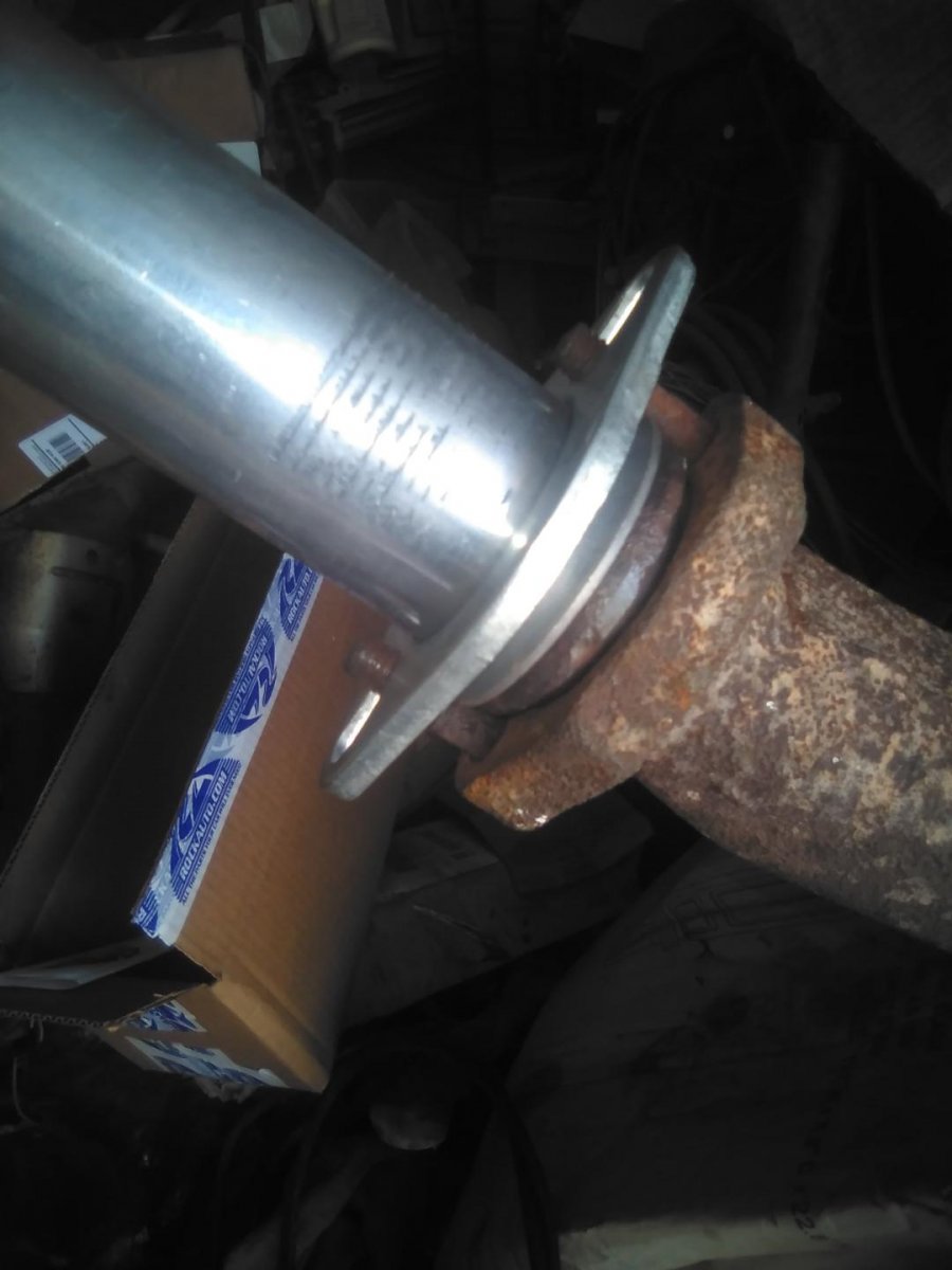

Flat flange and pipe.
Mustang II manifold and pipe fitted.

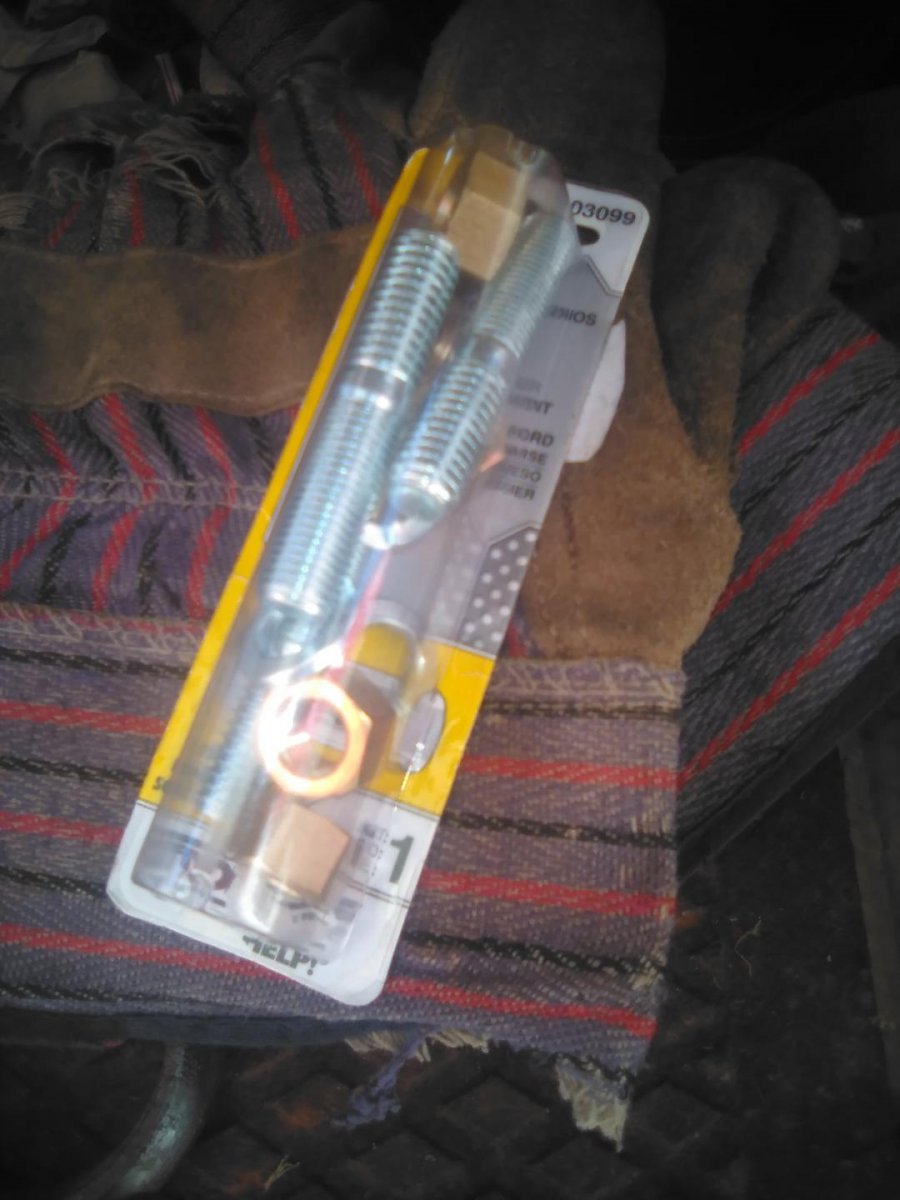

ADDED 45 mins later. 2 wins. AZ parts got here when they said the would and they fit what I am working on.
Came with a 3rd stud !

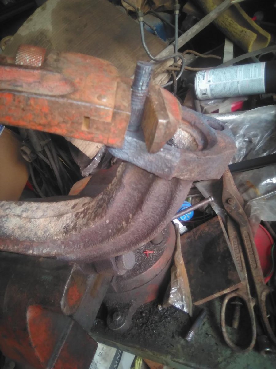

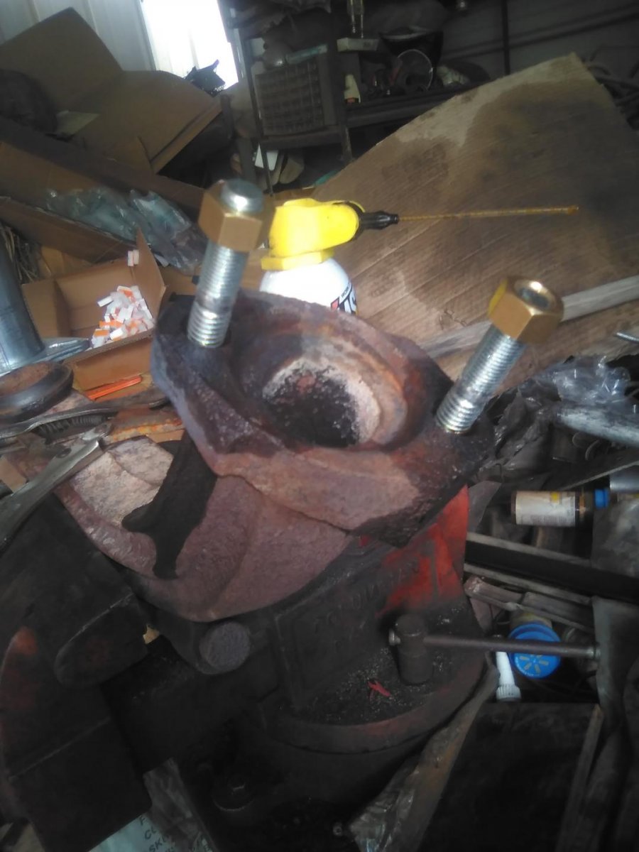

The right hand manifold needed the two studs removed and replaced.

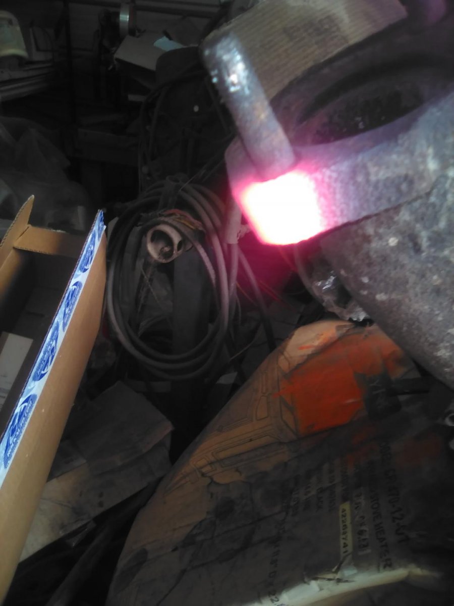

It took a pipe wrench for the 2nd stud. This was a hot procedure. The 42" fan had to be off during the heating process.
Studs installed. Link to complete process. seized bolt and stud removal. Threads were lubed and tapped before stud install.
