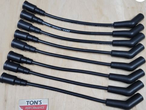

Months ago, I purchased LS coil boot set to install on some shortened Explorer wires. The more expensive Motorcraft set that has the correct heatshields. Now that I have removed the factory headers, they will no longer be correct. Also, the LS type coil connector is different that the "Godzilla" coil connector. Both manifolds use wires with 45/135 boots on the plug end. The "Godzilla" wires have a hard metal 90 degree boot on them and don't fit the 5.0 well. I found a company on Ebay that is called Ton's Performance. They have aftermarket wires for the 7.3. They have the 45/135 boots or close to that and are 11" end to end. I have a set on the way from Houston. They may have a slow start coming out of there.
I think these will work.

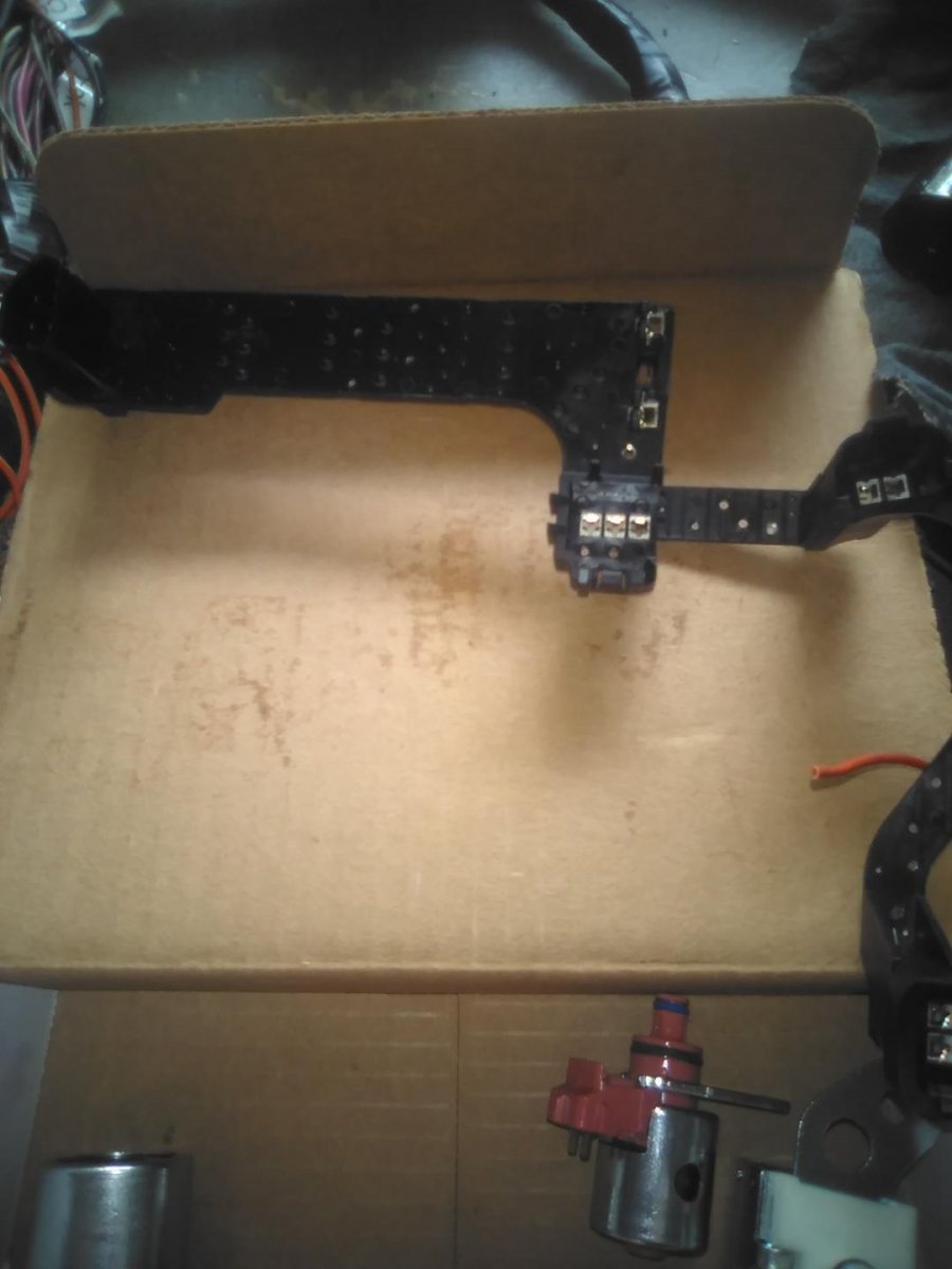

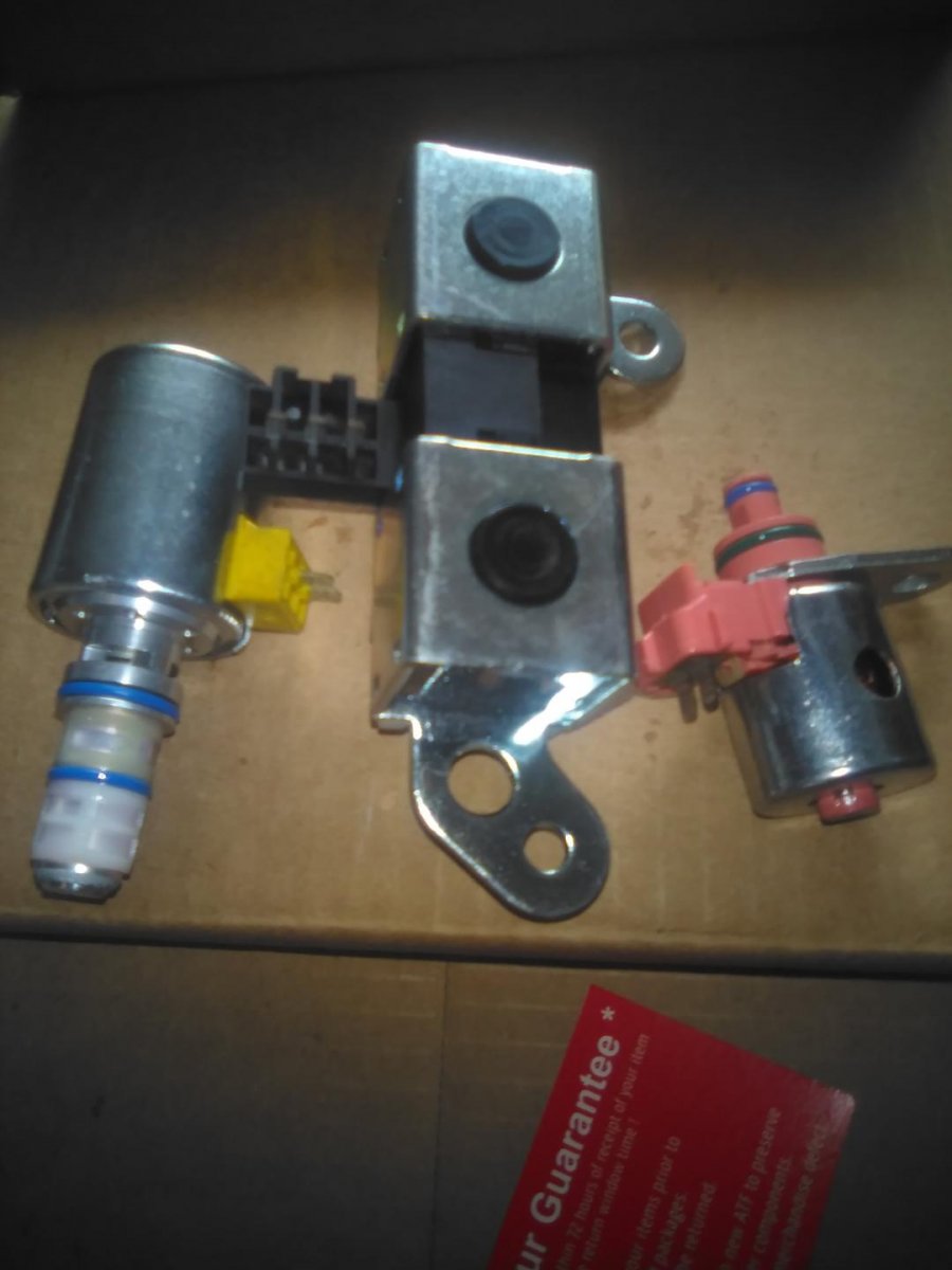

I got back into the transmission today. I have the uppermost solenoid swapped out so far. In the morning, new seals will go on the shift
lever piece through the case then swap the other two solenoids on the valve body and snap the hardwire bridge to them.
Hardwire piece below.

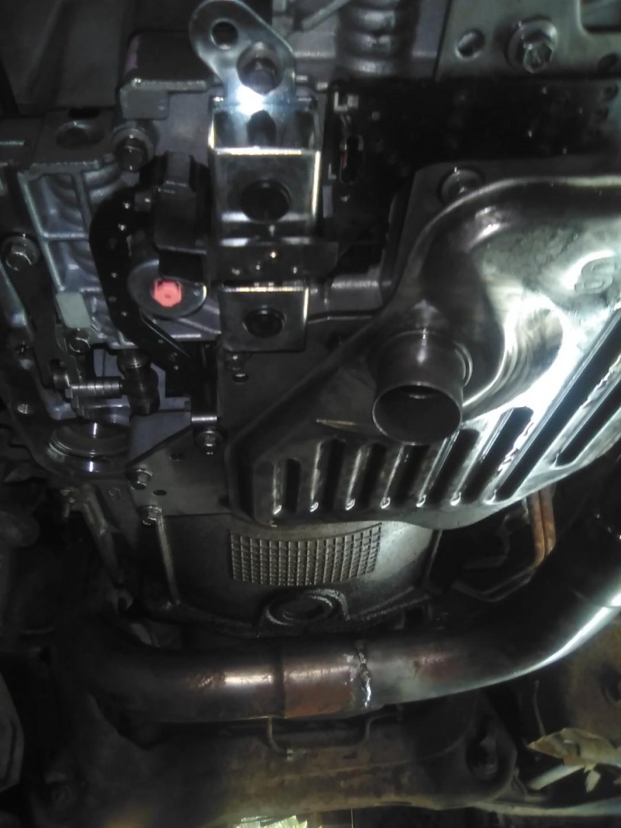

Here is a picture of the transmission work completed and about to close up. I'm waiting for a 1999 DTRS to show up. That is part of the upgrade from the 1997 way of doing things in the 4R70W to the 1999 way. I'm referring to the solenoids and the Digital Transmission Range Switch.
Pan is now on.

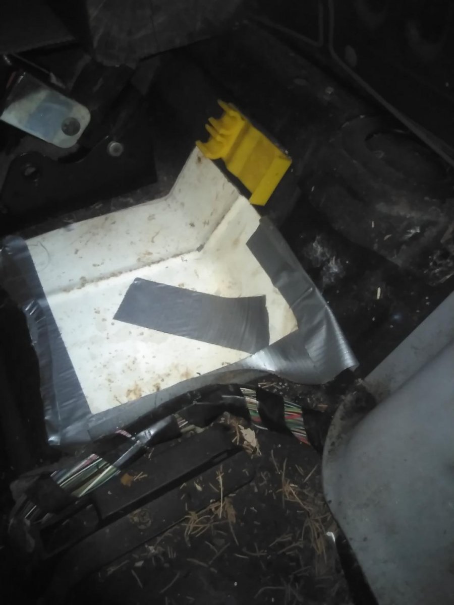

I was vacuuming under where the left rear seat would be and see the fuel pump access block off plate that I made when the truck first broke down. My first thought was the fuel pump went out.
Nope! That wasn't the problem and I never cut the hole. Maybe later.

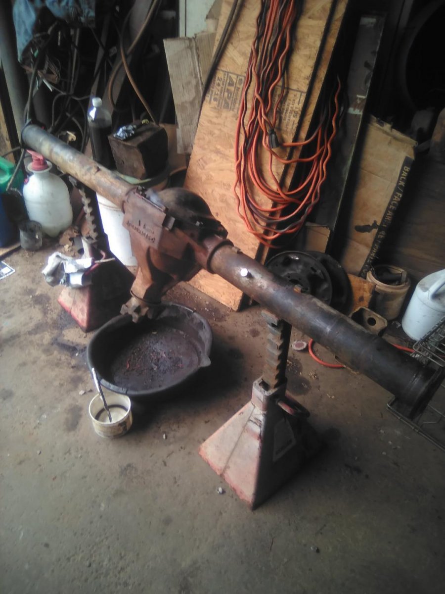

Here are pictures of the 1967 Mustang 7.25 inch differential. 1st pic is after scrapping off dirt, paint, grease and finishing off the scrubbing with
"God's greatest grease cleaner". It's good stuff. 2nd picture is after sandblasting. The housing had to be blasted outside with a stand alone machine. We have an idea in the works to make our "Econoline" brand media blast cabinet bigger to hold rear end housings.
I did one last scrubbing around the ends before blasting.
Differential painted. Brother picked up the ready axles from the machine shop. They removed the old and installed the new bearings and retainers. ~ $66 with tax. Tennessee charges tax on labor too.

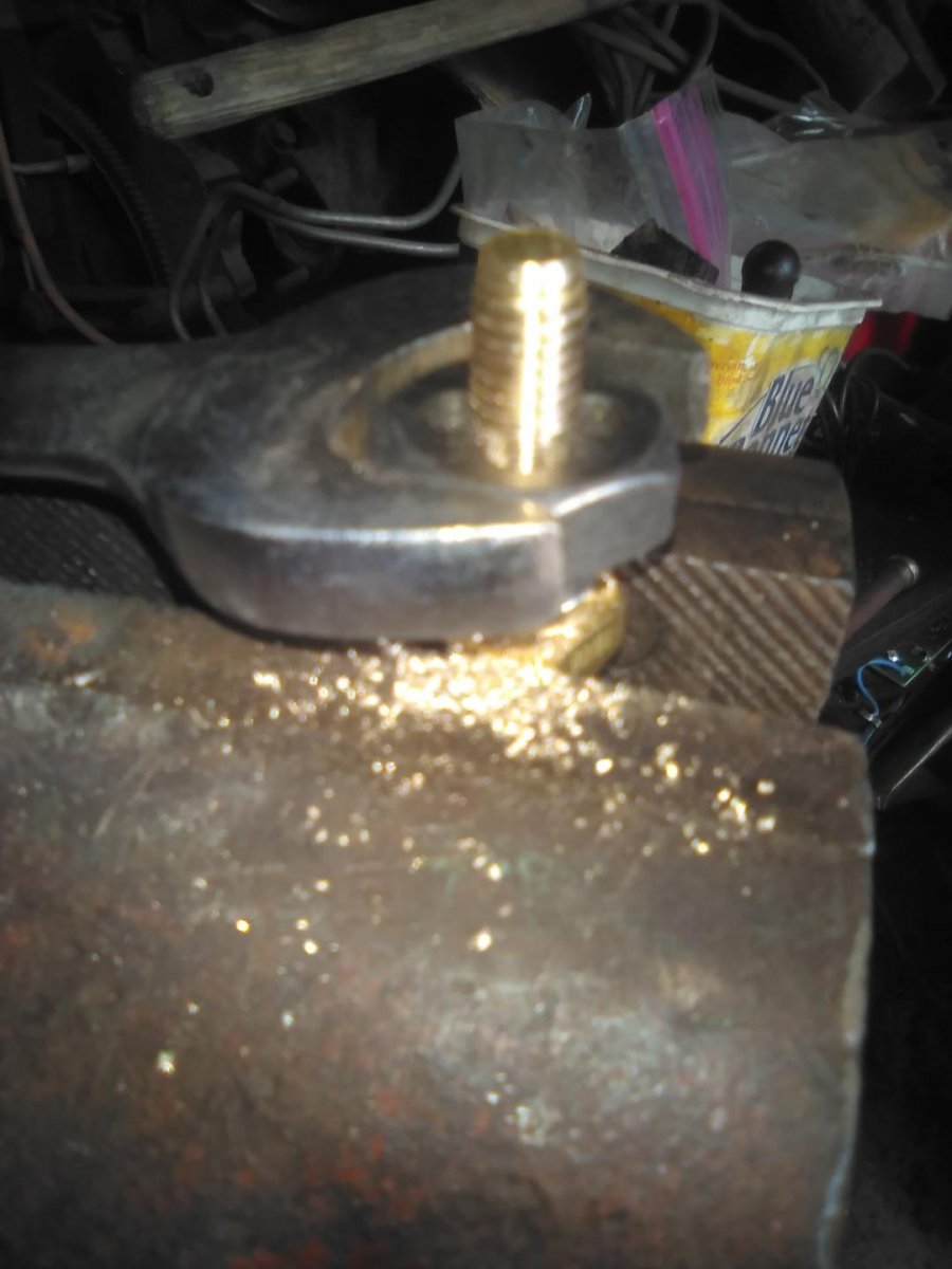

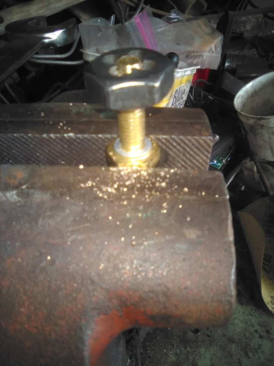

Over the weekend the CHT sensor and CHT sensor connector from separate suppliers showed up. Midafternoon today, the 3/8"-16 tap
arrived for the '97 MM 5.0 to cut the 10mm threads down to standard 3/8" threads. The CHT sensor is now in the back of the drivers's
side cylinder head. But first I had to cut it.
The shavings look like gold.
