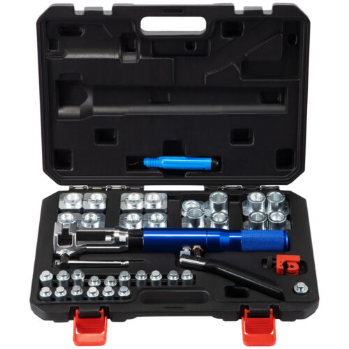

Yesterday I finished up the ABS bypass. I had trouble with my Vevor hydraulic flare tool. It doesn't have 4.75 mm pieces in its kit, so I went to AutoZone and got the loner tool kit foy metric size lines. 4.75 mm is .03 smaller than 3/16" line. I don't know if that was the main issue or not but my 3/16" die would not hold on to the metal line without it slipping in the tool. It is back together and holding with no leaks however I'm not happy with the results. I couldn't quite get a good bubble on the back line and the Vevor tool didn't have quite enough working room under the hood with everything back in place. Today I'm going to stand on the brake peddle and have brother look under the hood to make sure that there are not any leaks.

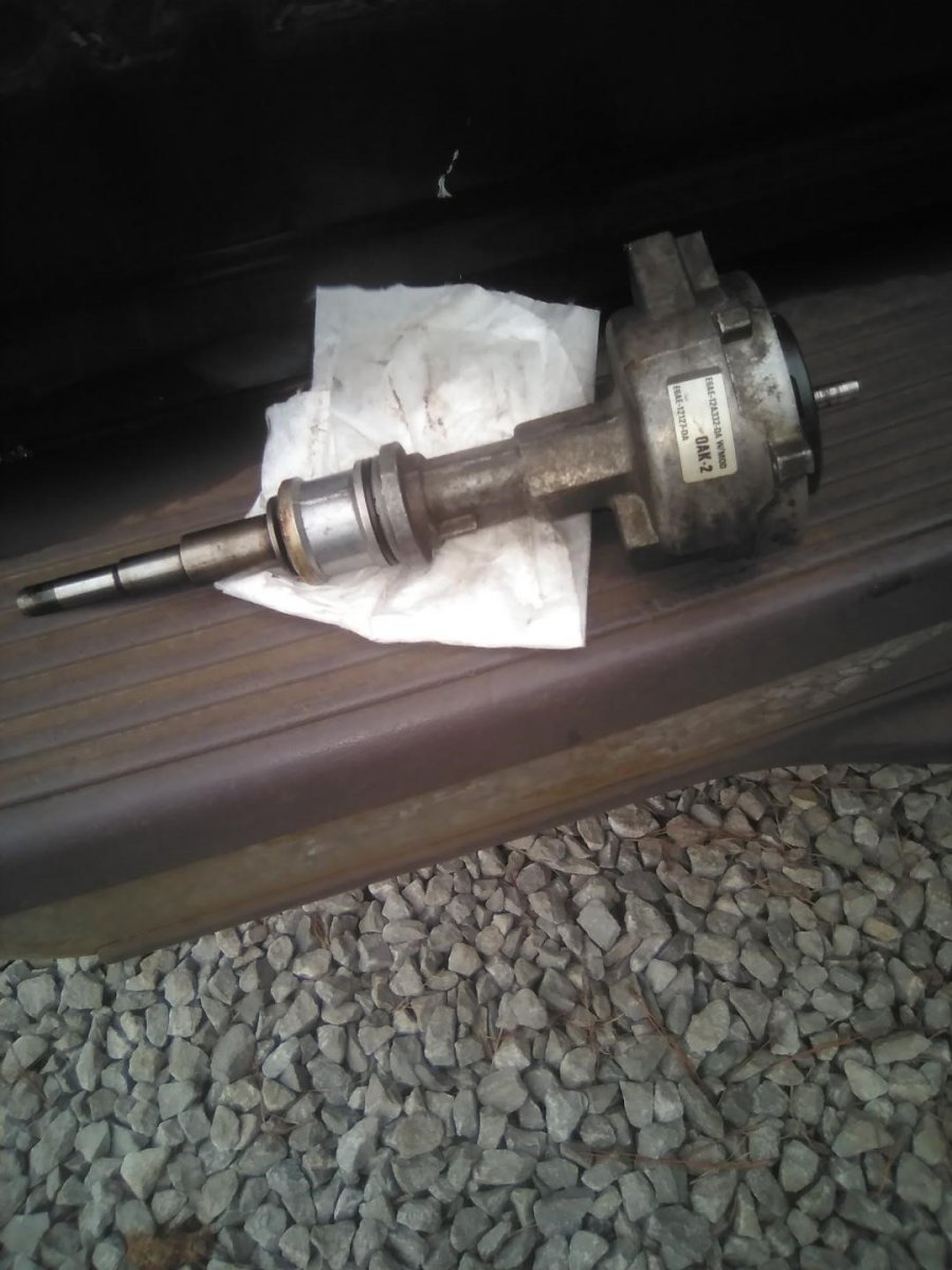

I'm unable to get the starter to engage from the key switch. I need to test the three sections of wiring that have the starter solenoid trigger wire running through them. Finally, with the PCM relay back in place and the inertia switch reattached, I can hear the fuel pump prime for a second like normal. However, with the key switch in the run position and energizing the solenoid, It turns over but will not poof, bang or otherwise. I also plugged in a noid light to the #1 fuel injector circuit and I'n not getting power to the injectors. The PCM condition is unknown. It is a 1999 Crown Vic P71 cop car piece that had been located through an online service, car-part.com, for $50- + shipping, shipped directly from a salvage yard. It is entirely possible that it is a bad unit however the ARA3 bin file that I copied from it is intact and can be written to another 1999 CV PCM. The bin file is worth what I paid for the PCM even if the PCM is bad. I do have a known working PCM from the Crown Vic that work several years ago when I first started the old 4.6 to hear it knocking. Later this morning, I will be writing the ARA3 bin file that has the PATS feature switched off from the factory to this other PCM. That might be the problem. If it is not, the first place that I will be looking at on the 104 pin connector wiring is anything having to do with the PCM power points. There were at least two changes between the '97 MM and the '99 CV PCMs. I may have disconnected a power wire for the '97 MM that the '99 CV didn't use but not put power to it another way. I hope to find an extra power wire that I may have insulated and folded back an extra power wire to get wrapped up in the main harness. There were a lot of wiring changes between the two vehicles. I really did expect at least a poof but I'm clearly not getting power to the injectors. I haven't rigged up a dummy spark plug to one of the coils to see if I'm getting spark. That logically may be the next step however I already have the first PCM disconnected and out of its pocket and will just go ahead and follow through with the PCM swap. Later this morning, I will know more after I can lay hands on it.

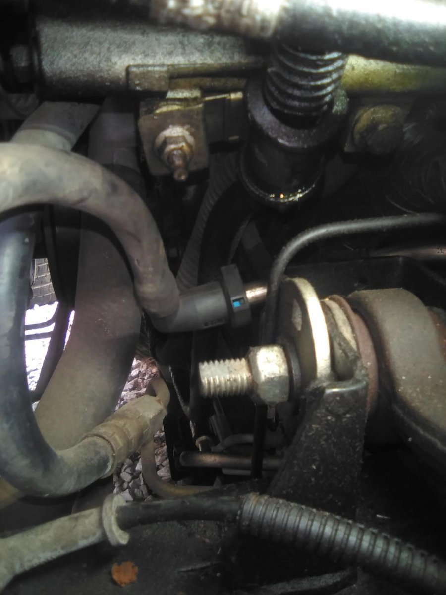

It just occurred to me that the used electronic piece of the 2-wire camshaft position sensor is of unknown condition too. I have 2 or 3 more of those that I can swap out and try early on while I'm trying to track down the no start issue.

It has started. Bad cam ps. After changing the cam ps, the Injector noid light was lighting up. Also, inline spark tester tool lighting up. After fuel pressure it started and ran. Filling up radiator now and just tightened the two lower fuel line connections.
