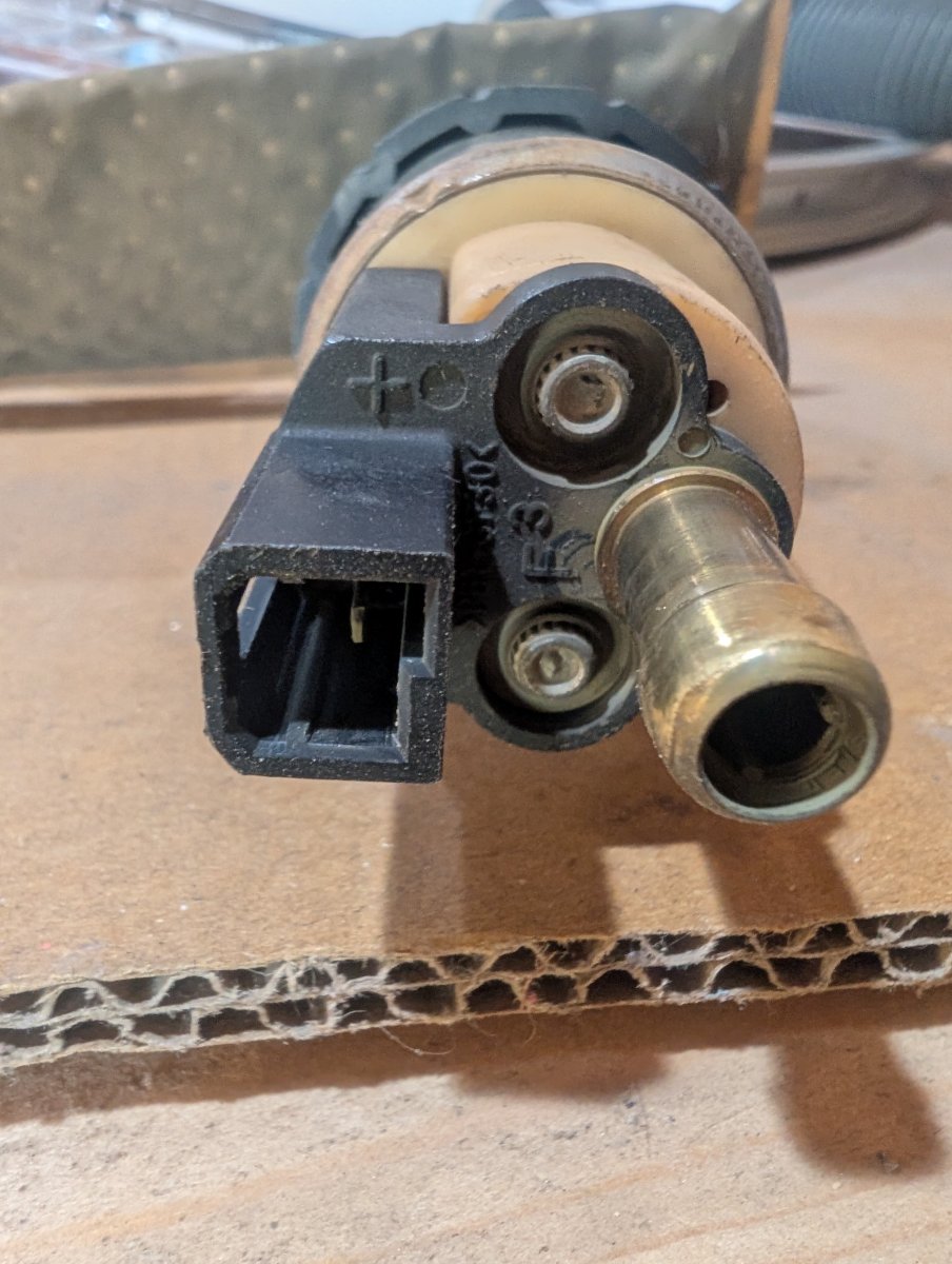

I think that I found my misplaced new gen 2 fuel pump.
@410Fortune Jamie, does this look like the gen 2 connector? I haven't opened the tank yet.
Looks about right. Here's the original from my '00:
Thanks for the info.
The fuel pump that I have is not the right one for the Mountaineer. I have another on the way.
