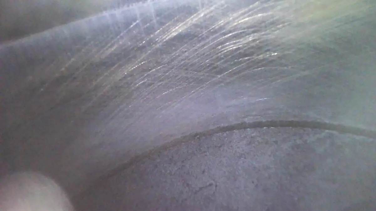

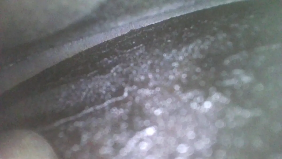

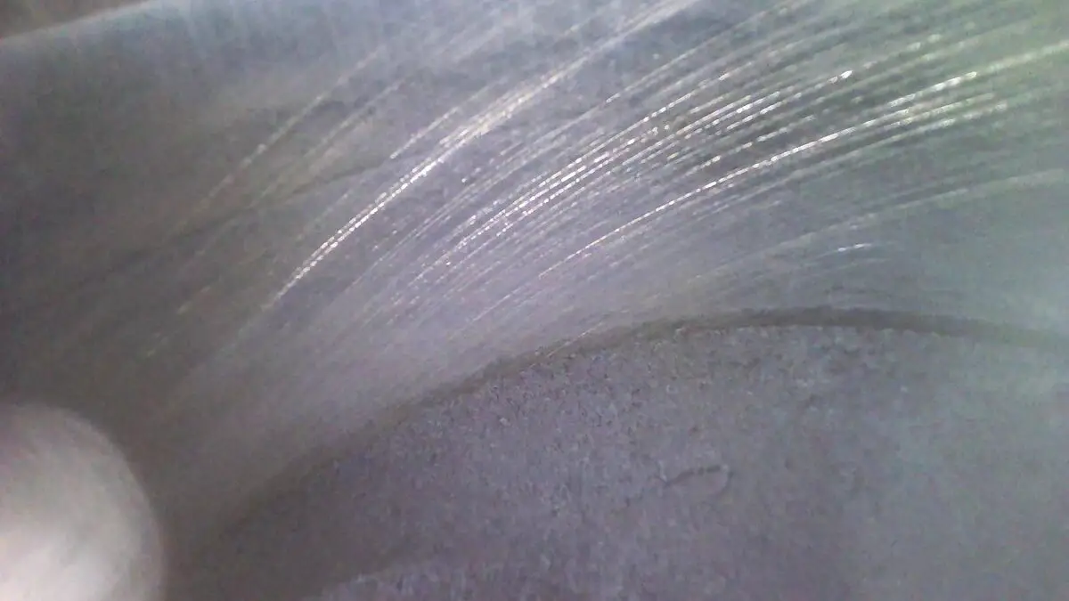

The Valve seals were supposed to be the turnaround point in the project. After seeing the thermostat today I'm considering pulling the timing cover and the oil pan. At 253k Maybe I just need to do the oil pump, oil pan gasket, motor mounts and timing set while I have so much of this EX apart. Really wouldn't be much after that.
Here are some pics I took with my HD borescope. Mild amount of carbon and still have crosshatch on the cylinder walls. This makes me happy.
