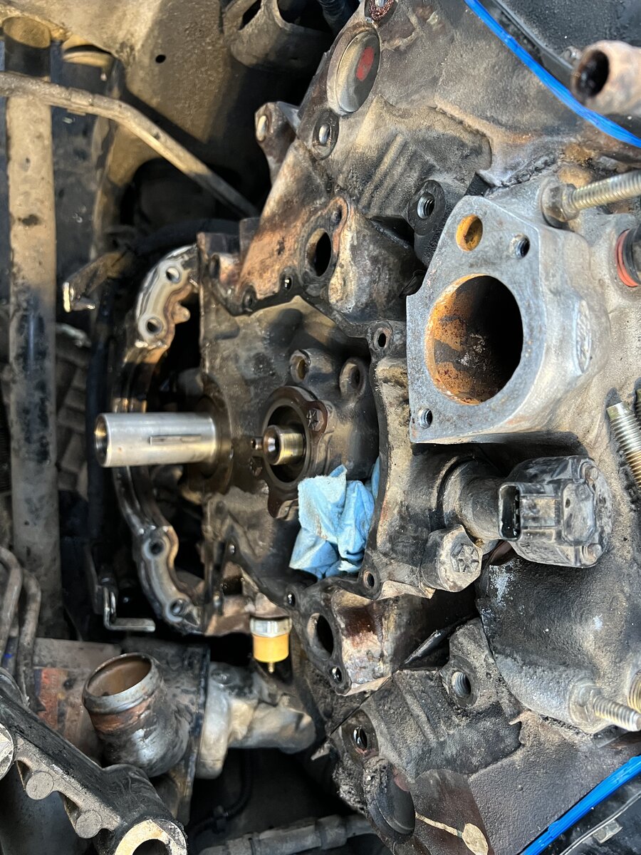

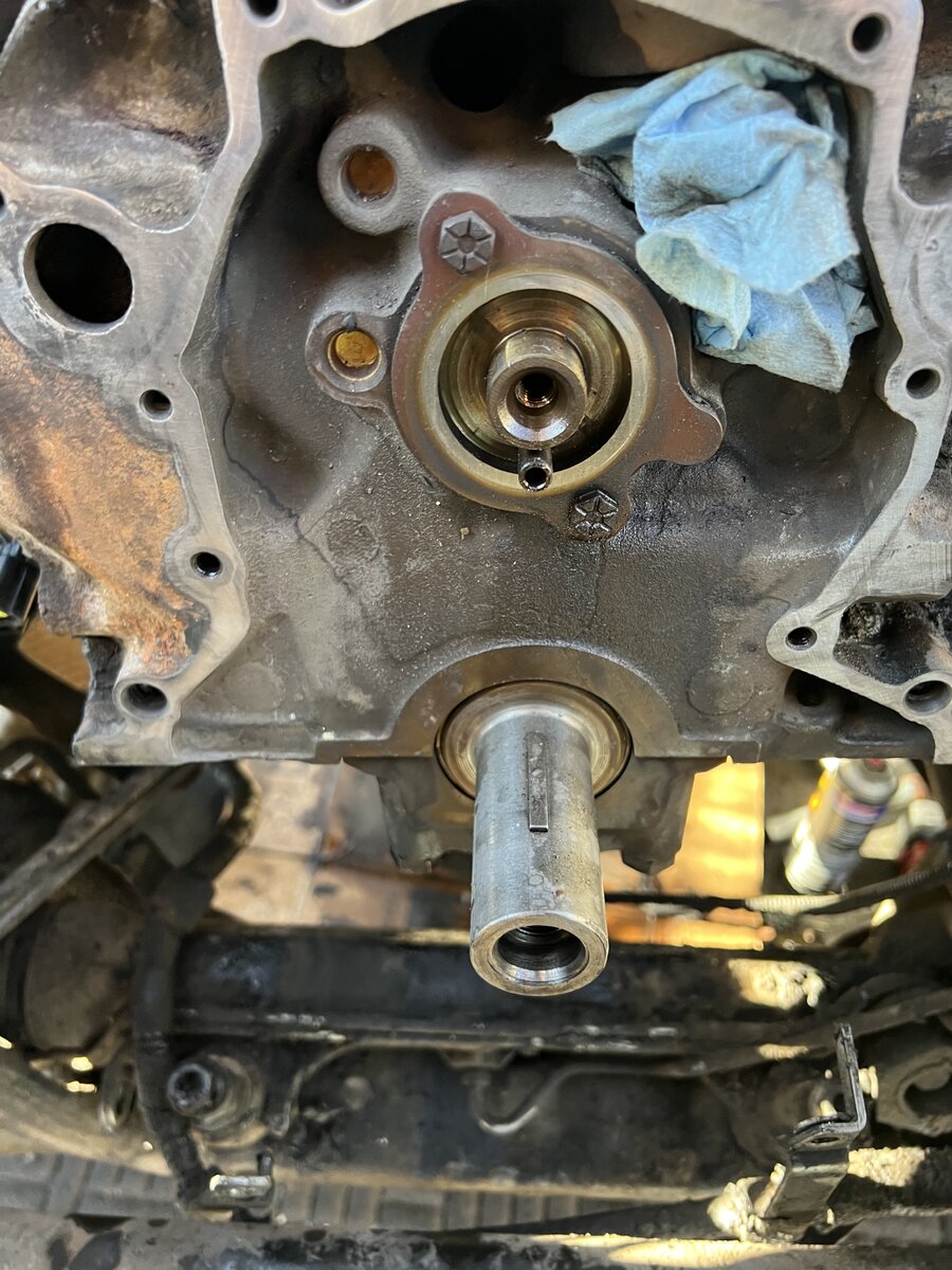

I coated all of mine with anti-seize. The reason they seize up in the holes is due to the corrosion of the aluminum along the bolt shanks, over many many years. The air in there provides the moisture needed to create the corrosion. It isn't from coolant reaching the bolts, those holes are blind, or should be.I would chase all of the threads on that timing cover
You are supposed to use thread sealant on the threads of the 4 long bolts that go into the water jacket
I usually drain the oil and leave the plug out while I do the timing cover

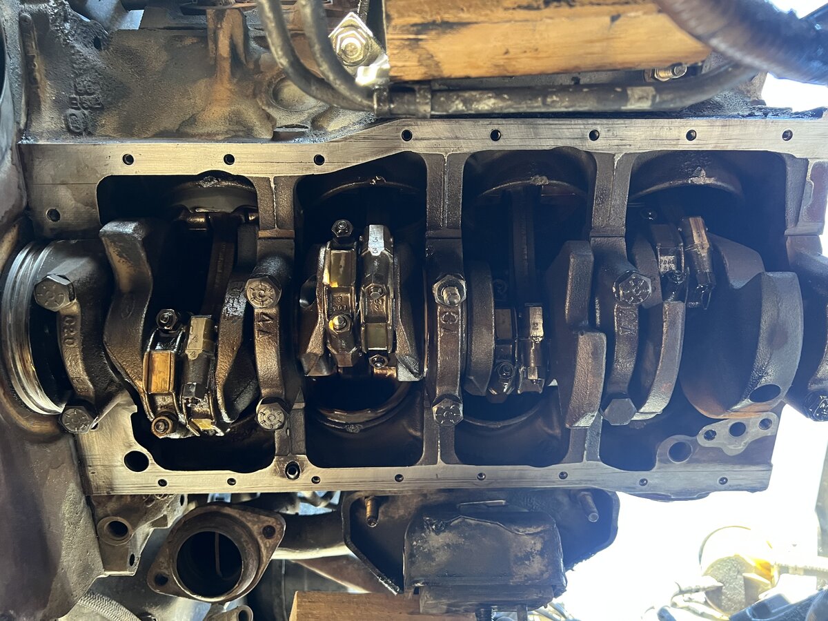

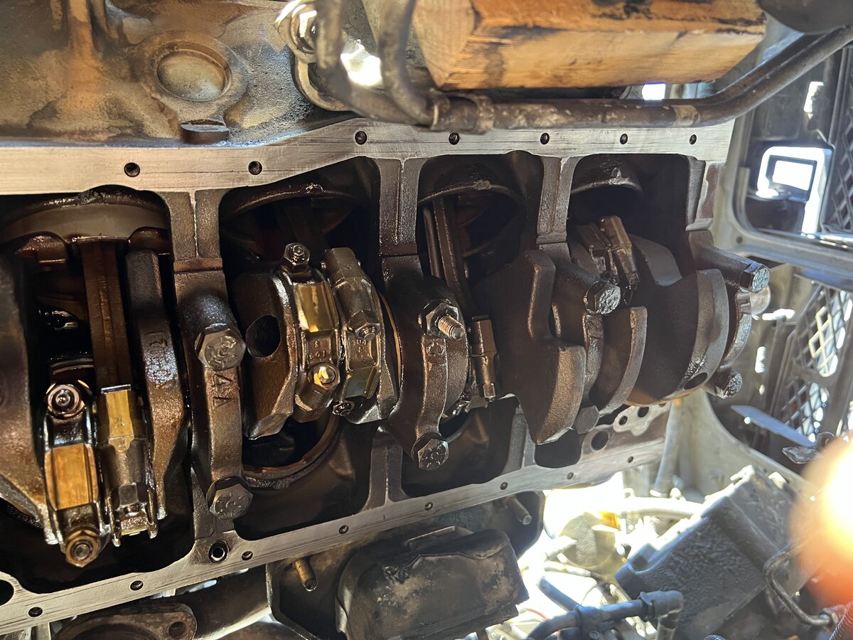

I’m pulling the oil pan today. I’ll put the chain and timing cover on before I put the pan back on.I would chase all of the threads on that timing cover

Hahaha. I thought about it. But I did run the truck before I started all this and despite the lack of maintenance it ran pretty good.are you tempted to pop a cap and gander @ a bearing?
Either that or an employee swapped it. Seen this crap plenty times before.Someone returned a timing chain, and it got reshelved w/o looking @ it?
