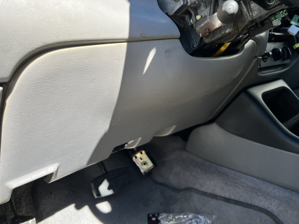

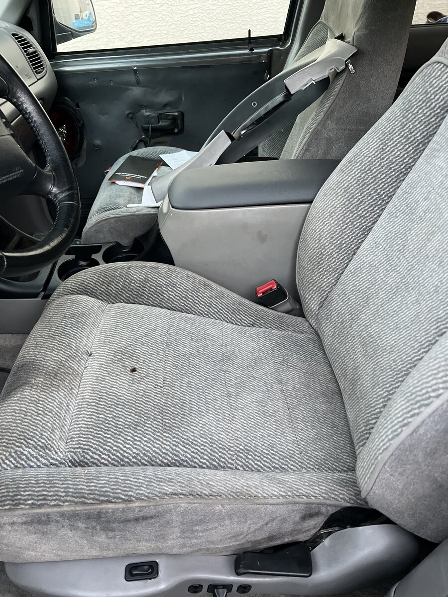

Front seats are done. Cluster trim and knee panel are done. New center console lid installed. Getting closer.

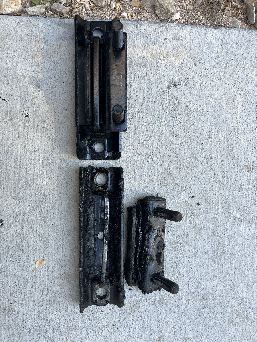

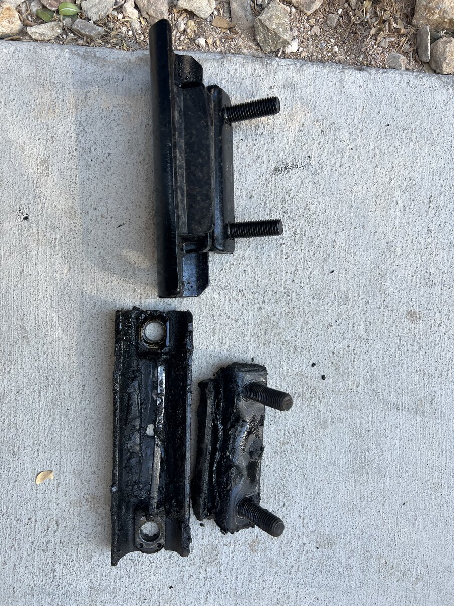

Took some time to replace the trans mount today. It needed it.
