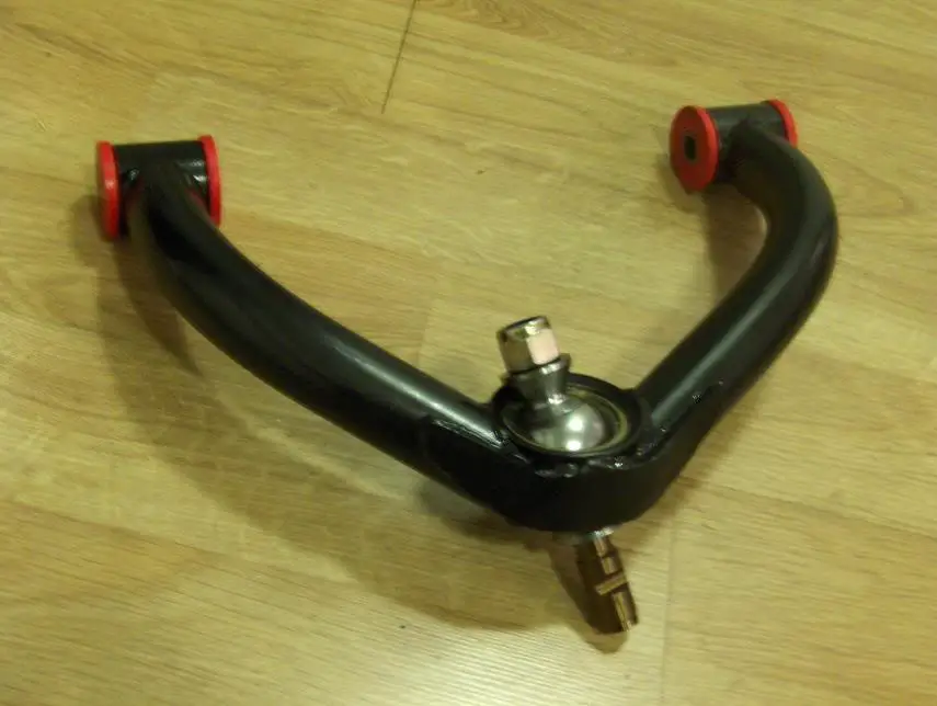

- Also, are there upper arms I can purchase somewhere that would work with my vehicle, or is it something that I will need to get fabbed? I would definitely like to do it right the first time with heim, etc. so if custom is the way to go then I will move forward with that. actually a big reason why I want the upper arms isnt just for the extra inch or so of travel but so I can get the tires aligned properly

If you are going to have new UCA's made do not stick with balljoints. Go with a uniball or heim joint and you will need to replace the bearings every 5 years maybe with just street driving. If you have an UCA made and run 3/4 heims on the frame pivots you will never need alignment cams again. You have an un-plated washer welded to the UCA mount ears so the bolt can never slide and all of your adjustment is through the threading in and out of the heims.
Hey dan, thanks for the heads up. I believe the upper will be a uniball, BTF-fab. still haven't hit up robert though, but BTF said they could have the uppers ready next week. Im going to get these uppers, (no heim though) then get the moog joint for the lower arm/spindle. not sure if I will still need the alignment cams at that point or not, will cross that bridge when I get there I guess. I got to take this one step at a time, Ive learned. Any more than that and its overwhelming how much cash Im gonna fork out lol. thats part of the fun though
No worries. You you dont even wanna know what I have spent the last month just collecting parts for my new front end. Let alone the 4 link and the motor work. It's disgusting, haha. And BTW, BTF does go stuff. You will still need alignment cams for Brandons uppers if they're not on heims.
