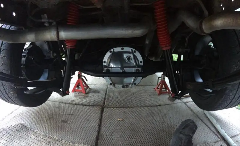

Oh, and one more thing I forgot to mention; the rear end cover from a GT500 fits, if you are willing to remove the inner cooling fin to clear the Explorer's toner ring for the ABS:
I've been looking at that particular cover for quite some time now but was not sure it would work with the Explorers 8.8 differential. How much trimming would be needed to get it to clear the toner ring.
Pretty much the entire fin has to be removed and smoothed flat with the surrounding contour. Since it has a reverse curve, it is somewhat difficult to get in there; for instance, expect to go through a number of Dremel sanding wheels and drums, and then only wear the edges of them, to get it removed (after using a cutting wheel to remove as much as you can of course).

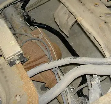

The Explorer Express rear bar is the best, the biggest made and they quite making them years ago. But keep an eye out for one, and changing the rubber bushings for any bar helps a lot too.
Addco made the biggest front bar for these, 1.5", and it's stiff(with cheap frame brackets(I had machinist make two great brackets)). Here's the EE bar from above in my 99;

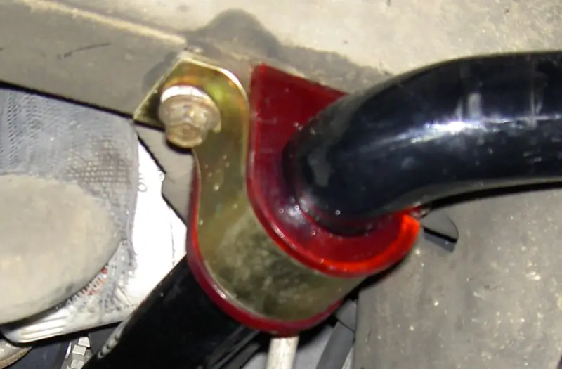

If you manage to source that saleen sway bar, i had to modify 19mm PU bushings to make them fit, i made thread about it.

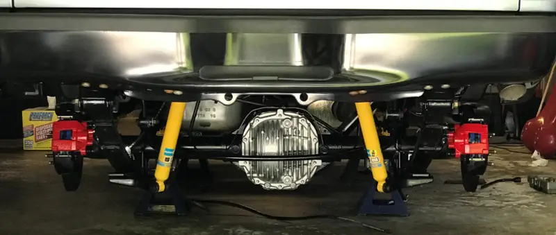

The rear of these leaf spring trucks move side to side quite a bit. Did you also replace the fifth shock back there when you did the bilsteins?
I bought all five of them when I did my Mountaineer. That fifth shock was worn out when I replaced it, and the new bilstein helped to reduce the rear tire rubbing the parking brake cable. I tied the cables inward a bit also besides routing it inboard of the V8 track bar. It all helps, reducing body sway makes them safer.
I did; the quality control on the fifth shock leaves a lot to be desired. The first one I bought started leaking before I even got the car running; and, the replacement one (a KYB I believe) just came in a plain white box. So far, this one hasn't leaked. I do know when I first took the car out, those Bilsteins were VERY stiff; at first, they had to warm up every time before the car rode correctly. Now, they seem to ride ok from a cold startup.

The rear bar needs to be as large as possible(the EE bar), or one of the lesser rear bars, with urethane mounting bushings to stiffen it more. The EE bar is just about perfect with the provided urethane mounts on the diff. My large Addco front bar I believe needs a little rubber in the end links to soften it a hair. This is for street driving of course, handling on road, not soft or off road use.
