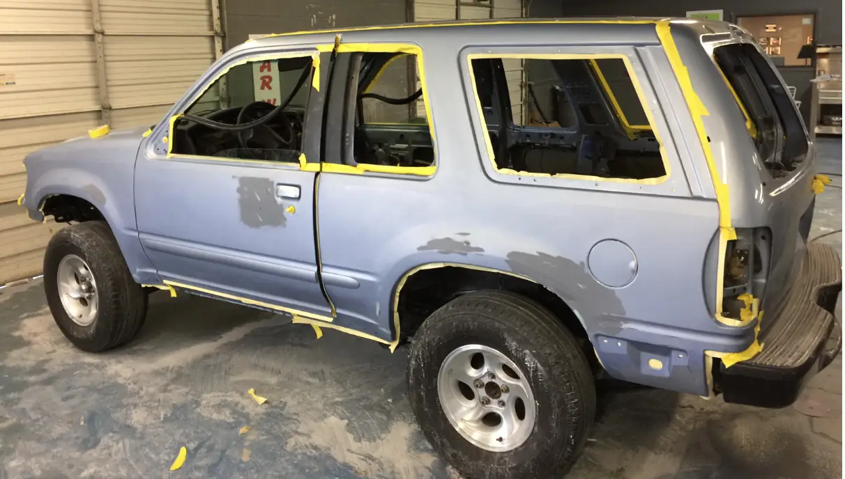

Great work, it looks so clean. How’s the paint?

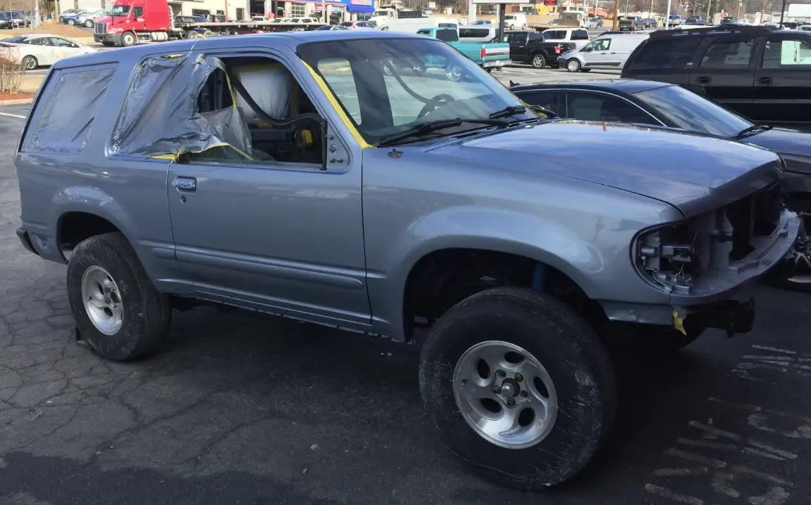

I would call the paint job a good "five footer". Not exactly as good as I was hoping (I guess we all shoot for perfection), as there are some runs here and there, but overall serviceable. What the painter did talk me into was putting just a slight amount of pearl into the factory "Light Blue Metallic" color; though I don't know how it could ever be properly matched in the case of a touchup, it really "pops" in twilight conditions. I will go ahead and post this so you guys can put it in the "Lessons Learned" register: the rocker panel trim is a real problem to remove without denting the rocker panel with the removal tool!
That's great, I like the color and a small amount of pearl does help. The factory white pearl is one of my favorite original colors from the 90's.
Matching paint is important to plan for no doubt. I have an idea for my project, that matching the paint was a thought. I plan to take the OEM Toreador red, and leave out the pearl which is a large percentage(@$90 a bottle and almost three in a gallon) of it. I'll use that as a base color, and then use it to make a mid coat. In that I'll put a measured small amount of gold pearl, and another measured amount of ALSA blood red concentrate. I'll test paint some sections of an old hood, and choose the amount of additives I like best. Then in theory the paint could be duplicated. Using easily available ingredients helps a lot too, thus the OEM base color to start with.
glad your paint shop did it the right way by taking it all apart and not leaving trim and other stuff on it. paint lines on trim or edges drives me nuts!

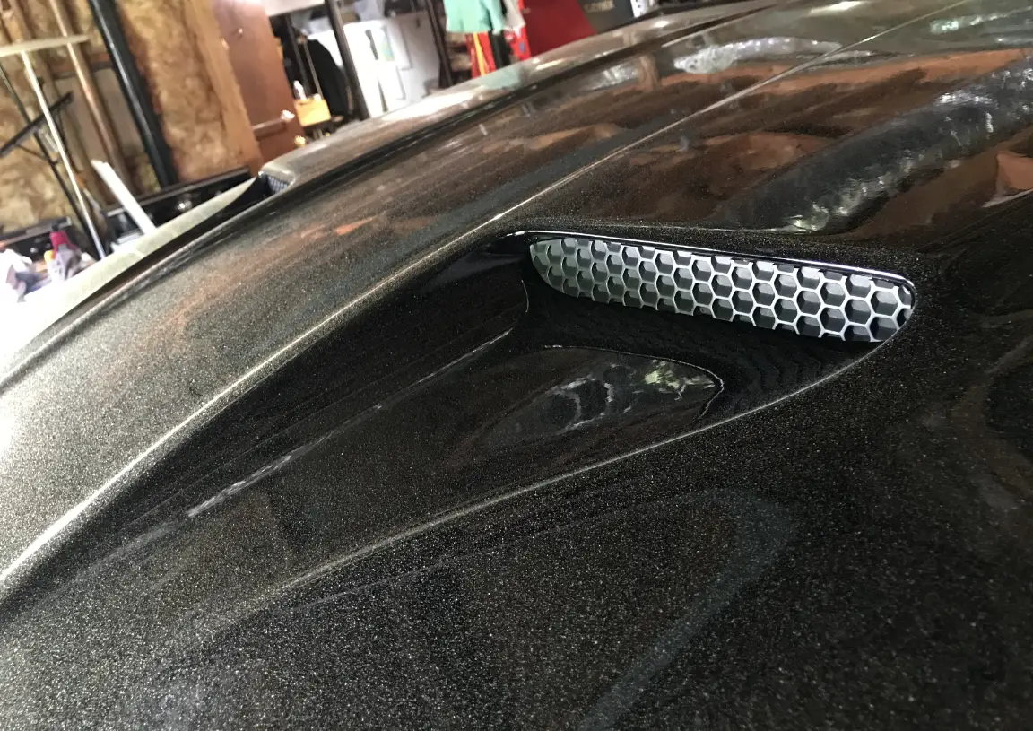

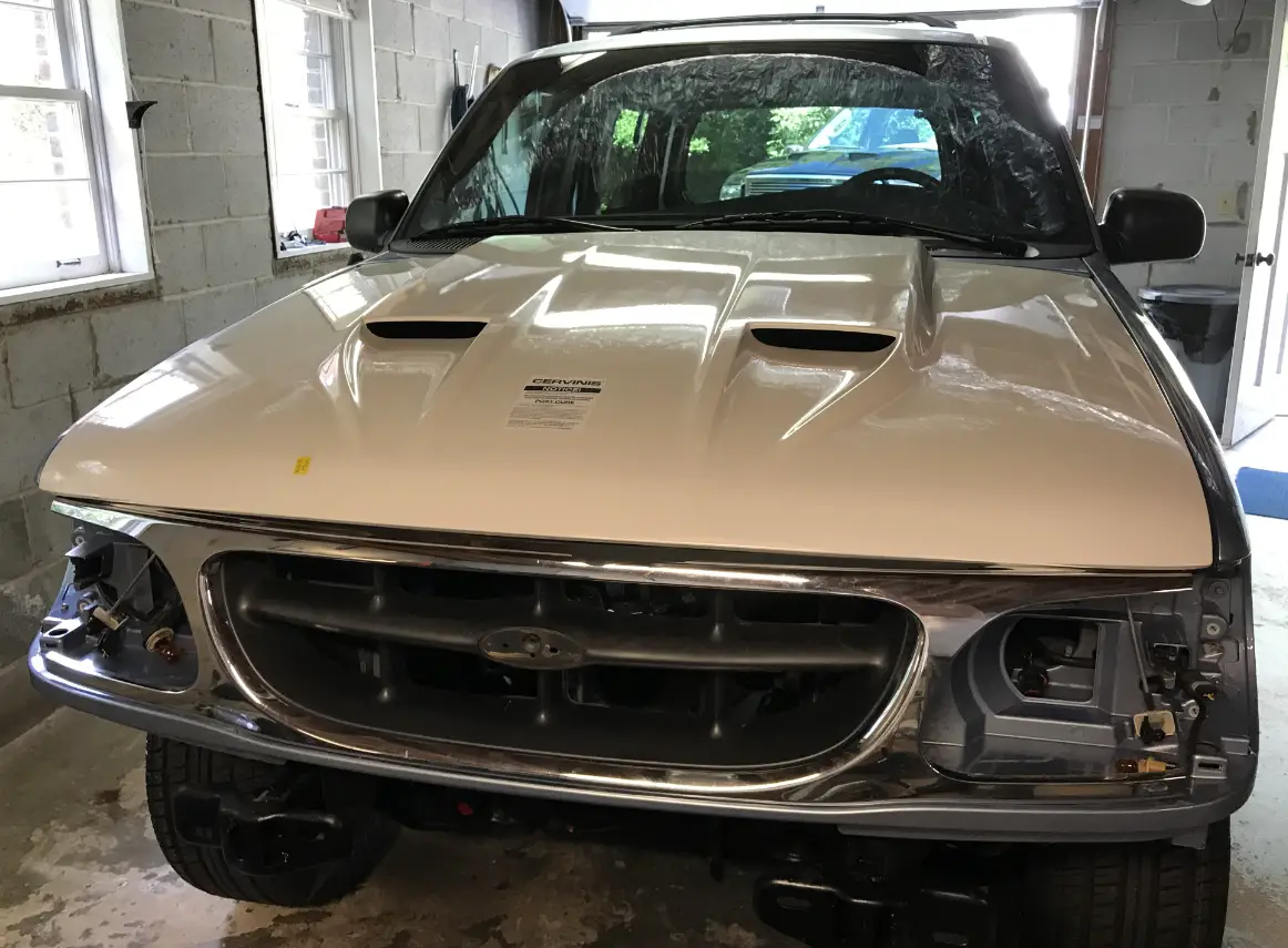

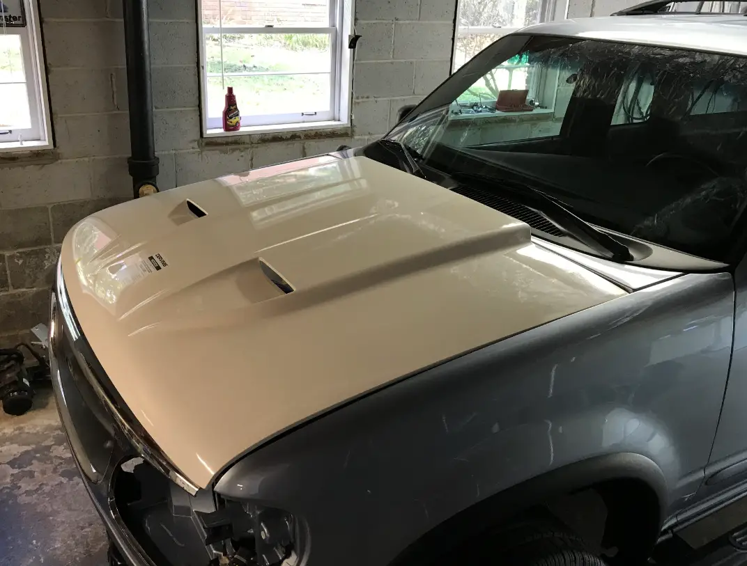

I wish I could have gotten a Mach1-style hood on it; I even went as far as sourcing one for a Ranger, but in the end it was just too far off, and I couldn't find a fiberglass man that wanted to modify it. It might have been just as well though; I imagine the cowl induction might have made a big difference in engine noise (but oh, man, it would have probably been bearable with the coolness factor of those scoops)!

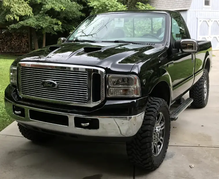

I have a similar one on my 2006 Super Duty, but the scoops on that one allow you to recess the block-off plates for a factory look. The Ranger hood makes you have to put the plates on the outside, and you see the edges. . . I've seen RC car bodies that looked more convincing! If you look close, you will see that the floor of the scoop ends at the exact point that the top of the scoop starts:
Where did you get that hood from. Shame tey don't make more aftermarket parts for the Explorer...
It is a Cervinis #119 (93-97 Ford Ranger); looks like they are on sale on their website for $500. I tried cutting some of the underside out to clear the radiator support (you will also have to replace the passenger side hood hinge with another driver's side hinge); that will get the fit close on the sides and the back. . .but up front, the Explorer hoods extend further out and are rounded. I don't know if it might be better to just go ahead and pick up a 1971 mustang hood (metal) and try to graft that onto a stock metal hood? No easy way to do it, but all metal would probably be ideal I am thinking?
