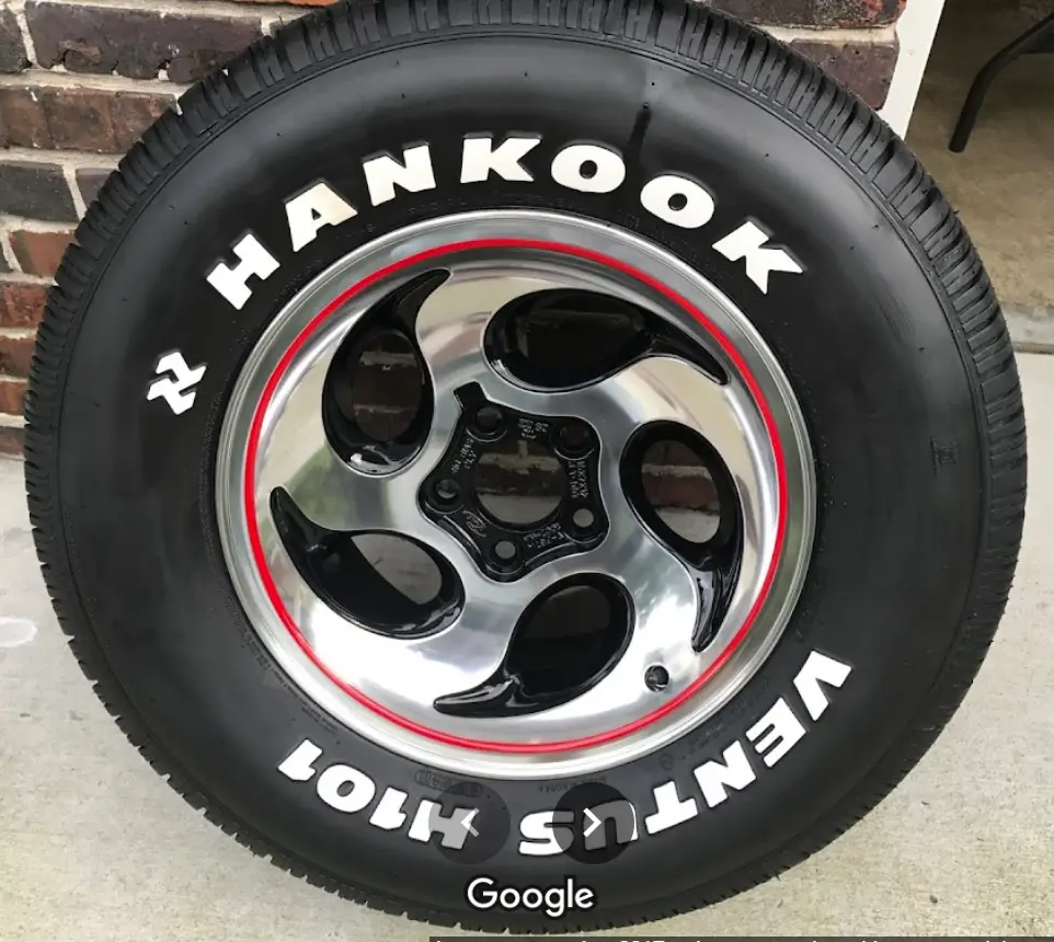

I was able to look at the thread, so I'll make a quick comment on the wheel decision history. Initially, I was running the original 15x7's and 275/60R15 tires (trying to balance tire height and width), but the tires were too wide for the 7" rims, and just didn't look right. The only choice would have been to go with a 70 series tire if I wanted to either stay with that tire height or taller, so that direction ultimately reached a developmental dead end:
The next consideration (for me at least) was to look at the 17x8" offerings; however, most of those were very "airy" (even the stock Ford offerings for other applications), and I realized that our Explorers are very poorly endowed in the brake department, and certainly not something I would want to advertise. Call me modest, but going out in public with a revealing set of 17x8 inch rims, when you are only packing 12" rotors at best (even when warm), was just too much of an embarrassment. My dream wheels, if they had ever been made, would have been the old Mustang SVO wheels from the mid-1980's in a 17x8 with a 4.5" backspacing; aerodynamic, and still with enough modesty to not give away that you couldn't swing with the Big Brembo Boys in the brake department:

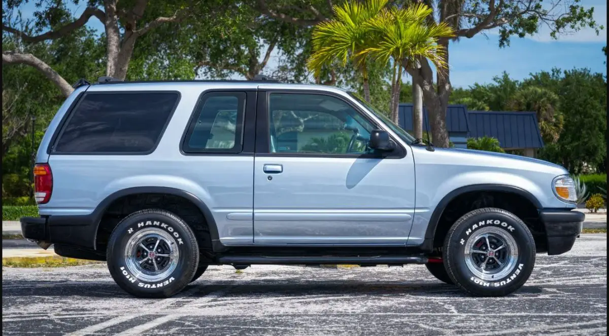

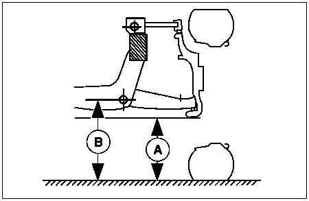

Guys, while we are discussing tires and ride height, I remembered something last night about the build concerning my choices at the time, so I thought I’d share what I learned. To begin, this is the view that is the source of the online hate:
As most of you all know, the factory specs for our cars are arrived at through suspension point measurements from the ground, and taking the difference to arrive at the numbers. This method assures that the geometric arc is exactly where it is supposed to be for ideal handling and tire wear:
When I replaced the entire suspension (including those big torsion bars which had never been on a car, and were thus very stiff initially and had to “break in”), it took awhile for the ride height to settle (a few thousand miles). When I checked things after a few months, I noticed that the suspension stops for the front A-arms were contacting. Sure enough, following the measurement procedure listed above, the recommended geometry was off; so I cranked up the screws on the torsion bar adjustment, and brought it into specs (factory “ride height”).
That was 4 years and around 25,000 miles ago. In that time, this is the tire wear result of holding up a 3500 lb car with somewhere north of 400 horsepower to the drive wheels (5-tire rotation every 6k miles):
I would also bring your attention to the first few seconds of the drive video; notice how easily the steering wheel returns to center, a sure sign that the caster is well within spec:
Those pictures probably go a long way towards explaining why the car was such a pleasure to drive and handled so well, even though there have been some suggestions that the ride height should be lowered; there is no way to do that on our cars without adversely affecting camber gain, bump steer, A-arm to frame contact, and a host of other issues (believe me I tried). You could go with a larger wheel/tire package, but at the factory suspension settings, for every inch that you try to fill up the wheel well, you are adding another inch of ground clearance. The problem we are trying to work around is in the sheet metal and body lines. I hate to be the bearer of bad news, but then again I didn’t design the thing!
At the end of the day, I had to come to the conclusion which part of myself was I going to please: the Russell who sat in the lawn chair and spent hours staring at the car from the side lamenting an Explorer’s gaping fenders, or the Russell who was going to enjoy the car’s ride and handling to it’s full potential while enjoying ultimate grip and tire longevity. I’m glad I made the right decision.
