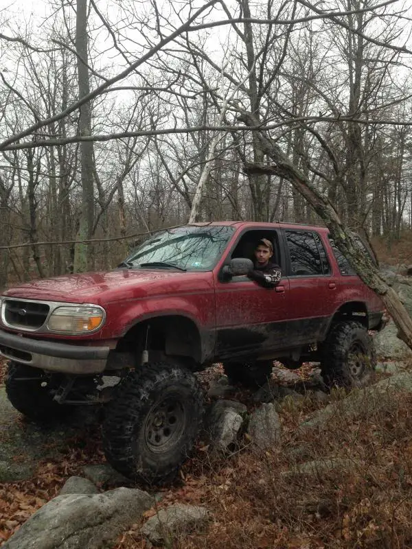

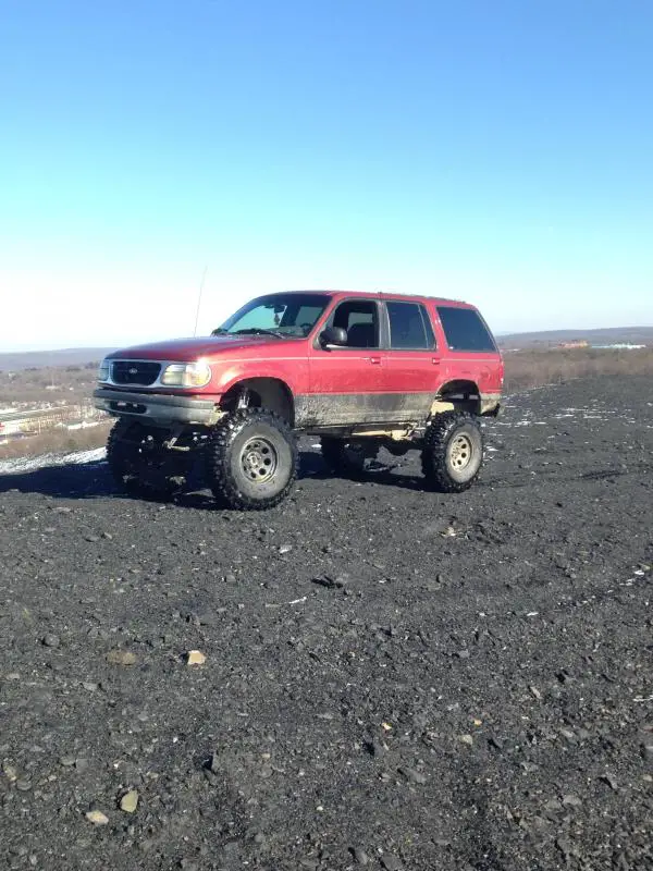

I have a 98 explorer xlt that I bought when I was 15. Shes still running but last year I decided to straight axle it on a budget. Had a dana 44 but couldn't find any parts for it in any local junkyards. So I scrapped it and picked up a dana 30 cheap that is holding up surprisingly well.
Front axle- High pinion Dana 30, 4.10 gears, xj shafts, lockright locker
Rear axle- 31 spline 8.8, 4.10 gears, welded
Suspension- Front is SOA with waggy springs, AAL, shackles, rear is SOA with AAL and shackles, skyjacker nitros all around
3 inch body lift
2 inch wheel spacers
4.0 OHV, automatic, bw1354 manual case
Extended brakelines
Steering- 94 explorer box, custom shaft, 1/4" steel plates on both sides of the frame, sleeved, grade 8 bolts, v8 grand cherokee steering, custom wj track bar, 3/16" box tube running from drivers side to passenger side frame for support.
f350 shock towers
38.5-11-16 boggers (got a steal on these)
crager soft 8s
v8 grand cherokee drive shaft
extended rear drive shaft

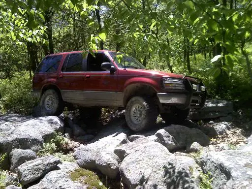

ill take pics when I have time, heres one from 2011 on rattlers tail (black 2) at paragon with 32s

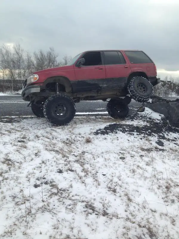

Sploders got a winch and a bumper. Gunna need a tranny soon and I'm building a doubler. More pics to come.
