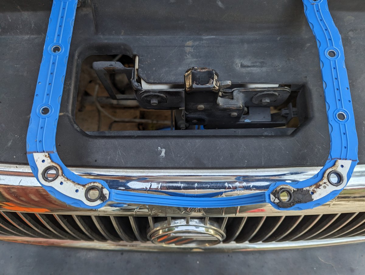

I'd clean and reuse, real clean with black rtv on the joints
If it didn't look like that had already been done once before, I probably would. At this point there isn't much gasket left, it was a lot of rtv already and I sliced all that pretty bad with the razor. I agree that would've been preferable to reuse if I hadn't butchered it yesterday. At least now I know for next time!
If the pan gasket is metal reinforced, I would think that the Dremel type tool would be best to cut the pan gasket. Without going back and re-reading the thread, I know that someone said cut 90% of the way through it the finish with a razor or utility knife.
I'm close to doing the same thing with my timing cover and have been contemplating what to do during the timing cover installation. The cover is going to have to be forced down against the replacement piece of pan gasket, crank seal properly aligned, dowels lined up and get all of this back on to the block without smearing wet RTV all over everything. All of you 5.0 pros can weigh in and I haven't done this procedure in many years but something keeps telling me that I should loosen and or remove all of the oil pan bolts except the very back two but leave them loose so that the front of the oil pan can be dropped down a half of an inch or more to get the timing cover to go on straight and square with the first try. Although it is a bit time consuming and inconvenient, to do this, it should make the timing cover replacement go faster and smoother. I may be overthinking it, but I'm strongly considering loosening up the pan, If it will come a loose clean.
I did end up using a Dremel wheel on a die grinder. One side came out clean, but the other I nicked the pan slightly. I don't think it's anything the RTV can't fill.
I'm only planning to put RTV at the bottom corners and possibly the corners on either side of the crankshaft U. Hopefully that doesn't make a huge mess. The dowels stock into the cover more than the block, so I think I put dowels and TC cover gasket on the cover, then push all of that down onto the pan gasket chunk and RTV.
If you loosen the whole pan, that's going to open up a gap that's very hard to clean. Not saying it can't be done, but sounds miserable and like an opportunity to create new leak paths.

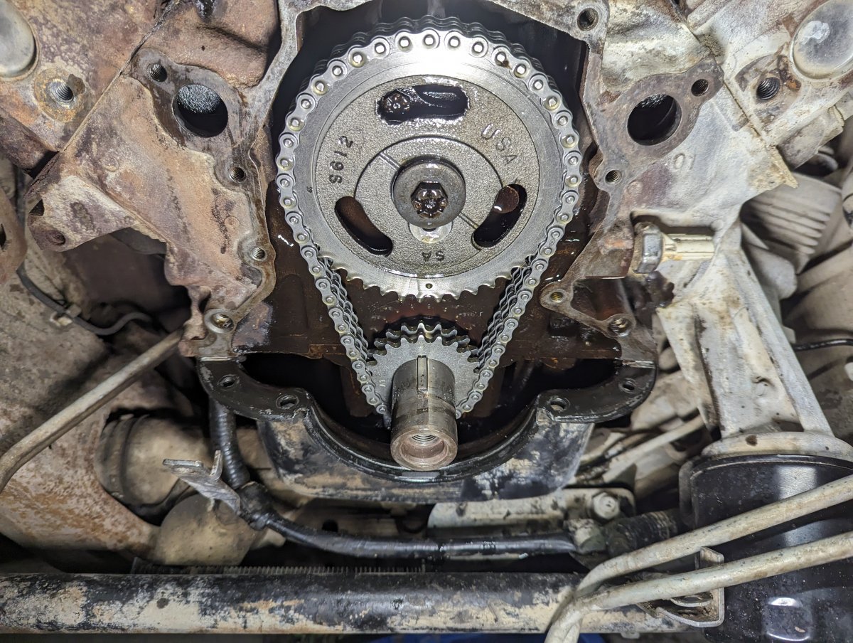

Got my new timing set on last night!
Couldn't find my gasket maker, so I need to pick up a new tube today. I block sanded all the machined surfaces of the cover and cleaned all the tapped treads and fasteners too. A quick wipe with acetone and the cover will be ready to reinstall.

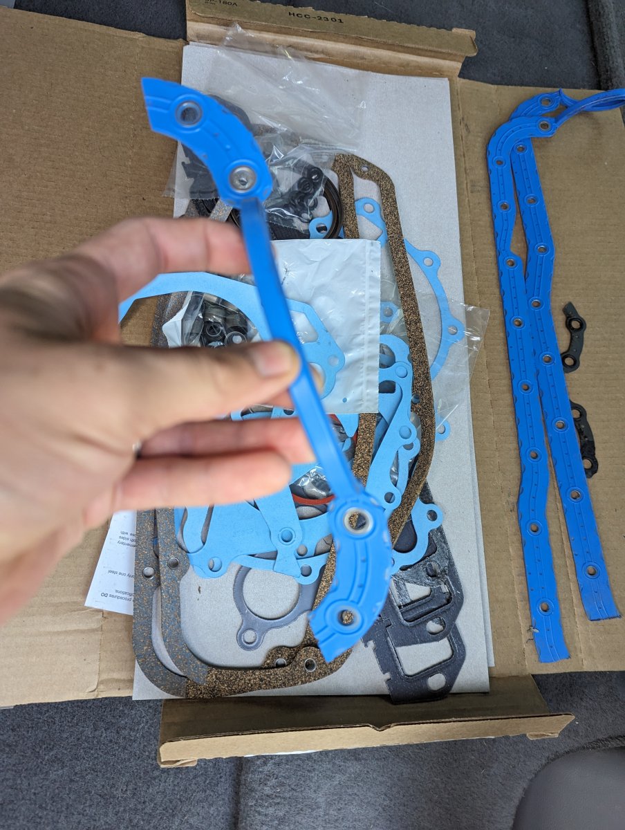

@97Sandbox Where is the blue oil pan gasket from?
It's from the Felpro full gasket kit from Rock auto which came recommend to me by 410. I cracked open the set yesterday and everything looks like good quality.
Here's the trimmed down section I'll use under the TC:
@97Sandbox I see now. The metal pieces that I see are from the old gasket laying on top of the new one to mark where to cut. I wondered why the new gasket was bare at the TC edge.

Yes, I was just showing how I cut the new gasket. Steel pieces were what I cut off the old one.

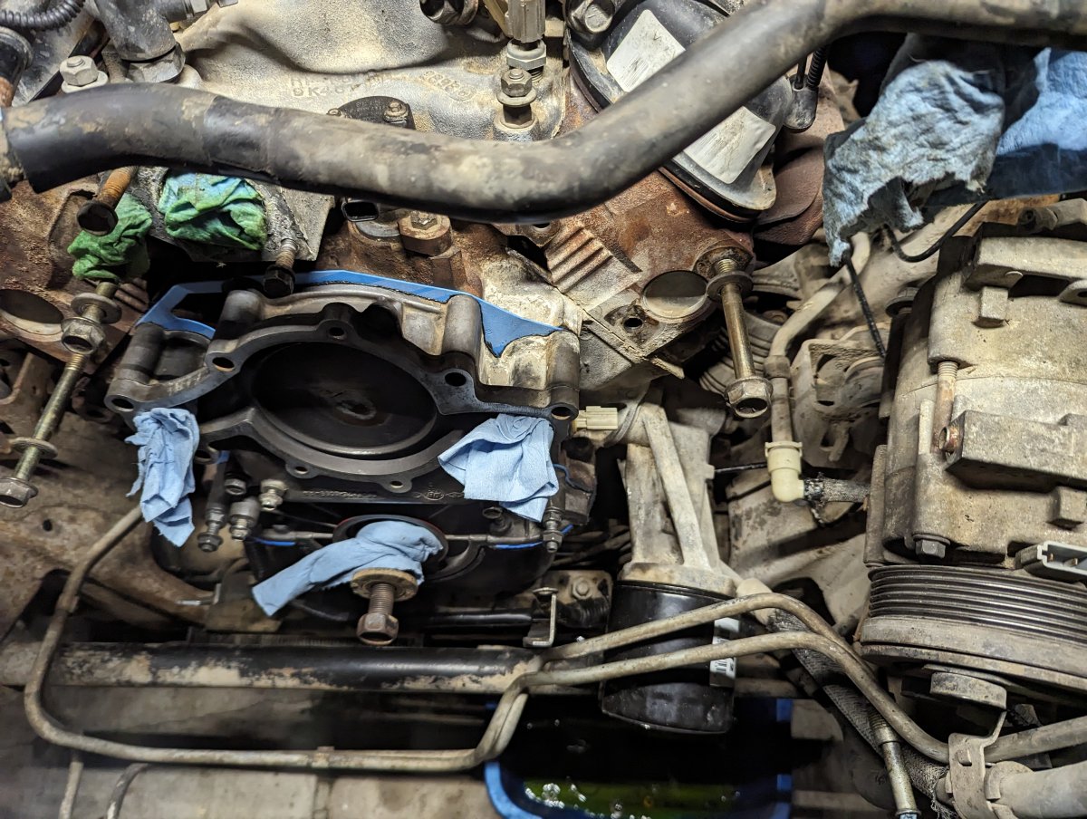

Timing cover is back on! Balancer too for that matter.

I'm waiting to get my water pump fasteners re-plated before putting the new pump on, so I started thinking about what's next on the Mounty. I decided to start removing an exhaust manifold because I expected I'd need the torch and wouldn't want to put too much heat into the head after the valve cover and intake manifold gaskets are replaced. Unfortunately, the MAP torch and penetrant were not enough -- the first stud snapped right off. I'm not sure if I have the ambition to keep trying the other fasteners, or just leave things as they are and mess with the manifolds when the engine is out someday. The problem with that is there was already a noticeable exhaust leak coming from the right manifold and I don't think the missing nut will help close any gaps.
Not wanting to deal with the exhaust, I moved onto the lower intake manifold. After some busted knuckles, I got the heater hoses off and didn't have any trouble pulling the fuel rails. Then it came time to remove the intake manifold studs and it was a repeat of the exhaust manifold. I was able to slowly break loose the front two studs, but I could feel they weren't happy. One I was able to get out, but the other snapped off -- I wonder if the whole time it felt like the stud was turning, it was actually yielding. Then the rear stud broke off too. I wasn't able to get good enough access to try the bolt on the rear right corner (socket kept slipping off).
Am I missing something, or just unlucky? At this point, I'm almost thinking I just go and break all the fasteners so I can pull off the exhaust/intake manifolds and start welding nuts to what's left sticking out. That sounds like a very unpleasant time though haha.

You need a torch, map gas maybe not enough here
The stupid lower intake
Bolts are open to atmosphere at their tips, the two front most and the two rear most, this causes mass corrosion and they fuse themselves to the engine block. A torch with more heat is the only way to get them out
The good news here is with the intake off the studs will be 1” long for you to work with
Similar with exhaust manifold, once the manifold is removed the studs are usually 1/2” long or so and you can get them with a torch/welder/ vise grips
I figured that might be the case. I don't have an acetylene torch setup currently and I'd love to work with what I have if I can. Seeing how corroded the stuck bolts/studs are, I don't think it'd be smart to reuse them anyway -- do you think the heat from welding nuts on has a decent chance of shocking rusted threads loose, or is acetylene the only way to go?
