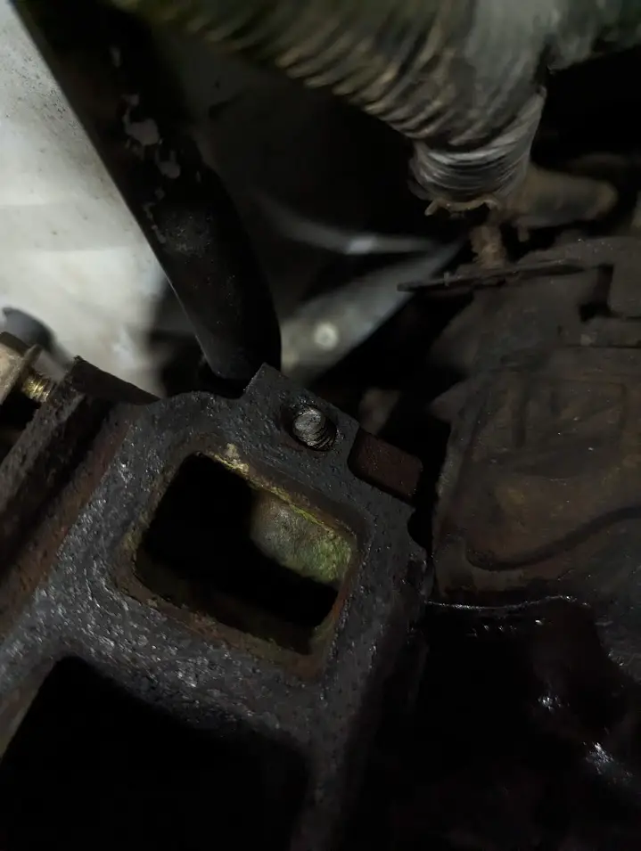

Pulling off the lower intake was rough. I tried everything I could come up with to lift it off. I was eventually able to work it free from the rear left bolt, but the rear right snapped off. It's completely fused to the manifold. That means I have two decent chunks of bolt sticking out to weld to and one broken bolt that will have to be drilled/extracted -- of course that's the one by the firewall and trans dipstick that I can't get a straight shot at with the drill.
Does it make more sense to just pull the heads at this point? I don't see how else I'll stand a chance at getting that bolt out.

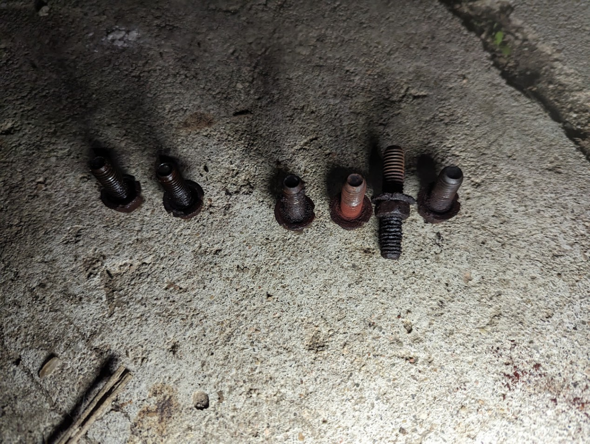

For the exhaust manifold bolts, tap your wrench with a hammer just till they move, then tap it back, then repeat going further each time until you are confident they are coming out good. Sounds time consuming but compared to the alternative it's not.
I'll give that technique a try. The one stud I already broke snapped with very little force though, so I'm not holding my breath the others will come easily.

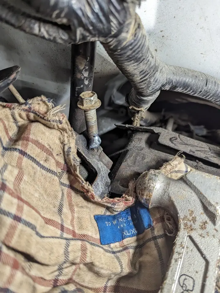

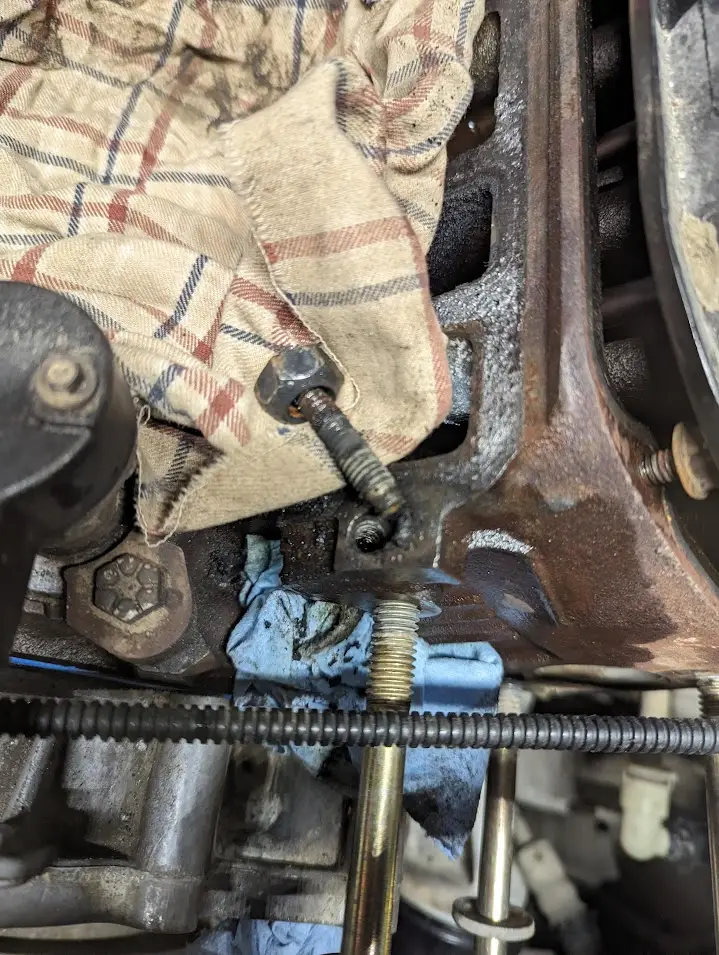

Had a productive night! I welded nuts onto the two studs that had some length sticking out of the head. The back one snapped off, but the front one came out.
I welded bolts to what's left on the back two broken studs and will try them tonight.
Also shoutout to @Turdle for the exhaust manifold bolt method. I'm six for six so far (need to take off the heat shield to get the last bolt on the right head).

I hope the bolt welding technique pans out then I won't have to remove the heads or heater box!
