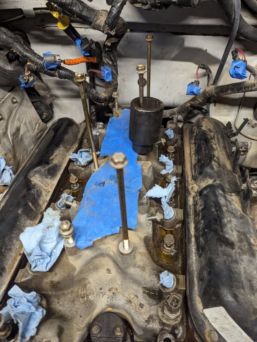

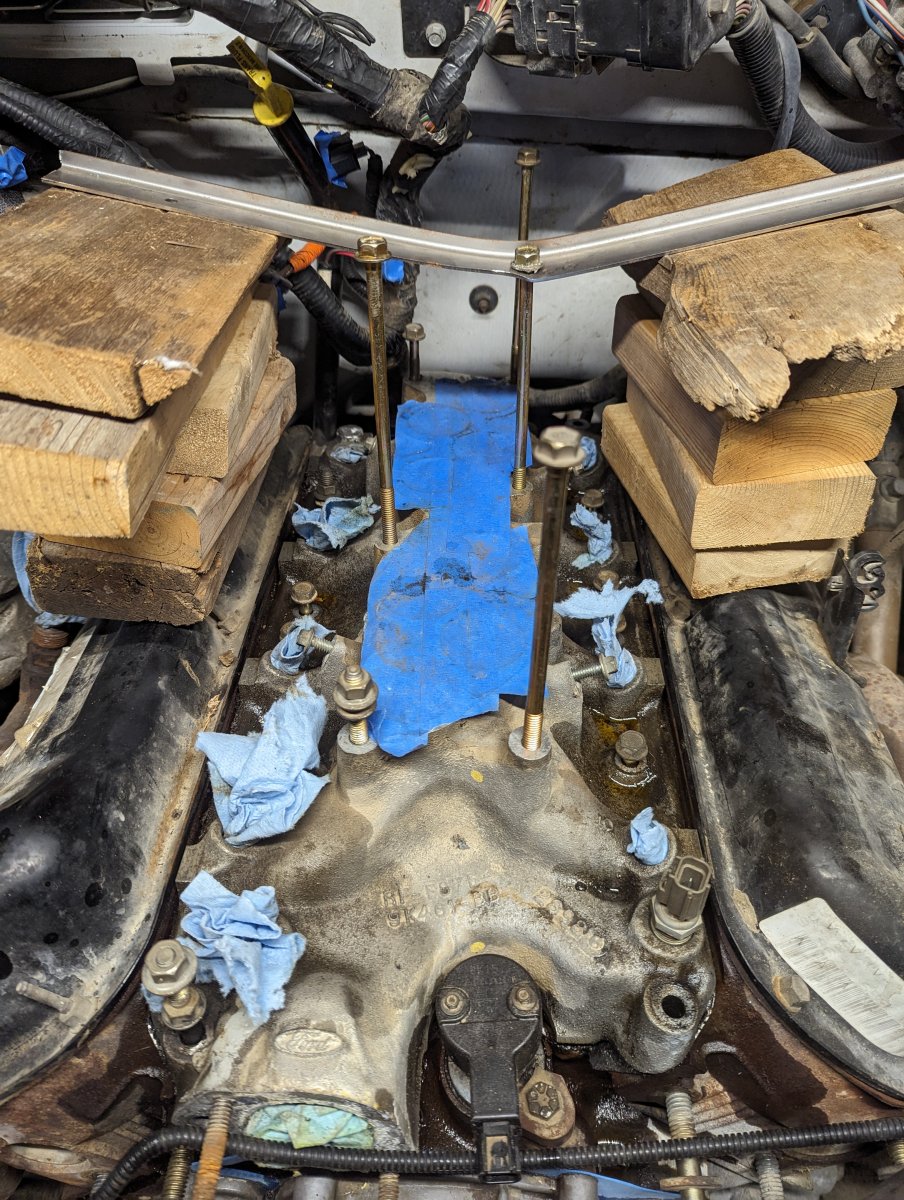

I really wish I could! Even if I bought a hoist, an engine stand, and a more serious torch setup, I don't have a place to keep an engine out of the weather while I work on it. Heading into the winter, this project is looking like an increasingly bad idea. I'm getting pretty close to admitting defeat and starting over in the spring.Pull engine for proper repairs![]()
Is there any way to get to the threads on the rear lower intake bolts? I could definitely try that if I grind the bolt head off and pull the manifold.Dribble a little brake fluid into the threads of the stuck bolt, and let it sit a while.
I absolutely will need a new rear main, but I intended to do that when the trans would come out for the manual swap. I'm not arguing that pulling the engine isn't the best long-term path, it's just not really in the cards for me right now.You might want a new rear main seal , so that might be best in the long run.
I was actually using a Dremel cutoff wheel on my die grinder (I have an adapter collet so I can use Dremel size shanks instead of the normal 1/4" ones). If the angle grinder doesn't have any good access, I'll want to order a pack of the Dremel wheels -- their twist lock design is nice.Nope, not torch. Is there just a little of the bolt head remaining? Maybe use a Dremel type tool with a miniature cut wheel?
Yeah, I wish I'd left the lower intake alone. But the Mounty had lean codes for both cylinder banks, so replacing upper and lower intake gaskets seemed like the right thing to do. The bolts I'm struggling with go into the iron block still, not the aluminum intake manifold. I'm sure the steel bolt shanks are somewhat corroded to the manifold, but I think the bigger issue for me is how corroded the threads are in the block, which wouldn't be a galvanic corrosion situation (not by much anyway).I've been on the fence about removing my lower intake while I'm doing the other things. I think I will let mine be until later when the engine is out. I don't ever remember having trouble with these 4 bolts when I was working on old 289s and 302s with cast iron intakes. It must be an aluminum intake issue. The dissimilar metals oxidizing together.
The head design allows exposure to end of bolts, in the cast iron head.Nope, not torch. Is there just a little of the bolt head remaining? Maybe use a Dremel type tool with a miniature cut wheel?
I just saw in your old posts the intake bolt holes go completely through the head? I have to start spraying the underside too then. At least for the front stud I broke.The head design allows exposure to end of bolts, in the cast iron head.

Thanks Mark. I will refer to the chart. Since I had a little time and a dremmel tool with sanding drum I used Don's idea and got this. By golly I think the nut is a thread lower now. Compare to post 495 That should help a little. :Dwww.explorerforum.com
Sounds good. New approach: grind off the bolt head, then start the drilling/extracting/welding.Once the intake is off the repair gets much easier yes
They can be center punched drilled and tapped
