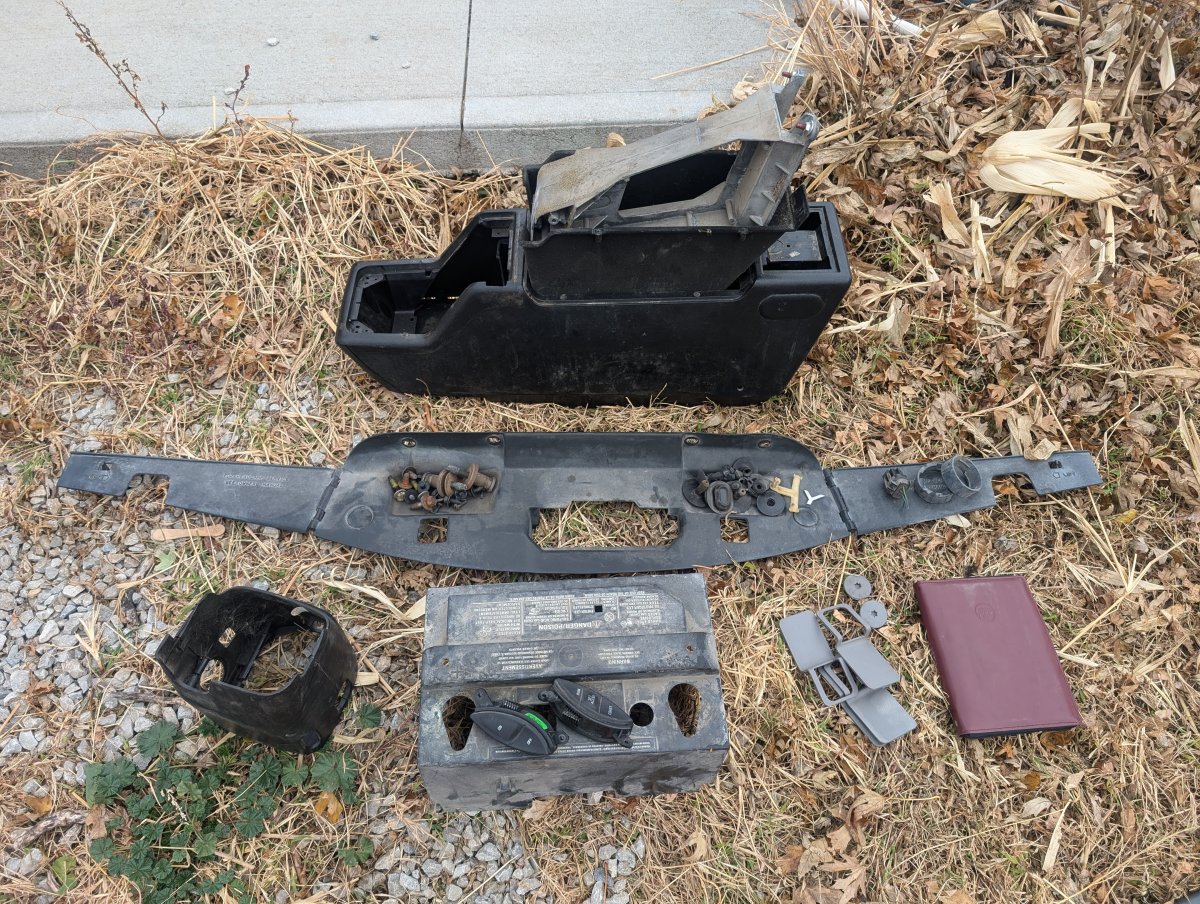

Got a good salvage yard haul today.
  • Black Ranger Console (no armrest, sadly)
  • Cruise buttons
  • 99 Mounty manual
  • Battery heat shield (these are always missing)
  • Manual with tilt steering column cover (because I broke a couple tabs on mine)
  • Grille/headlight cover with socket trays
  • Lots of misc hardware I needed
And it only cost $25!
I'm excited to get it all cleaned up and installed.
Both cruise buttons light up woohoo! The last OEM set I found was burned out on the on/off side and the last aftermarket set I found was 95-97 blue, not 98+ green. The latter set was in an '01 Sport oddly enough -- I guess the color mismatch didn't bother them, but it does me.
Unfortunately, the socket tray grille cover does not work with the later Mounty grille -- oh well.

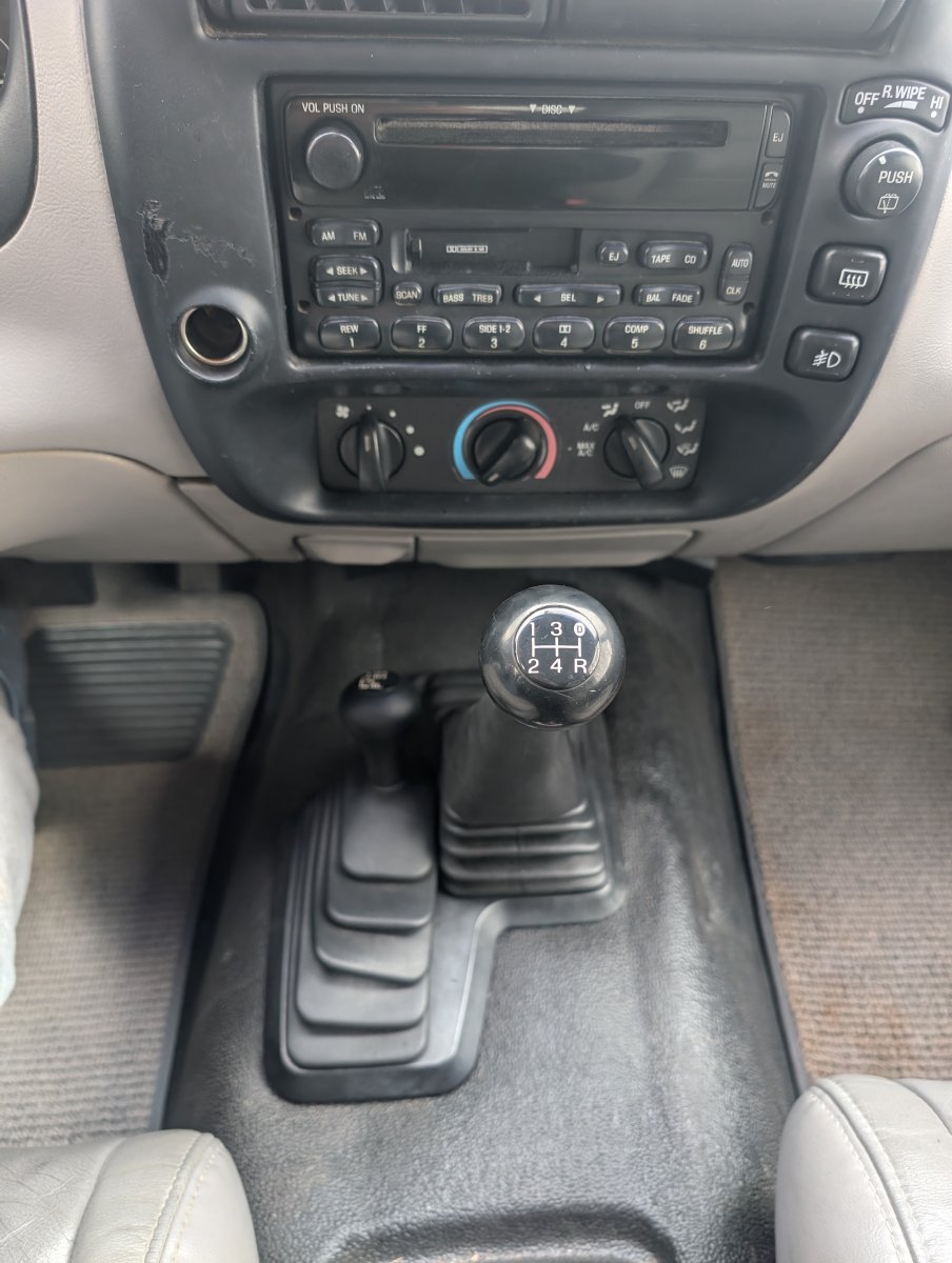

I fixed a few of the broken areas on the console and cleaned it up. I really wish it had the armrest and lid, but I'm thinking I may just put on a grey armrest and lid whenever I find them. Or I may just switch it out for a grey console at that point. Either way, I'm glad to have the console, I've never seen a black one before and it'll go well with the trac flooring.

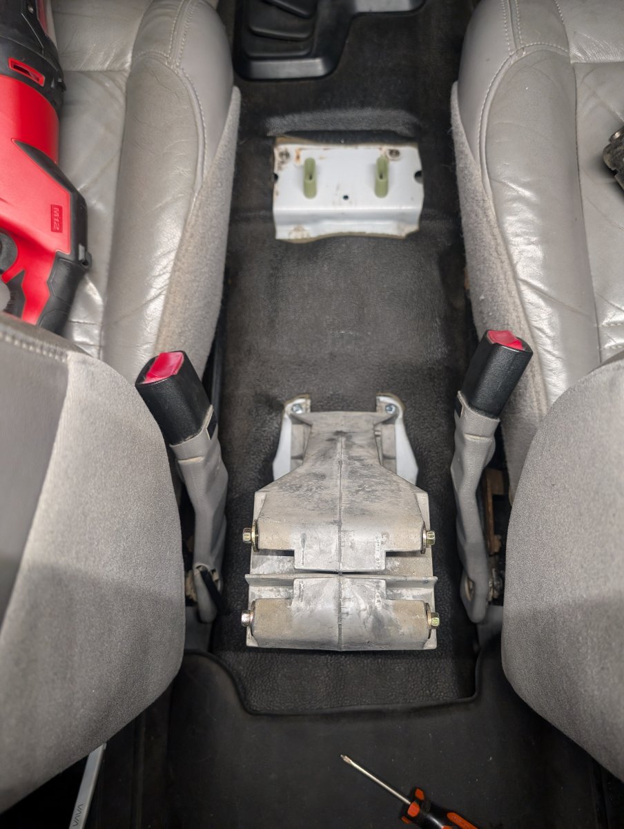

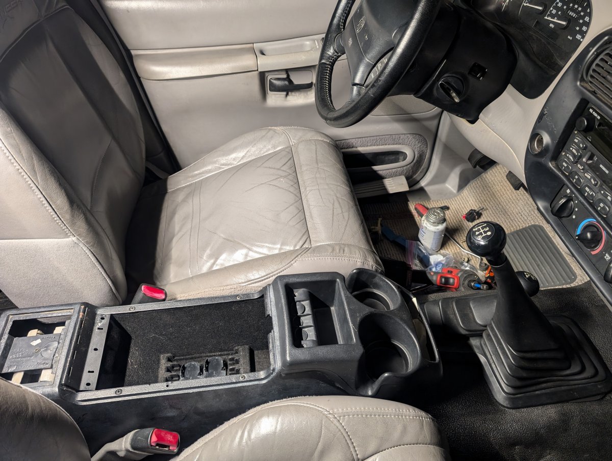

I started the process of getting the Mounty ready for the short console. Installed the two plastic clips in front, then drilled out the rivets and pulled off the rear bracket for the full length console. Also drilled holes for rivnuts.
Got the rivnuts in. All I have on hand is standard rivnuts, so these are 1/4" instead of the OEM M6. Once everything is in, though, nobody will be able to tell it's not factory. I also put some plugs (former Ex front door bumper stops) to keep anything from sneaking in the old rivet holes.
Main support bolted in.
The black console looks good with a black first gen cupholder.

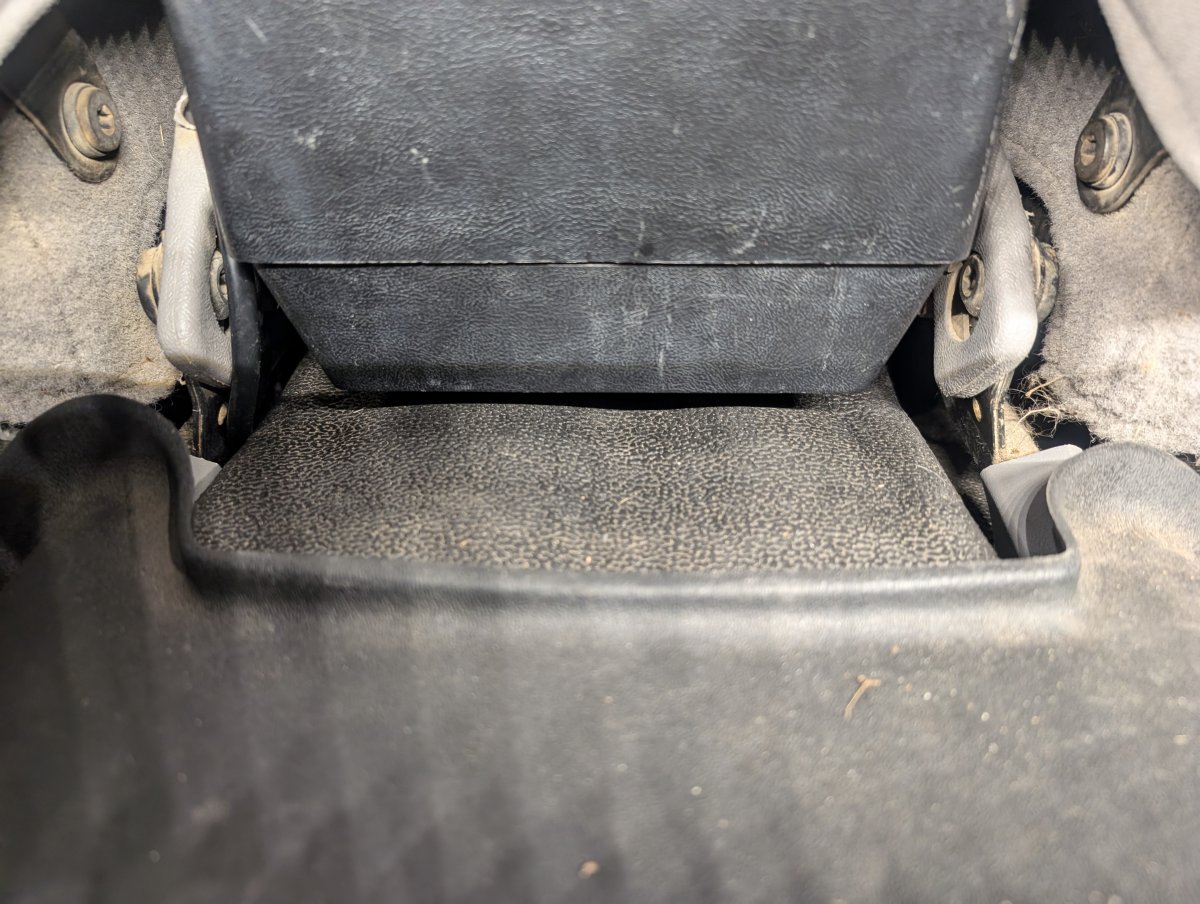

I guess the floor pan of a Ranger must be a little different from an Ex -- the console is floating slightly at the back:
That explains why the lower plastic piece said "RANGER SUPERCAB" so specifically haha.

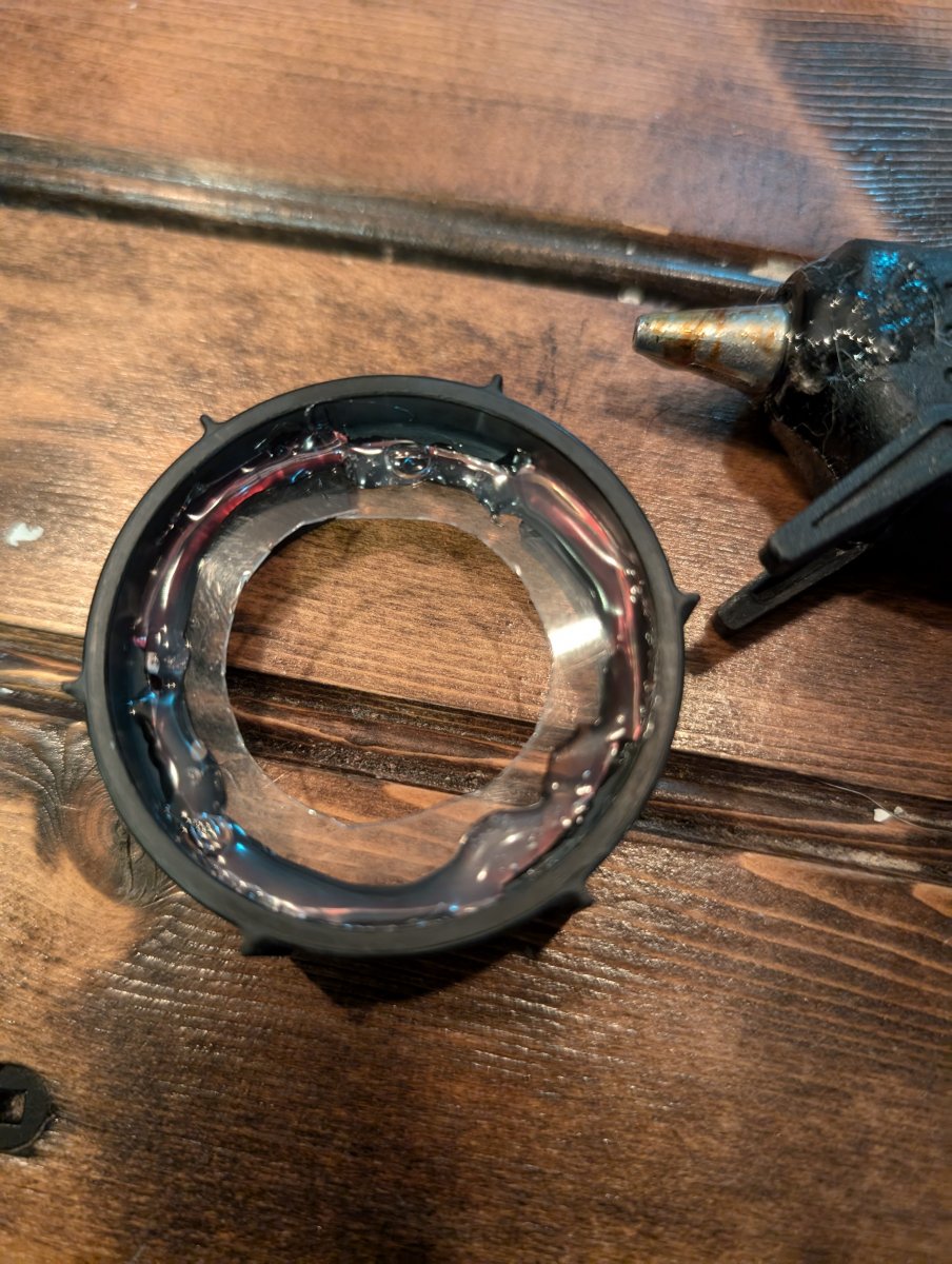

I also had a detour trying to install a headlight bulb lock ring that I picked up. I noticed when I replaced my hood cable that one bulb was siliconed in and the lock ring was missing. I tried an Explorer one, but it was too small for the Mounty headlight. I grabbed two Mounty rings yesterday, but didn't notice one was missing a tab and the other was missing all three. When I went to install the two-tab ring, both tabs broke off. I guess that plastic is too brittle now.
My solution was to cut a thin plastic "washer" and glue it in place against what's left of the broken tabs.
It's holding the bulb in fine for now, but I have a feeling the hot glue and PET plastic won't withstand the summer heat. We'll see.

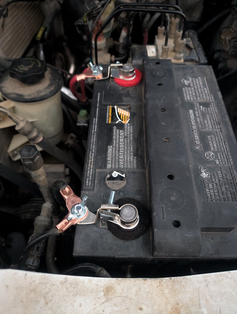

I forgot to post an update, I got a battery terminal setup I'm content with. Sort of halfway between OEM and the marine terminal idea.
