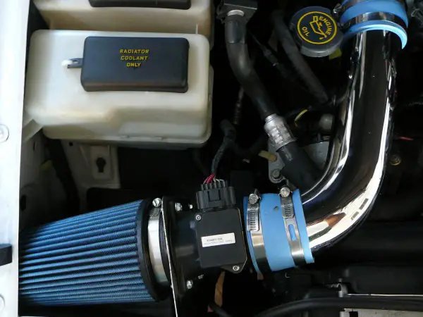

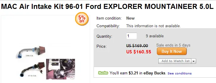

i see the cold air intake there, but is it really "cold aid intake"? or does it draw in the underhood hot engine air as well? has any one ever put a snorkel on a 94-2001 5.0 exp/ mounty?
just asking! im sure that intake is worlds better than stock! lol
and I think i will end up with one of those bad boys my self.
unless some one can point me to a snorkel!

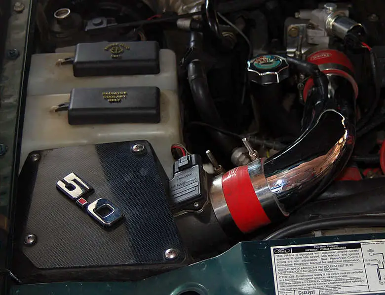

celly, i would like to see if you would upload some pics of how you have yours set up. i want to mod my 70mm tb from my 1986 5.0 stang, and would like to see what every one else is running, i'd like to see pics from any one willing to upload some pics of intake/tb/coldair intakes ect. id like to see how far i can use my 5.0 stang parts. LOL. thanks for the help every one!
This is an old pic. The intake tube was since powdercoated and the faux carbon cover on the box was sanded down and painted with a colour similar to the intake tube.
Components
-Box from Volant intake setup for SOHC V6.
-Amsoil Ea filter.
-C&L MAF body (since powdercoated), stock Ford electronics.
-silicone couplers and upgraded clamps (completely overbuilt, cosmetic benefits only)
-intake tube from MAC setup for the 5.0, cut down an inch or two to fit the setup.

Tube is from a MAC 5.0 kit for the Explorer.

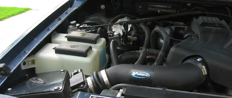

Volant doesn't sell the box as a standalone product. I originally had a SOHC V6 Explorer when I got the intake and just modded it to fit the 5.0. Model # is 19640. Retail on these kits is around $275 so that's a lot of coin to spend on a kit that won't fit on the 5.0 (at least the intake tube doesn't). I paid a lot less than retail from a guy on EF who had a few, new in box several years ago.
Obviously the "5.0" badge is my touch. This is how the setup looked in stock form on the V6.
