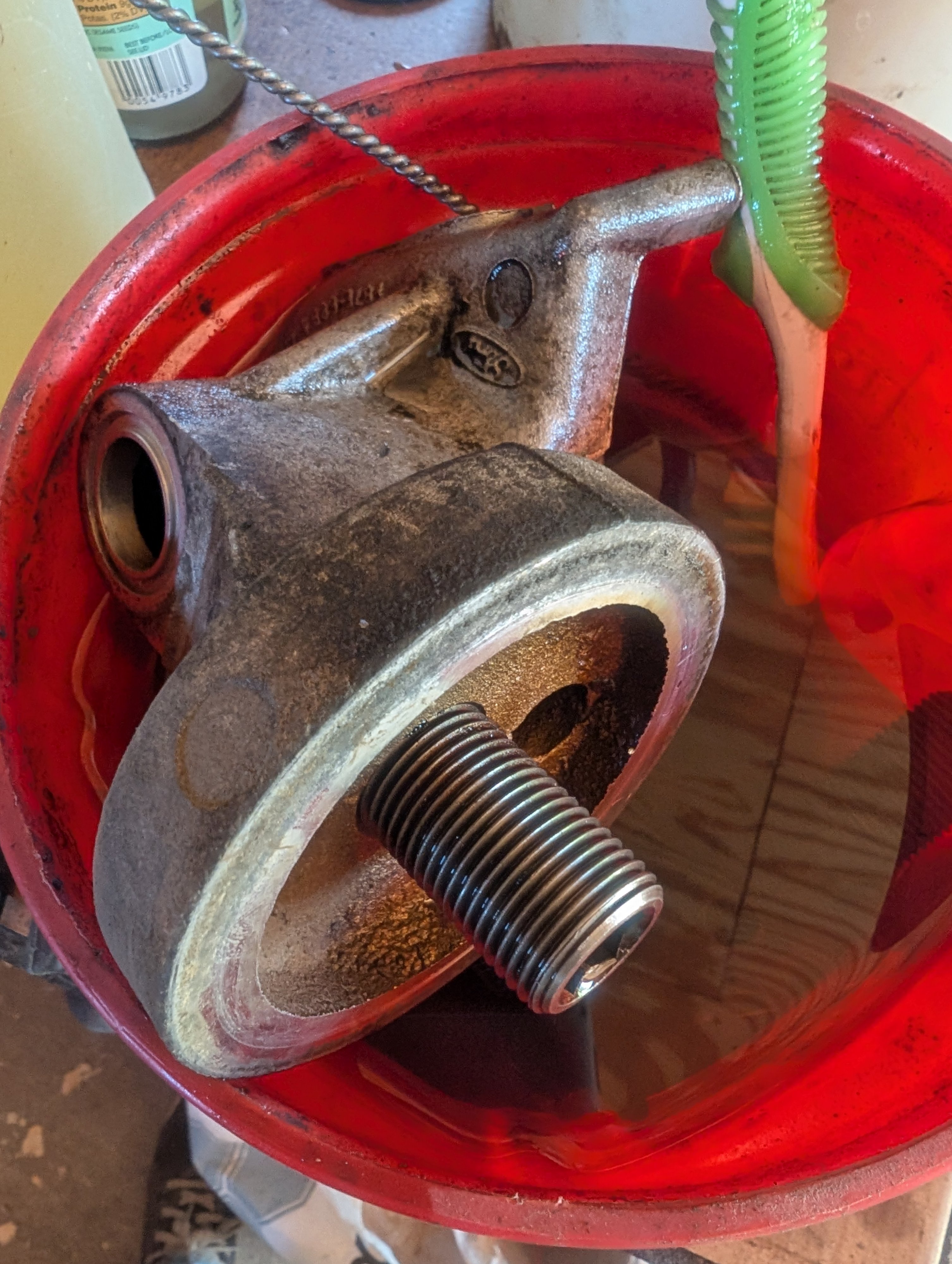

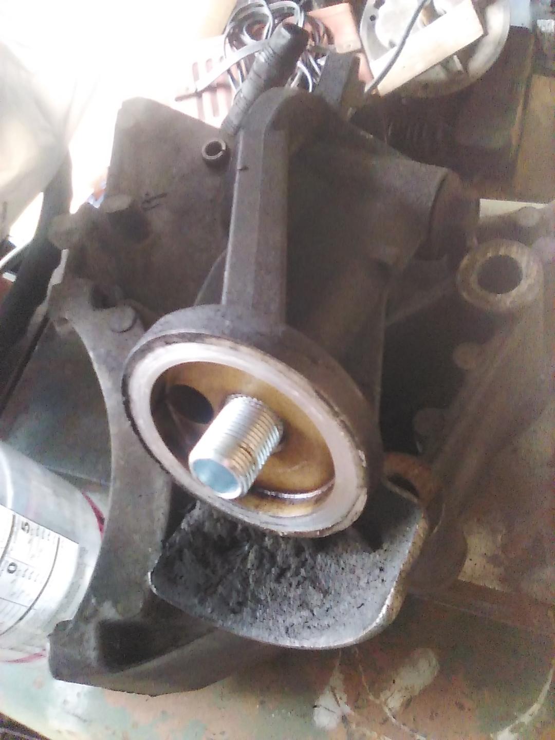

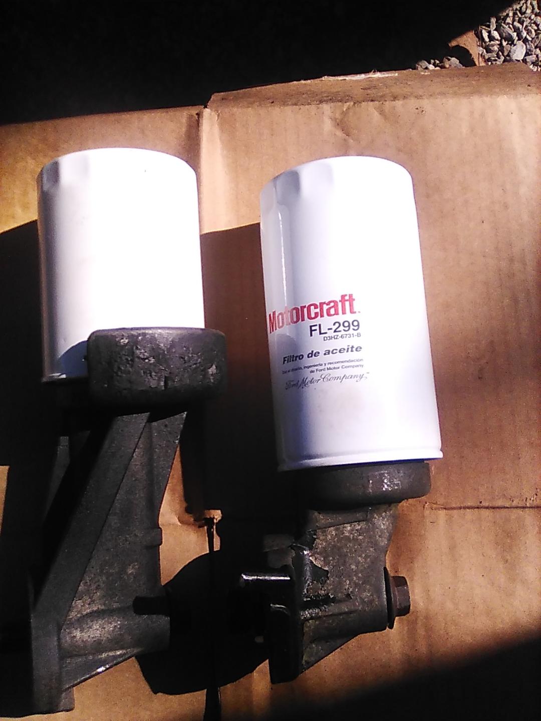

And the reason I'm posting in this thread, is I finally figured out which OEM oil filter adapter is the one we want to run an FL1A off an early ('96-'98.5) filter stalk!
You need the threaded piece from a 3.0 Vulcan. Probably other applications, but I can confirm the 3.0 piece works and they're easy to get to in a Ranger engine bay. I tried to take one from a 4.0 OHV, but they don't have the same internal (7/16" or 11mm?) hex so there's no good way to spin them off. The adapter on the 4.0 SOHC is larger, and won't thread into the 5.0 stalk. So if you don't want to buy a new one, grab one off a 3.0 Ranger next time you're in a salvage yard.
