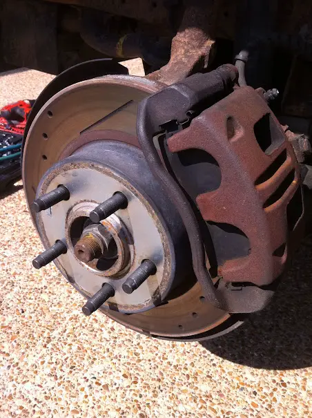

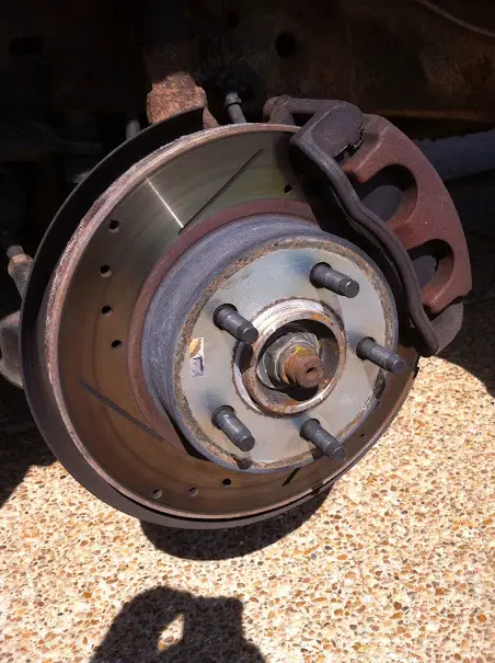

A couple pictures of my rotors/brakes and such while I had my wheels off... My eBay specials, lol, zinc plated, cross drilled and slotted w/ceramic pads.. paid $189 shipped.. Put them on last year and they still look pretty much new and stopping is better than I could ever imagine in the truck.
