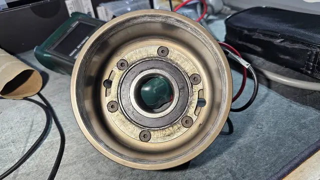

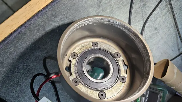

Ok... had some time and dug in some more... pulled the idler shroud or whatever it's called off of the electric water pump and noticed some excessive wear around the inside outer edge. I recall there being a little in this same place back when I replaced the bushing but there was a lot more I noticed this time:
Looking closer I noticed a piece missing from the plate that locks in the bearing:
I also noticed some play in the bearing between the shroud and locking plate.. I could wobble it a bit in place which is not good.
