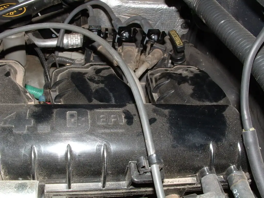

I know it looks like a problem but it is really simple to fish the wires through. All I needed was a set of needle nose pliers. Also on the OHV at least, it is very easy to get to the spark plugs from the top. No need to go through the wheel well like everybody claims is the only way to do it.

I do have an OHV and I did replace the spark plugs and wires about 2 weeks ago. So yes I do know that it can easily be done the correct way! You do not have to remove the plenum, there is room to fish them through. I used just a pair of needle nose pliers. The only thing I did a little different was change the route of one of the wires through the plenum cause it made it easier. (I believe it was the number 5 wire, I may be wrong. It is the longer one)
The only other way to run the wires would be across the top of the plenum which is not the most ideal situation. The other option would be to replace the ohv wires with sohc wires, I believe they are longer and can run around the back of the motor. This second option would work and could be done correctly. My opinion is as we all know our explorers are very picky about there electrical system. They seem to only work well with the factory set up. Why would you want to change that!

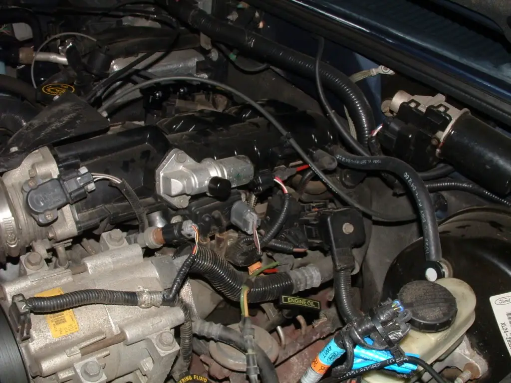

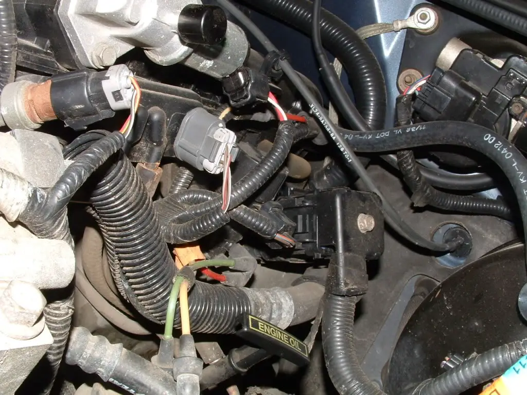

I have changed the wires on my 96 EB 4.0 OHV and on the driver's side, I disconnected the connecters on the IAC, TPS and anything else in the way. When you get the wires changed, the harness will fall back into place so you can figure out where everything goes.

I believe it may have been to keep them in a safe and protected area away from heat and moving parts. It makes the most sense to put them where they will be protected.
Again it is not very hard to put them back the same way. They will fit and there is plenty of room.

Driver's side is a bit annoying but it should not be that difficult. It's easier if you take off one of the sensors on the side of the manifold (2 screws and one connector). Also it's easier if you fish the wire in from the top-down (starting at the coil side), since the coil side plug is larger and more difficult to route through the opening.
Removing the sensor would've been a good idea. Agree with fishing them down from the top, that's what I did. Wiped plug clean once through and added the dialectic grease.
You guys just use a 10mm and unhook the big 42 pin wiring plug, then a flathead screwdriver to release the female plug from its bracket.
Now you can fish spark plug wires under the intake until your heart is content!
