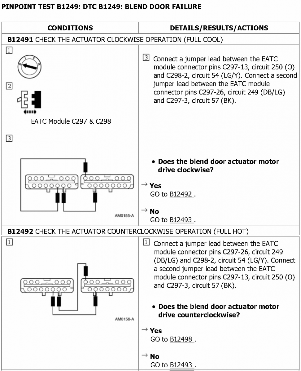

This is interesting. Pulled the glove box. What you see is a blend door actuator gear only zipped tied into full heat position. No blend door actuator. This explains why on 60F vent setting she blows only hot air. Good news is all the other system items prolly needed to be done anyway aside from the new heater control valve. The bad news is that when I connect the new blend door actuator to the connector and adjust the temp up and down the new actuator motor adjustor gear does not move.
Ive noticed some posts where on startup the ACT unit displays an 888 briefly before going off. Is it likely that the ATC unit needs a reset before installing the the new actuator or there is some other electrical gremlin on the other end of the actuator connector?
Another option is running a manual level on the blend door. Anyone have any suggestions on each?

Rather than reading the whole workshop manual section on it, I'll just attach that and an excerpt:
To enter the self-test, press the OFF and FLOOR buttons simultaneously and then press the
AUTOMATIC button within two seconds. The display will show a pulse tracer going around the
center of the display window. The test may run as long as 30 seconds. Record all DTCs displayed.
If any DTCs appear during the self-test, follow the diagnostics procedure given under ACTION for
each DTC given.
If a condition exists but no DTCs appear during the self-test, refer to the Symptom Chart
Condition: The EATC System Is Inoperative, Intermittent or Improper Operation.

Thanks for the snippet. Ill dig into the diagnostic tomorrow.
